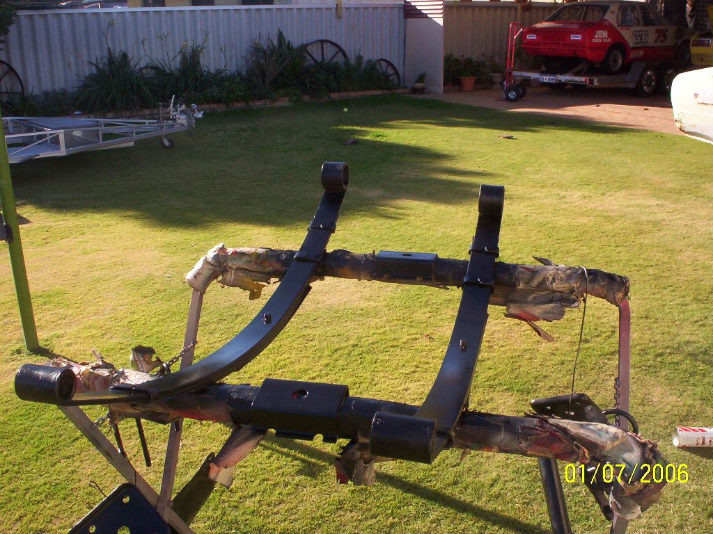

lappy Posted June 26, 2006 Author Report Posted June 26, 2006 (edited) you have to undo the tailshaft bolts ( 4 12mm nuts) the 8 U bolts ( 8x 14mm nuts) i drop the spring hangers down just to make it easy ( 8x 14mm nuts) and the brake line ( 1 10mm screw thingo and this bit of metal that holds the brake line in which you just use some visegrips to pull out) and the hand brake cables (undo 4x10 mm bolts which tension the line and the flick these rubber things that hold the line on the car or when you don't need the handbrake cables such as speedway just hacksaw or bolt cutters through the hand brake cables) sounds like alot but about 15-20 mins work max i have changed a fair few diffs trying to get the right ratio for speedway also see the first pic i posted on saturday Lappy Edited June 26, 2006 by lappy Quote

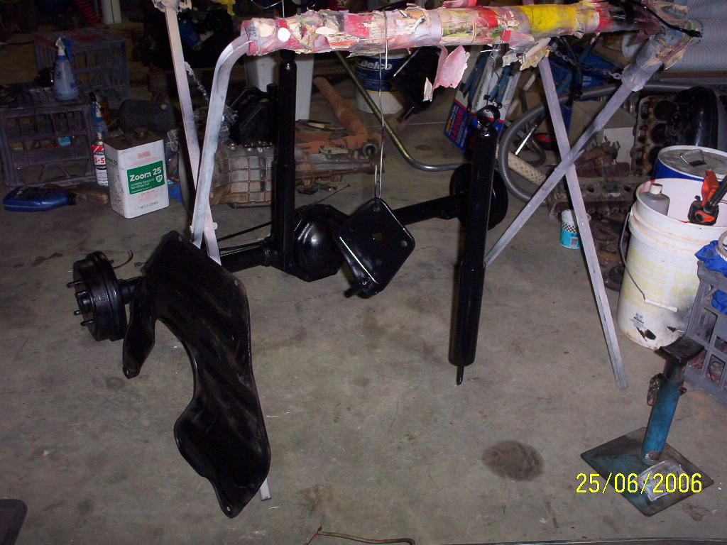

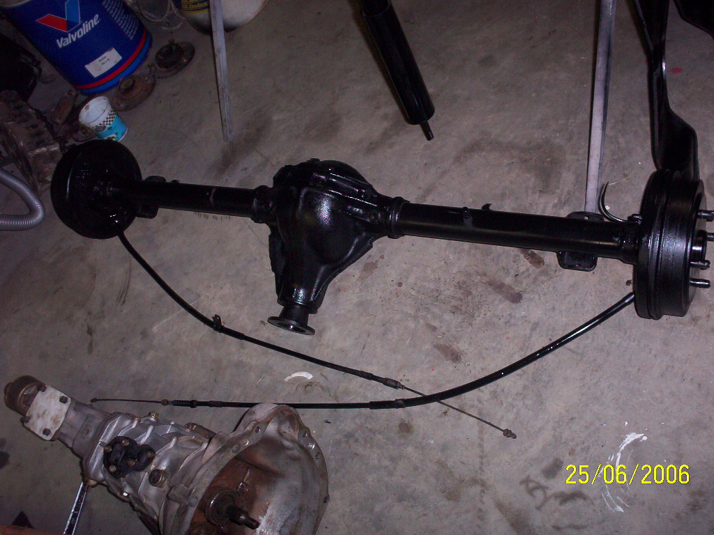

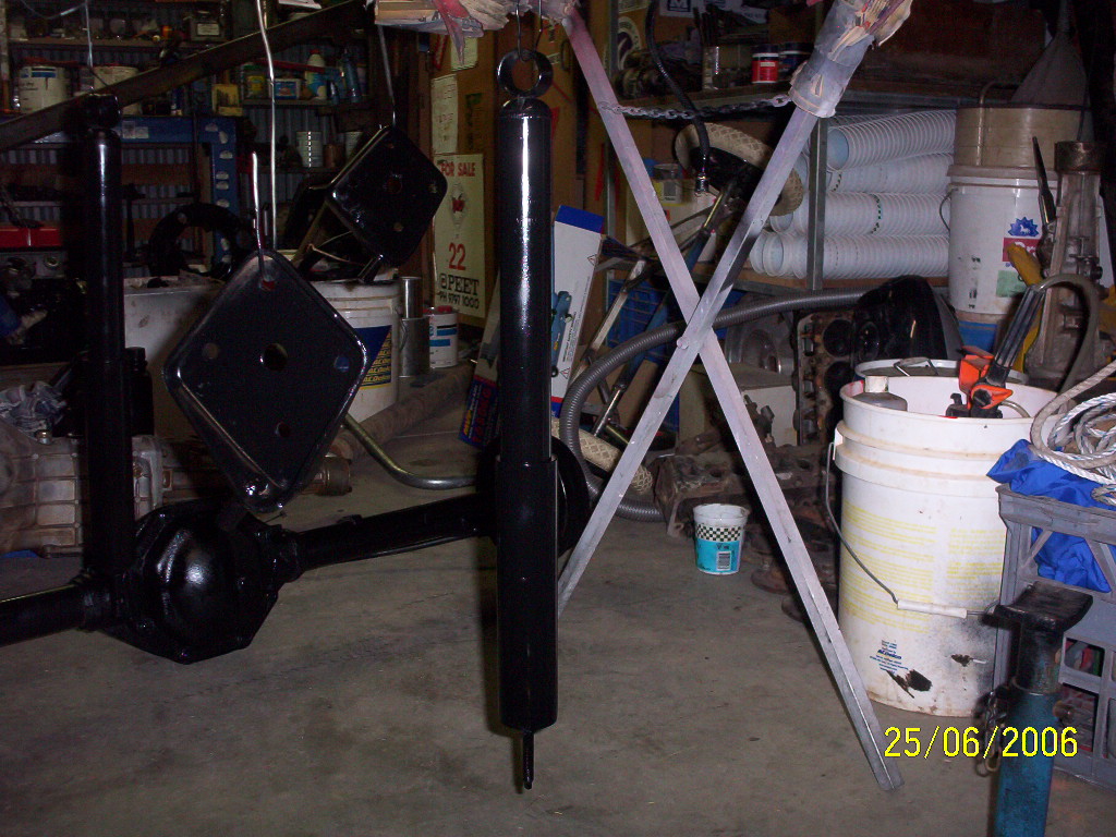

lappy Posted June 29, 2006 Author Report Posted June 29, 2006 more update pics from the weekend more work to happen this weekend then after next week i have 2 weeks of holidays so tune in for some more updates Lappy Quote

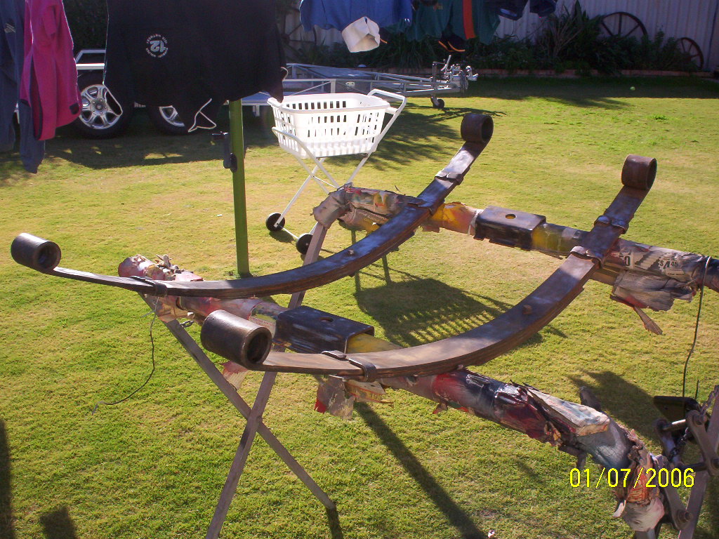

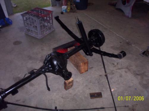

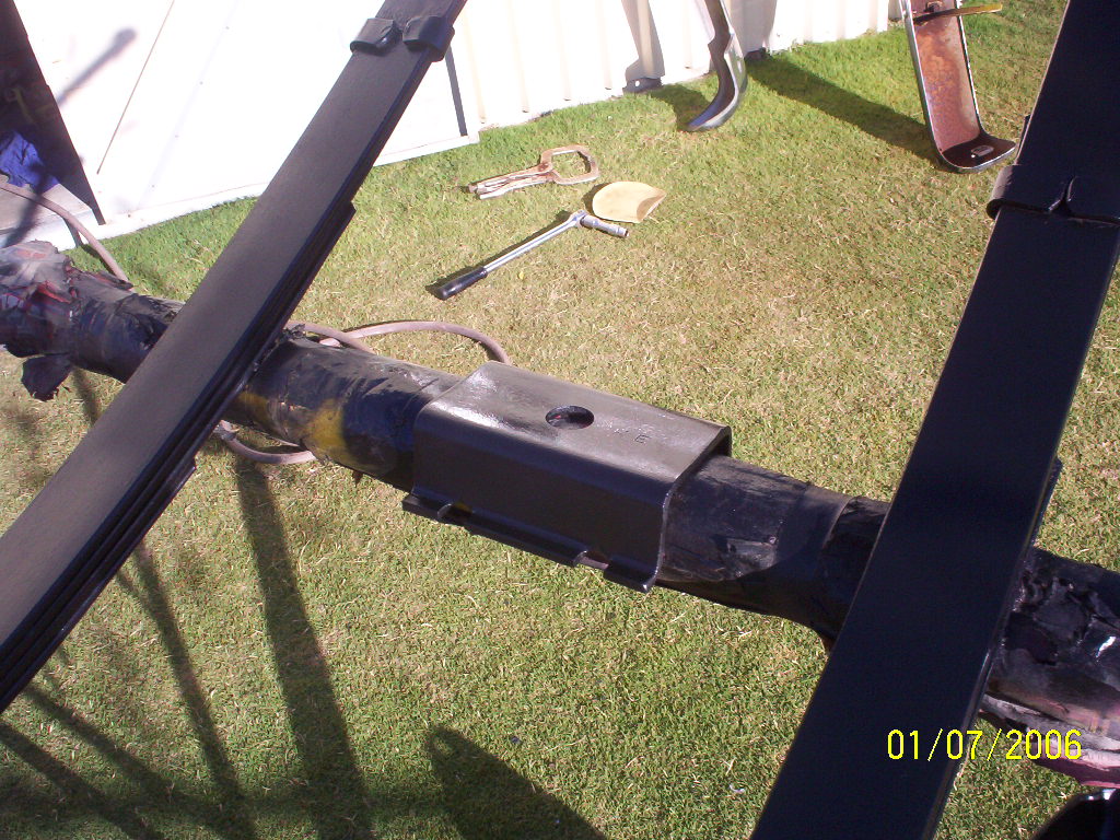

lappy Posted July 1, 2006 Author Report Posted July 1, 2006 All right today the leaf springs got taken out and cleaned Painted Then the assembly started should be in the car tomorow Lappy Quote

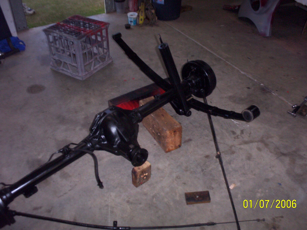

lappy Posted July 2, 2006 Author Report Posted July 2, 2006 (edited) well this morning i assembled the diff Then it was put into the car Edited July 2, 2006 by lappy Quote
