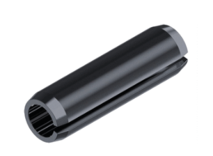

Banjo Posted January 29, 2022 Report Share Posted January 29, 2022 (edited) Hi Tyson, Hopefully, whoever assembled your 5K, did it wet, & there are is plenty of oil on main & conrod bearing surfaces. As long as the plugs are out, there should not be any damage. Squirt a bit of oil down the spark plug bores to prevent any initial dry running of the piston rings in the bore, whist you are turning it over, & testing. So you've removed the oil pump & spun it somehow, & it is delivering oil, so lets assume the oil pump is OK. We can therefore assume, that the over pressure bypass valve has been fitted to the oil pump correctly. Next you need to prove that the oil pump is turning, when the engine is rotated. Sounds like a silly statement, but the oil pump in a 5K is powered by the camshaft, & there are various keyways & roll pins that lock sprockets & gears to their respective shafts. The easiest way is is to remove the distributor (that actually drives the oil pump in a 5K), to turn the engine over, & see down the distributor hole in the block, whether, the knurled camshaft gear on the camshaft is turning. If not, then It is probably an issue with the crank or camshaft sprockets on the front of the engine. There are a couple of critical keyways on the camshaft & crankshaft, that may have been accidentally omitted. If that proves OK, then re-insert the distributor, making sure that the gear on the bottom of the dissy shaft has had it's roll pin inserted. Roll Pin If all that still doesn't turn up something, then you've got me stumped. Let's know what you find. Cheers Banjo Edited January 29, 2022 by Banjo add picture Quote Link to comment Share on other sites More sharing options...
Tysonkp60 Posted January 29, 2022 Author Report Share Posted January 29, 2022 Hi so I have turned the engine over to see if that gear on the cam is rotating and it is. i have added an image of my dizzy as I am unsure what you mean with the roll pin but the dizzy does spin so I am ver stumped Quote Link to comment Share on other sites More sharing options...

Banjo Posted January 30, 2022 Report Share Posted January 30, 2022 (edited) Hi Tyson, Wish you'd mentioned your engine has had a solid lifter conversion. If it has not been done properly, that's why you have compression issues. You will need to change push rods, rocker assembly, & possibly the head. Have a read on these links here on this forum. https://www.rollaclub.com/wiki/index.php?title=Tech:Engine/K_Series/5K-C/5K_Hydraulic_To_Solid_Lifter_Conversion Here is another useful link. http://www.club-k.co.nz/Forums/viewthread.php?tid=14957#pid105004 Hope that helps. P.S. That dissy still has the original factory pin holding the gear to the dissy shaft. The only way to remove the factory pin, is to drill it out, & then most people replace with an appropriate sized "roll pin". Cheers Banjo Edited January 30, 2022 by Banjo adding copy Quote Link to comment Share on other sites More sharing options...
