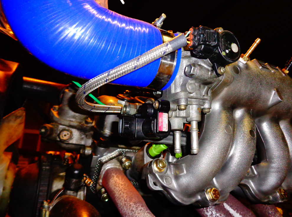

I am looking for an intake manifold throttle body of a 7k EFI KR-42 town ace. I am from Fiji and unfortunately there is no one here in Fiji that has this exact part.
I really do need someone to help me with getting this part.
The picture attached is currently the intake manifold throttle body of our vehicle that is bugged.
would appreciate a help from anyone in this forum right now.

Anyone know if that throttle body was on another car of the same age? An early Camry or something? Toyota were keen to use the same parts over a wide range...
I'd be very interested if someone knows of another throttle body that will fit, or could be adapted to the 7K EFI intake plenum.
I have one here on a 4K engine, that I have been experimenting with over the years, by converting it to EFI, & several different ignition systems.
The trouble with the one I have is, that the "idling bypass valve" is stuffed, & the price for a replacement, is ridiculous.  I was going the just block up all the idling arteries, & fit an external one; around the butterfly, but if I could find a whole late model throttle body one from another Toyota engine, with a very similar inside diameter, then that might be a better & more successful option, in the long term.
Cheers Banjo
Edited by Banjo
add picture
Just blank it off with a plate Banjo, its warm enough up there to make the cold idle un-needed.  Its adjustable if you want to go to the trouble, you could make it hardly by-pass any air at all, or none.
The main problem is the ECU can't run a stepper motor for an idle control.  Just that one advance in electronics simplified so many problems in an engine, Josh just turns the key and the racing car engine fires up and idles at 1250rpm perfectly.
What do you reckon we are looking at?  The resistance of the TPS? Not much reason for Toyota to change that. Size of the throttle plate? The 4AGE changed the orientation of the actuator arm between the big port & the small port, but you can move that around.

Thanks banjo for the insight really appreciate it alot. So i guess no one in this forum knows where i can get the part from right ? cos its been quite hard looking around for this particular one.

I had a look on toyodiy.  The part number for a 2000 KR42 Townace (RHD) is 22210-06040
Toyodiy allows you to crosscheck the part number, and the only other model with that TB is a Toyota TUV - whatever that is.
It is shared whether MTM or ATM
That doesn't mean a TB off a different model 7K won't work, but may not be bolt on.  And differences may well be modest.  What else did a 7K EFI come in?

I haven't heard of any available Ben, but I can check our local wrecker on Friday. Do you need the whole throttle body or just that throttle position sensor above??
