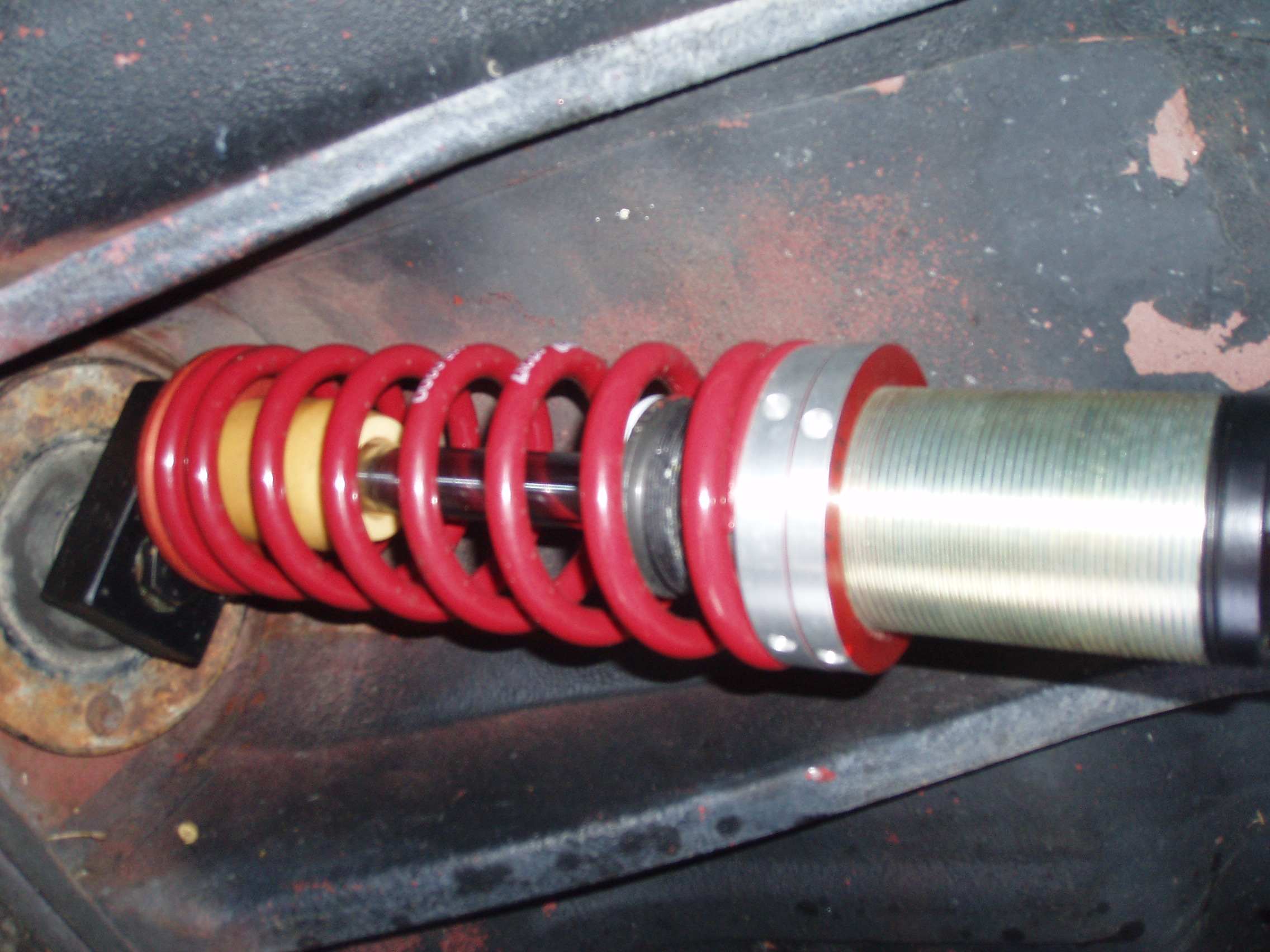

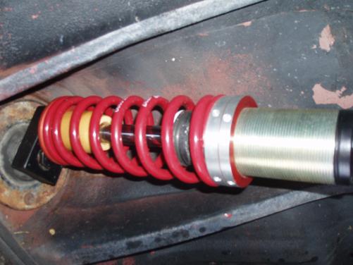

Recently completed fabricating new fully adjustable front suspension set up on my KE17. Removed leaf spring, welded threaded tube to existing struts, fitted wind up platforms and 3" coils & Koni's, repositioned pick up point for lower control arm on the cross member and also position of the top of the struts mounting point.
Ended up with about 2 1/4 degrees neg and some castor as well.
Cost of all this one off fabrication was nearly $2k, not cheep but definatly worth it. Started off by weighing the car front and back to determine the correct Koni to be used, i'm no engineer so had to pay to get it all done. :P
