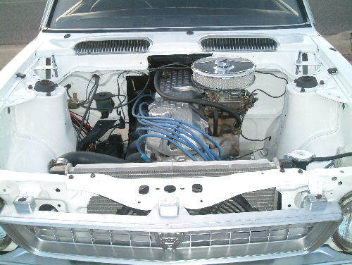

yeah true dan!!! just thought a v8 would sound crazy lol my mates got a ke30 v8 with nos i posted pics of it ages ago should be all finish next month anyway yeah if this guy is gonna do it 6 in a ke70 good luck champ and all the best mate!!! you wont regret it jus ask dan he'll tell ya!!

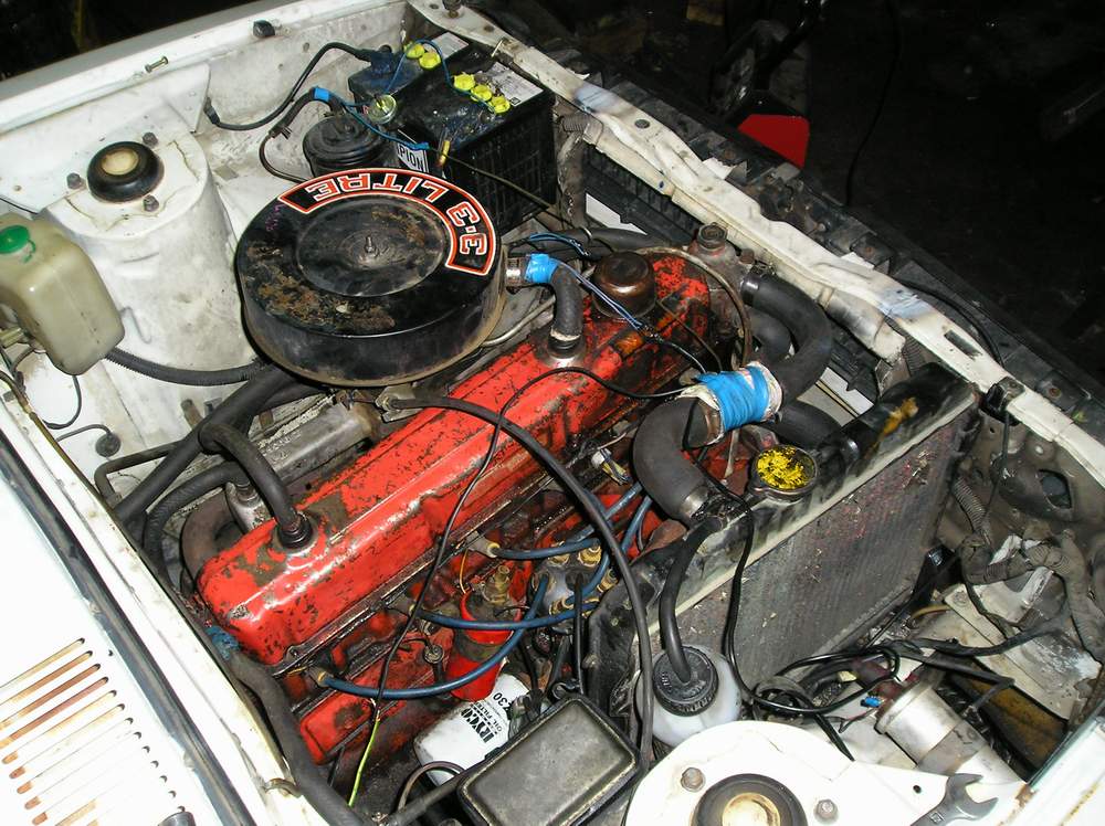

I'd say that hes entertaining the fact of putting either a 250 X-flow or a 4.0L in it?
If so, there is a bloke on here that has a KE20 with a supercharged (?) 250 X-Flow KE20, and a RB30ET KE20 - if he can fit those motors in a KE20, you'd be able to fit them in a KE30-55-70 I'd think ('20 is a smaller engine bay)...

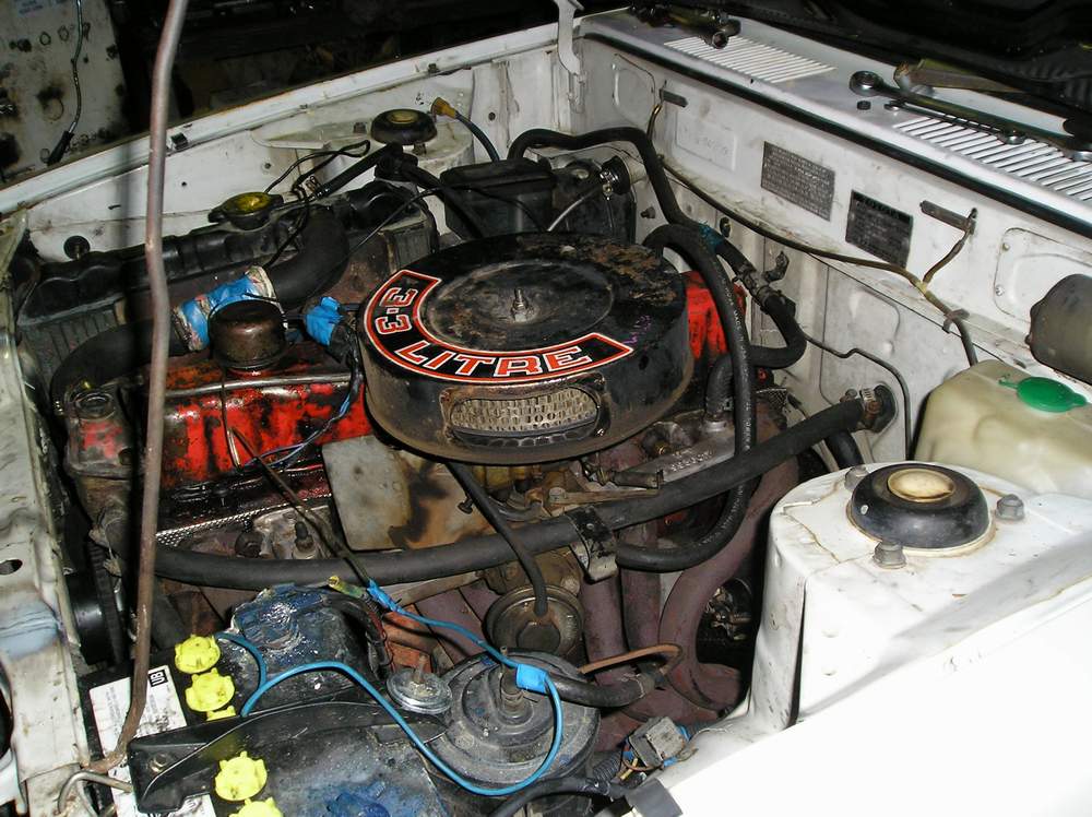

There is also another fella who had a 202 in a KE30. The radiator was mounted on the side of the engine, and the 202 took up the majority of the space between the rad support and firewall, lol. I also know of another bloke with a 202 KE30, he races junior sedans and built the 202 powered beast as a burnout car/paddock basher, haha. Goes pretty hard I'm told. I actually always wanted to build a 202 '30 since Geoff told me of it.
Good luck with the conversion, and post pics!! Because I want to learn from other peoples trial and error before I give it a shot, haha.
Dan
Assumed because this is a thread about putting Aussie motors into little Jap cars :y:
But actually putting a bit more thought into it, I'm gunna assume that he wants to put a RB30 in it (r31 sillhoute) haha.
I don't see why a 4.0L shouldn't fit in it (extensive firewall mods needed, perhaps) because I know of a 250 X-Flow KE20, the 250 is a very similar size to the 4.0L

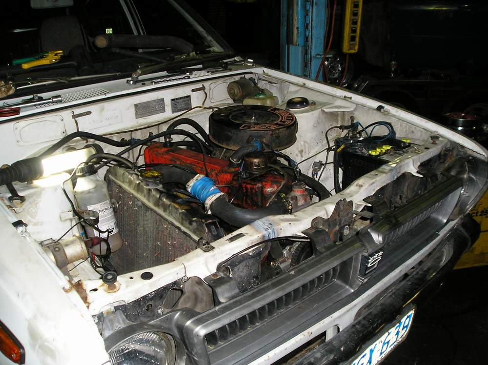

Picture of SUS-020s engine bay. Owner is PMP-020.
Looks as though there was a shitload of firewall cut out for the 4.1L 250 X-Flow, haha.
Yep, I eat my words, just don't remember it eating sooo much firewall.
