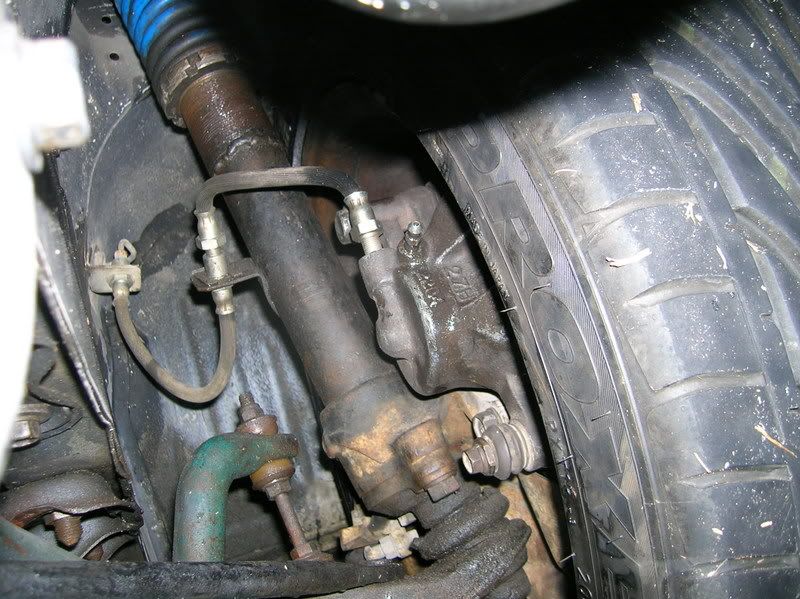

October 16, 200620 yr comment_146769 I'm thinking its the rubber lines. Do you have these in the ke70?? I'm taking the wildest shot but i had ra60 struts in my ke30 and i was using the same rubber hoses that came with the struts. I had the same problem i think your describing. I think it was leaking between the metal join and rubber join in the bracket, but no fluid was coming out. Try this at absolute last resort. Report
October 16, 200620 yr Author comment_146771 http://i29.photobucket.com/albums/c292/aro...d2/DSCN0338.jpg theyre the only rubber lines i know they look stretched but theyre not as bad as they appear :D i think the caliper needs twizzling once to give it some slack, not sure...ill do that someday.... and yes there is alot of fluid around, this is a result of the aforementioned compressed air ;) Report
