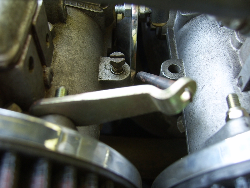

November 27, 200619 yr comment_152616 Ok guys, i have searched the forums and tried searching google but to no avail, bought a lynx corp twin sidedraught weber/dellorto (for dellortos) and I'm lost as to how to connect it all up. Have a slight idea as to how it works but not down to exact details. If any one has a link to help on them or can supply close up pics of their set ups it would be a huge help. Thanks in advance for any help, Nathan Report
November 27, 200619 yr comment_152626 hey dude you can buy linkage kits or have a go at making your own using a cable setup which is quite easy. i'll see if i can find some instructions or pics for ya. Edited November 27, 200619 yr by styler Report

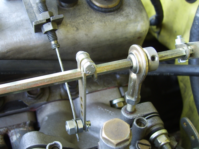

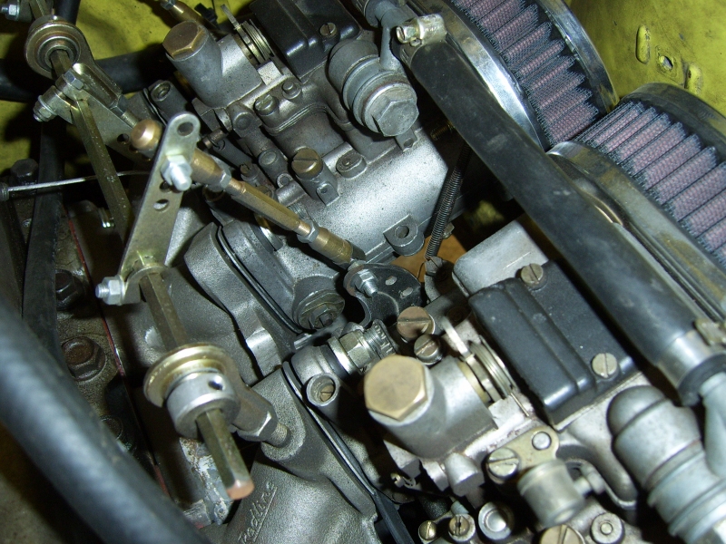

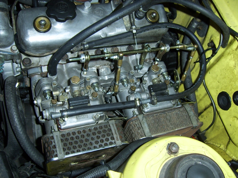

November 27, 200619 yr comment_152644 These pics may help, Let me know if you need more.. By the way, If you get stuck, Go to the guys at Recarb (Waterview Street Warana), They fitted mine and set the linkages up.. Report
November 27, 200619 yr Author comment_152671 Thanks that would help heaps Styler Medicine Man did they do the jets in yours at Warana? Thanks for the pic, can you give me a close up of where each arm comes off the main bar, and where the uprights for the br connect to the manifold? Report
November 28, 200619 yr comment_152682 Yeah, The did all the jetting for me too. I'll get some better close ups later.. Report

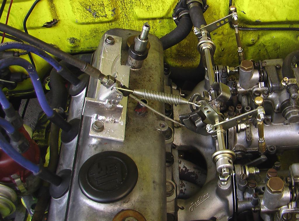

November 30, 200619 yr comment_153114 Redline performance products do linkage kits they are on the net or your localautobarn or parts retailer usually can order them for you and the money they are its worth it in the end i think. I agree. I used the redline linkages on my Dellortos. They are packaged as a set, complete with instuctions. I modified mine a little and welded on an accelerator cable linkage. Ignore the feather on the firewall.....Thats a Trophy. :y: Edited November 30, 200619 yr by kangaroosa Report

December 1, 200619 yr Author comment_153262 Ahh ok, i picked it up during work at around lunchtime yesterday and didnt leave till 11pm, so when it wouldnt go on easily after looking at it for 10 mins i left it and went to bed. i have a stock 2tg one somewhere so ill just use that as a template. As far as the linkage is concerned i may just get it done when i get the carbs jetted and fitted, unless i can find a weber/dellorto linkage with instructions. The uprights on mine atm are made of plastic, as are the ends of the arms (yellow boxes in pic). They probably work fine but it just seems sketchy Report

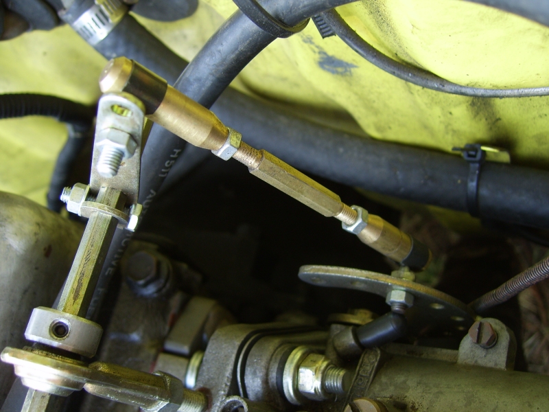

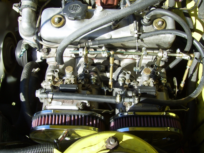

December 1, 200619 yr comment_153276 I also had the face of the manifold machined down to the same thickness as my extractor mounting plate. I had to do that because the bolt was actually tightening up on the manifold but not even contacting the extractor mounting plate. They had the same dramas when fitting mine, The guy at recarb was hesitant to machine down the intake manifold the same size as the extractors as you can never put it back on. Instead he fabricated some washers up to push down on the extractors where they needed it to keep it sealed properly. Here are some more pictures anyway.. Report
