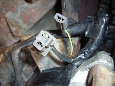

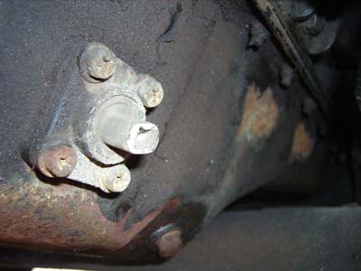

charl Posted May 24, 2008 Report Share Posted May 24, 2008 hi all, i have been building this car for a while now and ive finally gotten to a drivable point. but my bettery kept dying and the charge light wouldnt turn off. so upon investigation i found that my alternator isnt connected. the problem is its not an original one and only seems to have place on the back for the positive wire to screw on and one other wire to plug in. the standard ke20 wiring loom has a three wire plug as well as the positive wire and one other wire waiting to go into the alternator. ive been searching all morning to try and find what i need to do but i don't understand much of what ive read. so if anyone could please help me or point me in the right direction i would really appreciate it! thanks Charl Quote Link to comment Share on other sites More sharing options...
ke30dude Posted May 24, 2008 Report Share Posted May 24, 2008 has the alternator you have got a little black box on the back of it? if so then it is an internally regulated one. I cannot remember how to hook this type up but from memory it was simple. Alternatively you can buy a externally regulated one like this. http://cgi.ebay.com.au/ws/eBayISAPI.dll?Vi...E:B:DBS:AU:1123 Quote Link to comment Share on other sites More sharing options...
Medicine_Man Posted May 24, 2008 Report Share Posted May 24, 2008 The one you have sounds like an internally regulated alternator. What you need to do is find the charge light wire and connect it to where the other wire will plug in on the back of the alternator. Being Toyota I'm pretty sure it should be a yellow wire that goes to your external regulator... Quote Link to comment Share on other sites More sharing options...

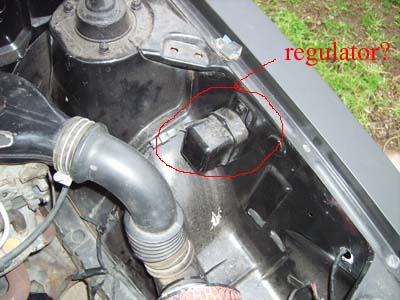

charl Posted May 24, 2008 Author Report Share Posted May 24, 2008 thanks for the info. it is an internally regulated one sorry i didnt mention that earlier! so just to make sure, there will only be two wires connected to the back of the alternator, the constant positive, (fat wire with ring connector), and the charge light wire, (possibly yellow) and that would mean i can remove the xternal regulator from the car as the rest of the wires only go to that? i might be pushing my luck but... pics would be helpful! Quote Link to comment Share on other sites More sharing options...
ke30dude Posted May 24, 2008 Report Share Posted May 24, 2008 Ok I just had a sneak and peek at my fathers torana with a internally regulated bosch alternator. The small wire goes to the CHG light The one that bolts on goes to the positive. :( Quote Link to comment Share on other sites More sharing options...

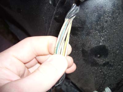

charl Posted June 13, 2008 Author Report Share Posted June 13, 2008 ok, now I'm really confused! i tried the thing about connecting an earth to the connections for the alternator to see which one is the right wire to connect to the back of the alternator. of the four wires i have none make the charge light in the car go on. so my question to you is this... NOW WHAT? i would really like to have this sorted before the 28th of this month because i want to go on the adelaide cruise that is on that night! I'm gonna go buy a new battery on sunday as well just to be sure but i need to get this wiring sorted out. any help would be greatly appreciated charl Quote Link to comment Share on other sites More sharing options...
