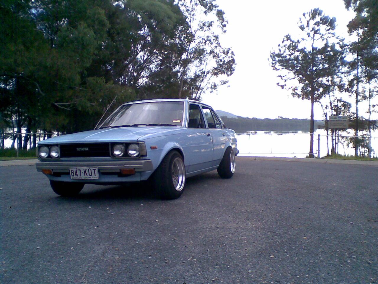

umm just an 82 ke70, when i got it it had a few spots of rust, fixed the bad shit still got a few little spots tho, but i don't want it perfect.
umm, k some specs
just got the jdm front quad headlights, they were cool once when only 5 people had them but now that everyone has them i feel like converting mine to slanty just to be different these days lol.

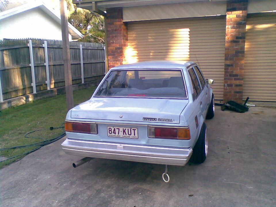

in the rear its just some 4.4kg springs that were laying around at jono's with some gabriell short strokes just witn some new nolothane bushes to keep it stiff, got more 1jps springs lined up but I'm waiting until the new diffs in until i can work out what height i need for it.

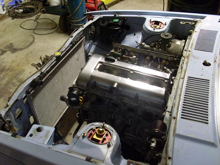

umm, got an n/a sr20 to put into it in a couple of weeks, just fiddlign around making extractors and x member and what not at the moment. its got the gtir quad throttles, light as f@$k JUN flywheel, haltech e3k computer and yeh just running the CAS setup.

Nice little unit that.
The painted bumpers look good too.

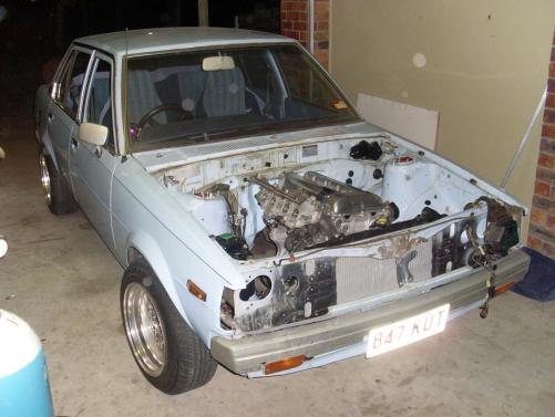

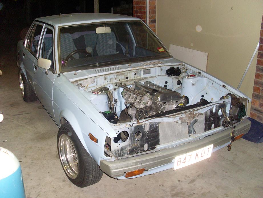

got a few more things done tonight, umm bashed out my tunnel and bellhousing fits ok now, umm tomorow arvo hopefully i will have the gearbox in and make up a mount. ummm, got a few other fiddley bits sorted out got new rubber fuel lines from tank to bay, and ,modified the fuel rail a bit to fit better by cutting one of the tabs of the solid lines then bending it out and flaring the end, then with the return i got one of the turbo smart fuel reg adapters for the rail then put an elbow comign off that and now it fits nicely, still need to work out what i will do with my heater tap tho....still little worried about that, ahh, got some more vac line and conected up the brake booster vac line, ahhhh, diffs out and ill put the t series in on saturday, then i can measure up and get my tailshaft ordered. also started making my trumpets at work today, got something diferent in mind tho you will have to see it , sounds dumb when i explain it in text haha. um then pretty much after that its just wirieng and a tune and i can get out and skid haha.
