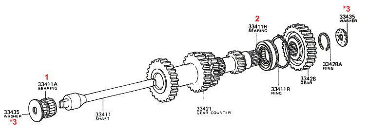

I was starting a big cleanup of the many photos scattered around my computer and found this...

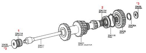

haha I actually logged on today just for the purpose of correcting myself about those bearings.
It's been a few years since I re-built that gearbox and couldn't quite remember what the problem was. Anyway I checked the layshaft last night I remembered they DO have some needle bearings races in each end of the layshaft. The problem I couldn't remember was that they have a pretty poor bearing design, and its the actual bearing which eats into the shaft it runs on. I'll try and find the shaft I had to get pressed out to show you just how much they bugger the shaft.
