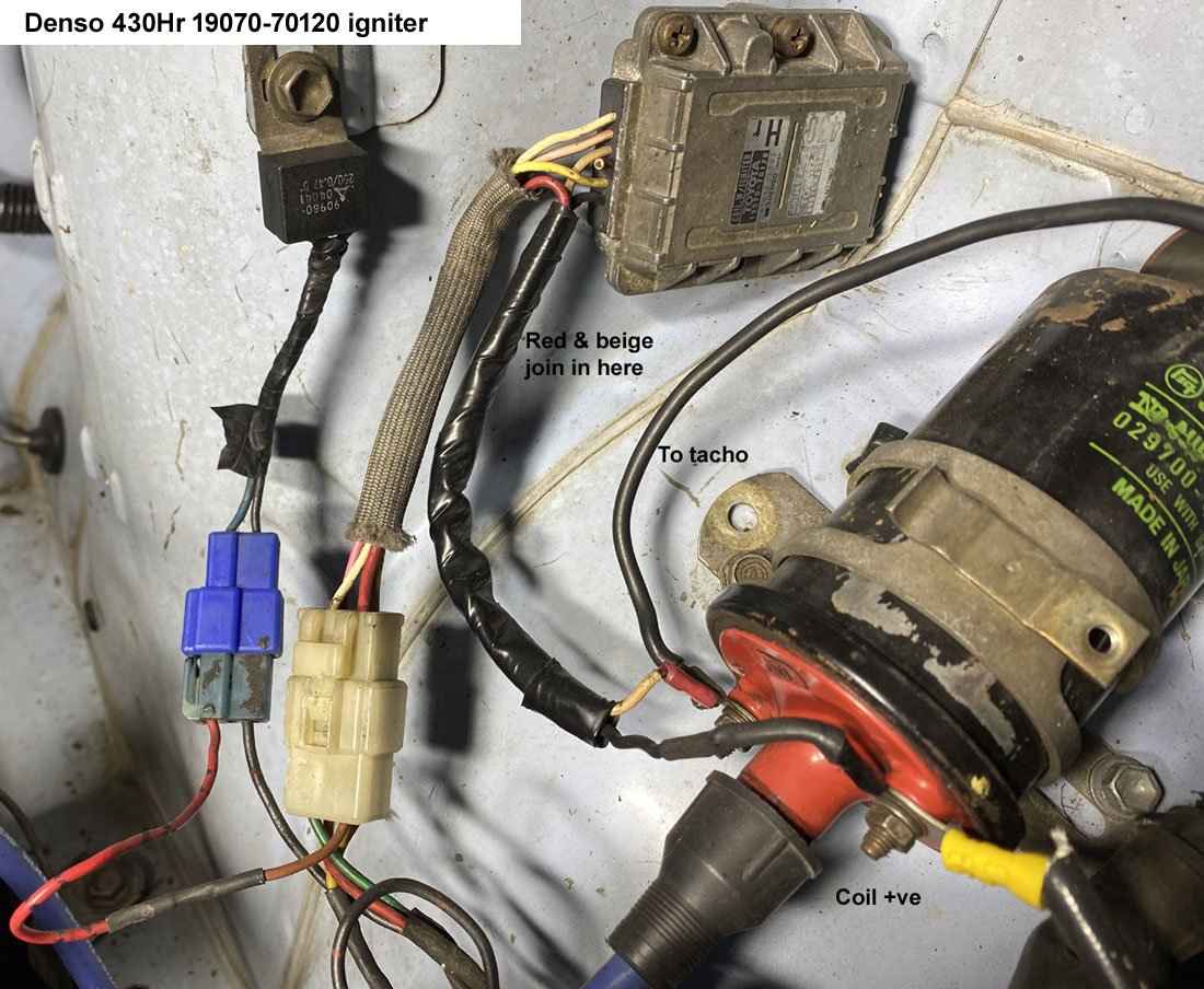

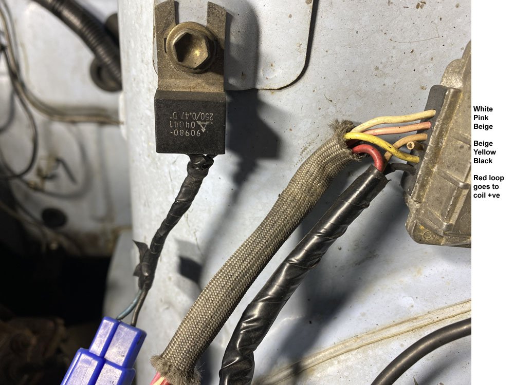

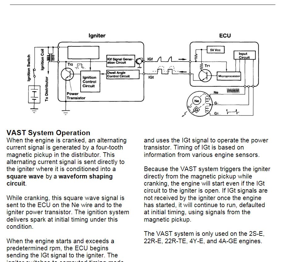

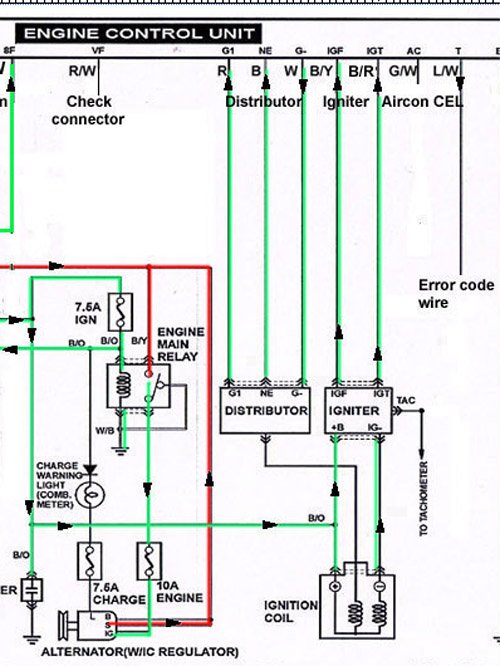

  2. I'm not sure how similar these systems are, they must be about the same age. This is on my early 4AGE motor- Here's the theory- Here's the diagram- Here's what it looks like- and here are the colours on mine. One wire was cut off when I got it. As you can see, the colours don't agree with the diagram, Toyota were busy making a lot of different ignition/ECU systems doing the same work around the early 1980s I think, its always very confusing. I took my tacho off the coil negative. I've never seen electronic ignition on a KE70 so I'm not much help for you I'm afraid.
