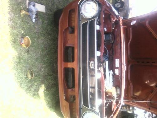

  5. THANKYOU in advance, one day I might be able to return the favour. So I own a 78 ke30 corolla with 3k-c engine. My oil cap disappeared. it was round in shape and the push in type (rubber) According to every parts manual & toyota themselves, a 78 corolla is meant to have the screw in type with hand grips on it. Which was confirmed when I went to the wreckers and the ke30 had that exact screw in type. -What is the go, and what can I use to replace it other than the sleeved replacement I made (auto stores don't have anything big enough) The second part is when it disappeared it sprayed oil everywhere, therefore leaving my oil empty, and now my engine wont stay on unless I hold the key halfway between the starter motor and on- my thinking was this was some sort of safety thing so the engine won't blow? but It has the same problem since I filled the oil. I find it hard to believe they aren't related since it only happened straight afterwards and I have never had electric issues, but hey stranger things have happened. THANKYOU (I'll ask another mechanic but the apprentice gave me a blank look and I can't bring the car in)

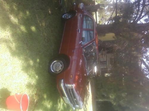

  7. Name: Car: 1978 ke 30cs 140,000kms owned by grandma for 20 years Motor & Driveline: 3kc, new clutch and 4 speed :'( needs a better clean but is a very neat bay (nothing exciting happening yet, probs cam, carb and extractors when suitable products found. Suspension & Brakes: All standard soon to have the usual treatment of cheapest most effective lowering & brakes ITS SOO HIGH AT THE MOMENT! Wheels & Tyres: Stockies with chrome trims Interior: yucky disgusting cloth on seats, leather door trims, new boss kit for steering wheel but yet to decide on wheel, no cracks in dash & clarion head unit with 6x9s in rear custom parcel shelf Body: lots of little dings & yet to be polished, but is RUST FREE except for some tiny pins in the front right guard and all chrome is excellent Other: 3 weeks i've had it. First car i've owned passed rwc with no mods and cost $250 :D VERY limited time to do mods but i have the will Just keen on having a straight clean sensible car that brings all the bitches :P

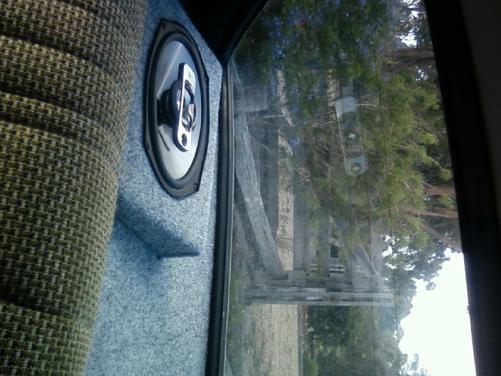

  11. Nanna spec is definitely GOLD. two weeks into owning my car and the two biggest hits are the "custom" wood varnish shelf under the glovebox, and sheepeskin matt on the rear parcel shelf, both of which are courtesy of nan. I drew the line at having only an AM radio though.
  12. yes that was my understanding, and it doesn't necessarily do it when I'm pushing it hard! just as likely to do it parking :/ nothing has been eliminated as of yet except that he checked the wheel bearings and should of done everything else but he wasn't my preferred guy so I will take that with a grain of salt plenty of people in town but a large expense anyway- Bearings wouldn't do anything as it is it's a 3k, not sure if i could handle a 4 yet :P cheers, any idea is a good one WELDER :D for now I'll just keep putting it on the stands and going through the bits when time allows. I found time to install the stereo (AM didn't do it for me)

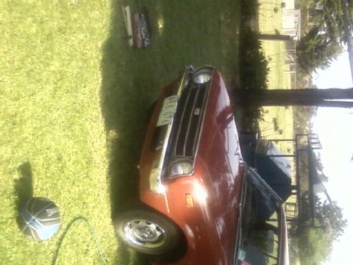

  15. I drove my KE30 home from dandenong on the weekend, its blood orange/red and stock with no rust. Now located in Bairnsdale
