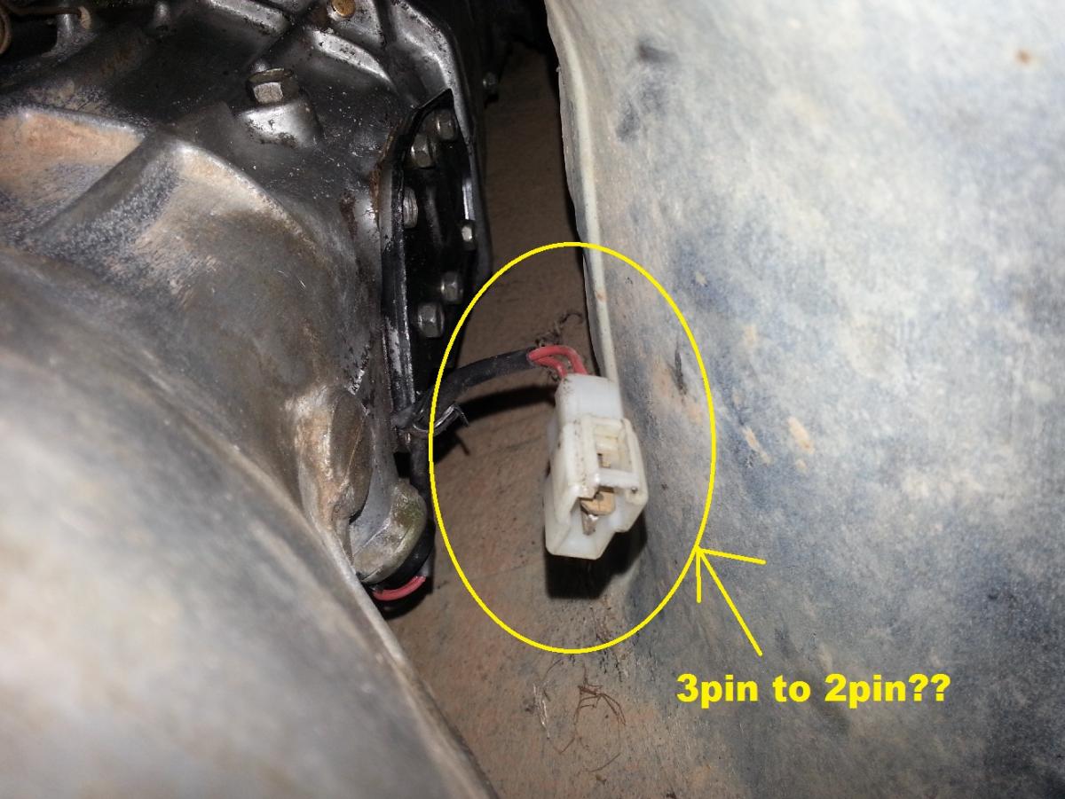

  4. IT WORKED!. tested. brought the connectors and wire from jaycar full kit was around $10 thanks heaps for the help

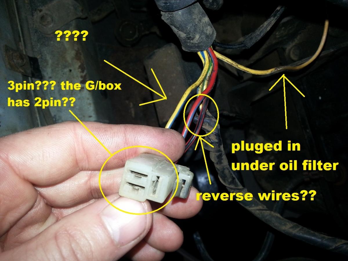

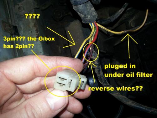

  5. sorry for the many dumb questions. when it comes to electronics I'm stuffed this yellow/blue is hooked up to the red reverse wires making it a 3pin so do i just not hook the Yellow/blue up and buy some clips and wire from Jaycar? thanks for the help.
  6. cool thanks. the main reason i didn't think it was one of those is the connector there has 3 wires in it the 2 red/blues and one yellow/blue. is this a earth wire or something or .does it hook up to a flux compositor for time travel (useless in other words)

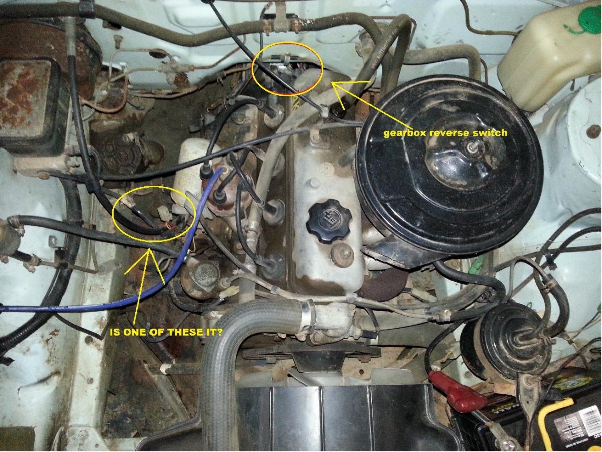

  7. nope manual k50. still can't find it. and I'm going nuts i have a pic of my engine bay here, just less clean http://www.rollaclub.com/board/topic/67706-ke55-reverse-light-wire/
  8. I have a ke55 coupe (square headlight) with a 4k-c and k50 was a junior rally now my project to get back on road. I'm keeping the 4k-c and k50 for now (stupid saving for house, i want car parts) under the bonnet I can not find the the reverse light wires. I can see the reverse switch wires coming out of the box its the other side (wiring loom side) i can't seem to find. ive looked under the booster, under the car and am about to check under the carpet in the car (its dirty anyway) this has been the bane of my existence.for about 2 weeks can some one post a pic of what and where its supposed to be. I really think i may be missing a wire or a length of. thanks.
  9. i can't seem to find the wires in my engine bay. I've looked all along the firewall and can't find the wires from the loom to hook up to the reverse switch can some one point it out for me??
