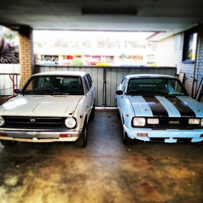

November 24, 201312 yr comment_672431 hey all just got myself a ke36 wagon. was going to be a part car for my ke55 coupe but it's too good to part so fixing it instead. anyway to the issue. idles rough without choke pulled the charge light stays on and when I put my foot on the accelerator (heavier than feathering or choke) it'll cut out. I've checked the dizzy had a little bit of shit on the points once cleaned the car starts a lot easier. but the idle is no good. would running rich cause this (smells like it)? here they are. Edited November 24, 201312 yr by bridge_86 Report
