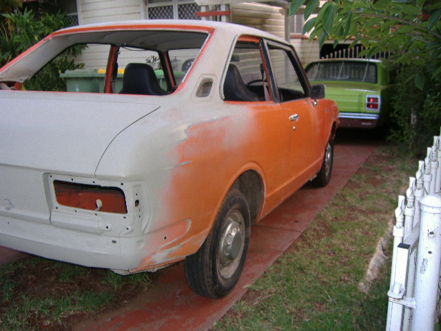

  2. just some pics of ke20 i bought don't know what going to do with it yet, either paint it hot pink and white wall it and keep it std, or put a v8 in it
