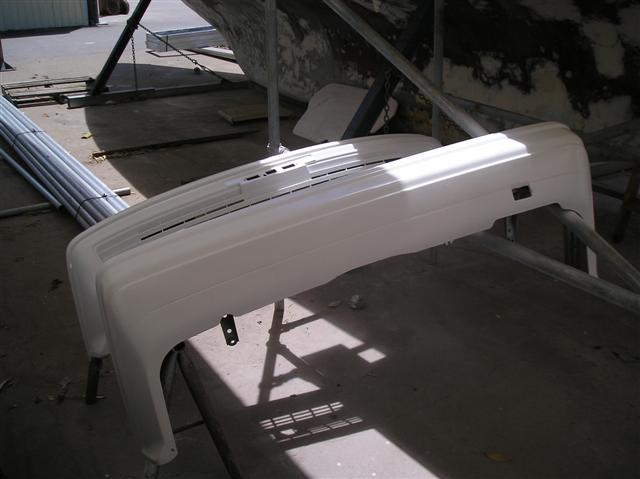

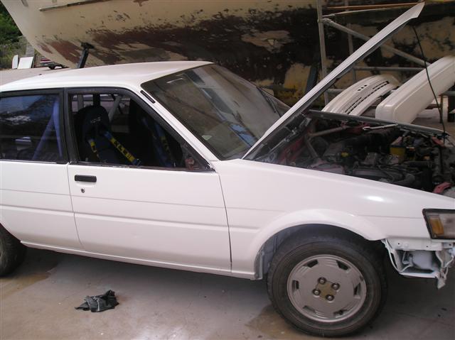

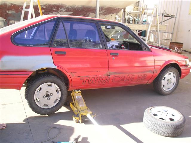

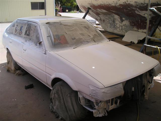

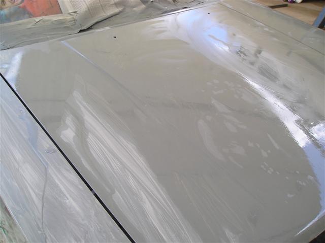

  2. update: painted it this weekend. sanded back the red shine scraped the twin cam stickers off and masked up everything. 1 coat of protective primer followed by wet and dry 400 all over then 2 coats of 'tinted white' for finish will give a light polish. Bumbers get all paint sanded back, adhiesion promoter 2 final white coats. Got a few bugs and crap on the final coast but nothing that wont buff out.

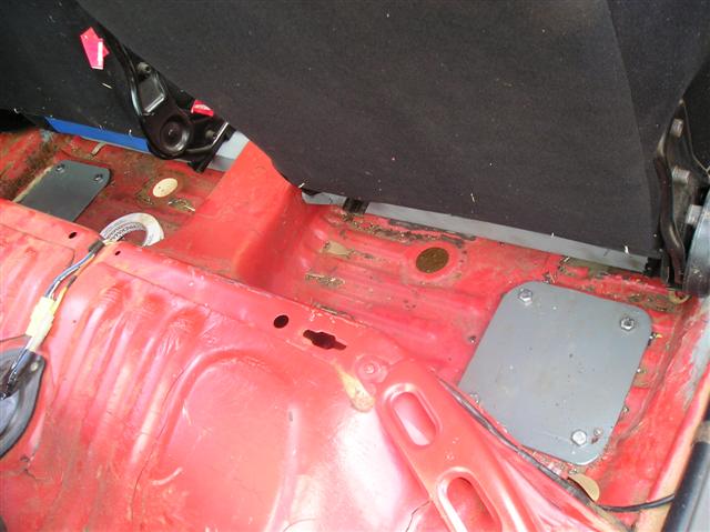

  4. more progress pics. Still to do to get it on the track: refit muffler with a new bracket, cut and fit skid plates to mounts, fix driver side window winder, oil change. Same people I got the car from has got another of the same model and year. Buying entire running 4age engine from him with extractors for $400, we will mod this engine to what we want then simply replace the stock one when its done. Still need to finish the paint work.

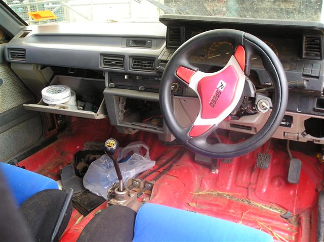

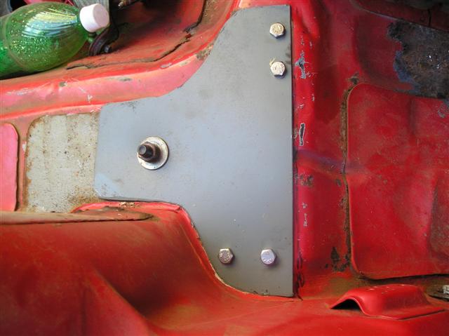

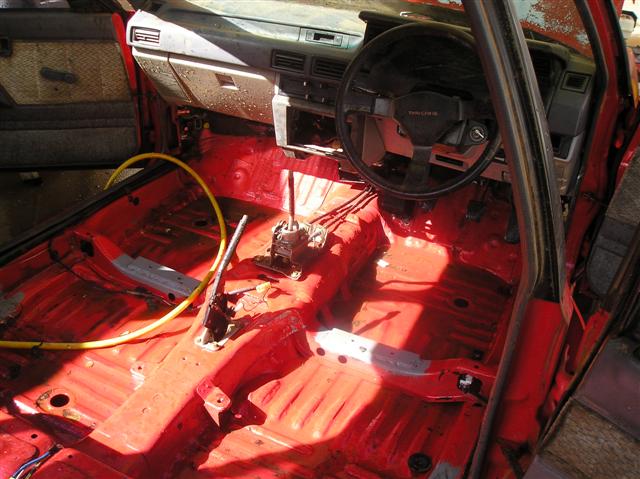

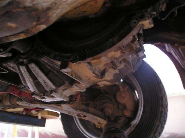

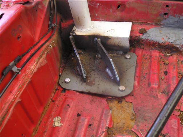

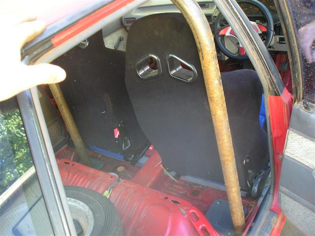

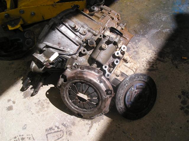

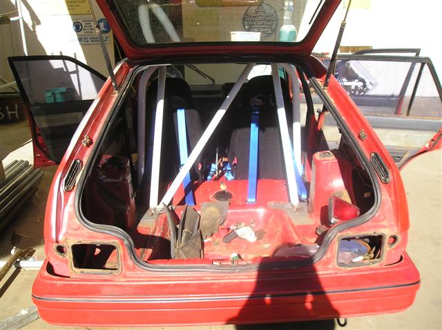

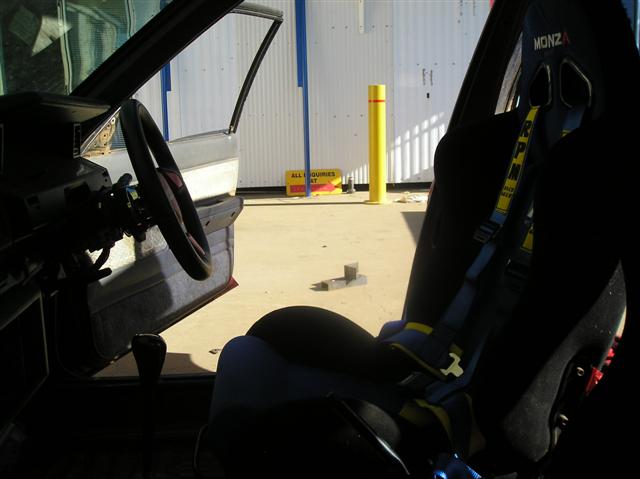

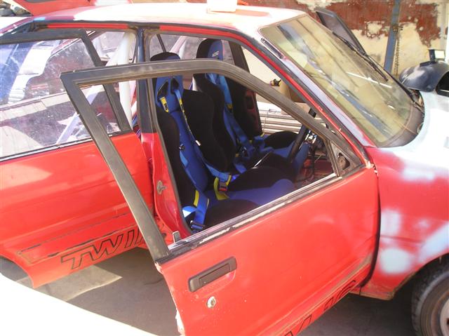

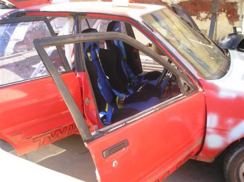

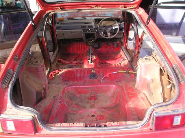

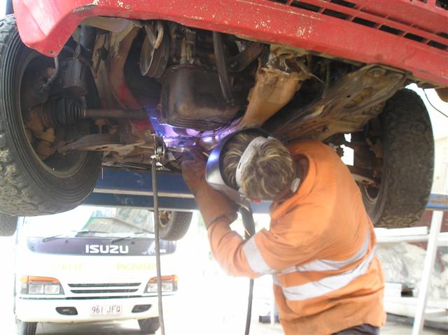

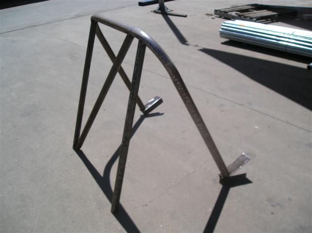

  9. BiGGy replied to imnost's topic in Rollaclub Rides

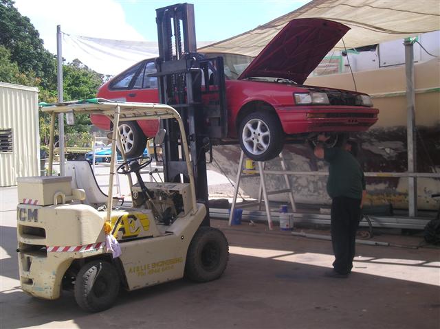

  11. you talking about the forklift? Shes as sturdy as a rock mate. Hydraulics are supported just in case.
