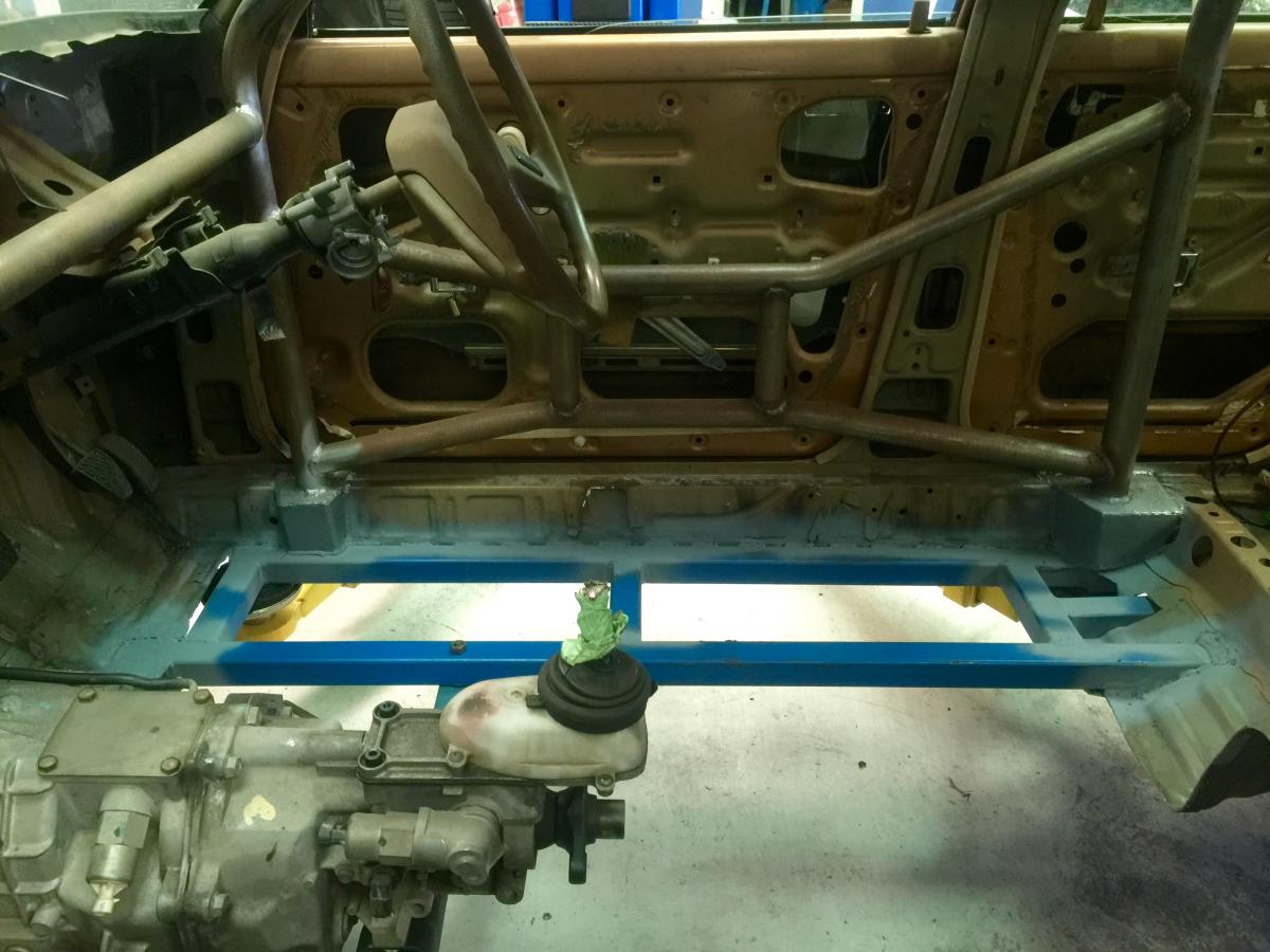

  1. I don't think it's called for tbh. This stage is costing a lot more time and money than I planned but sort of needs to happen. Once the floor and tunnel is in we'll be adding onto the cage to make it better for side impact and doing a little more under car for the ass end. Have to stop some where otherwise it'll never hit the track :)

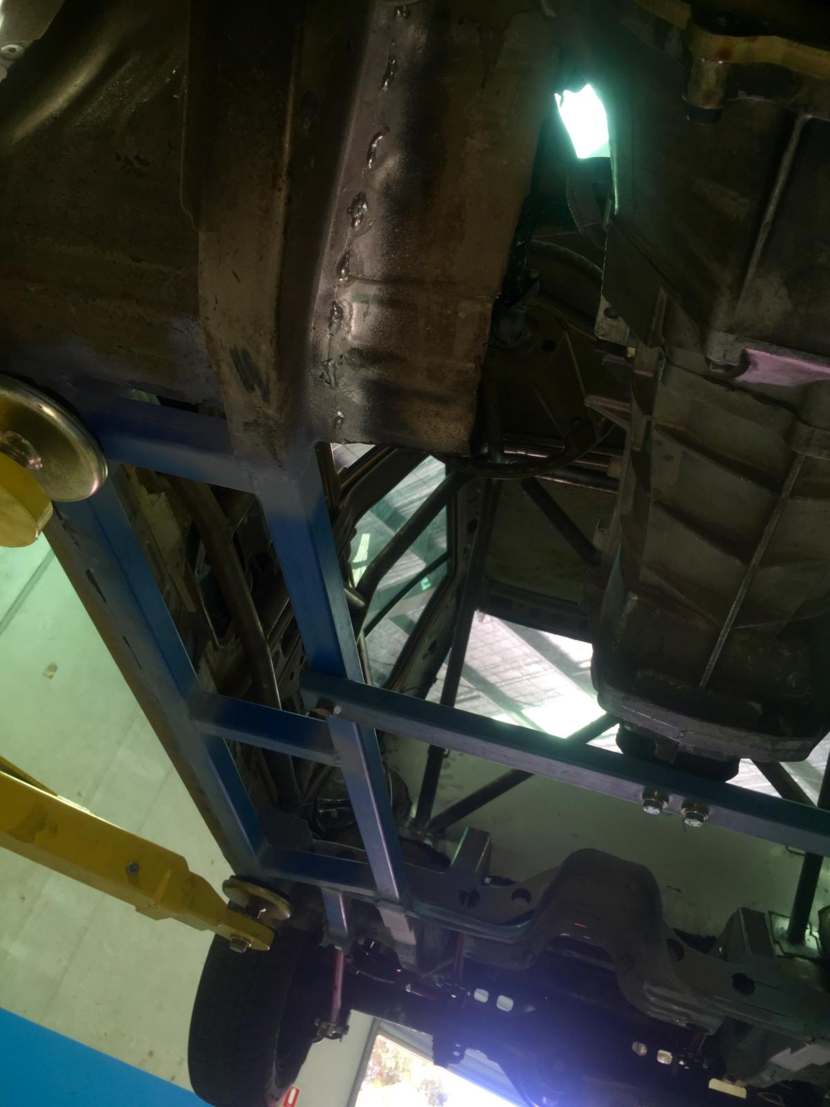

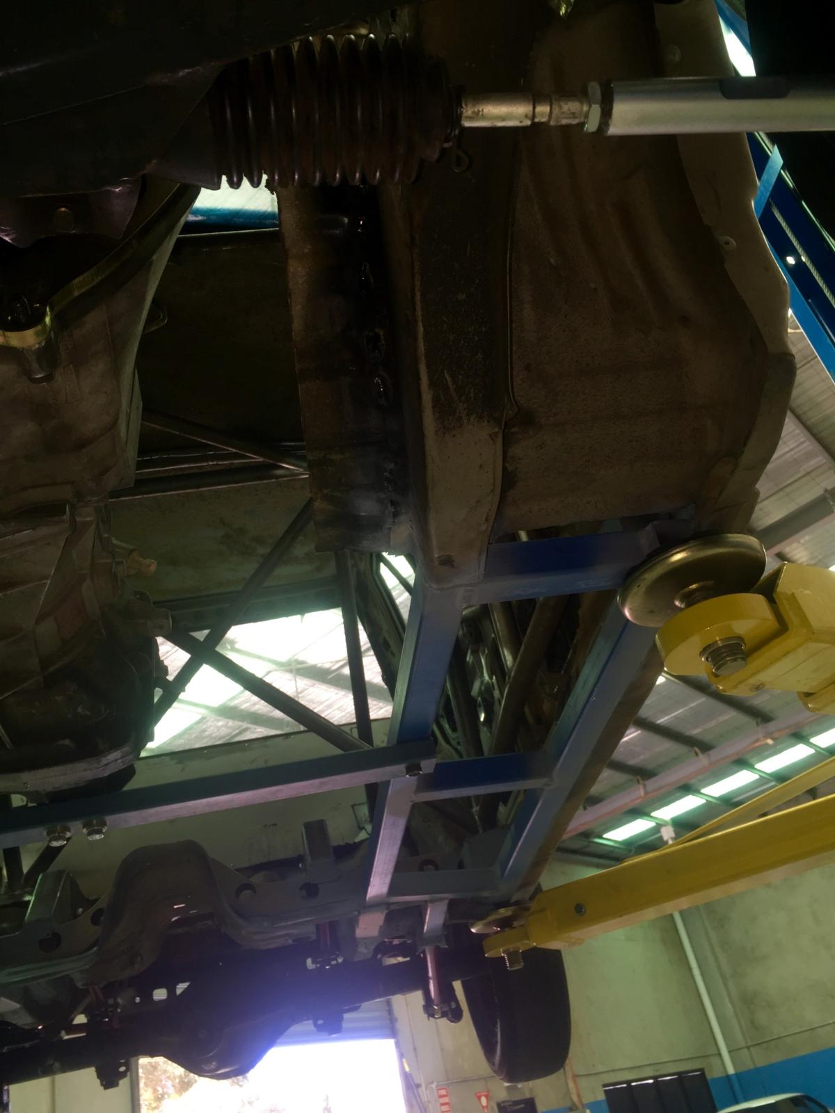

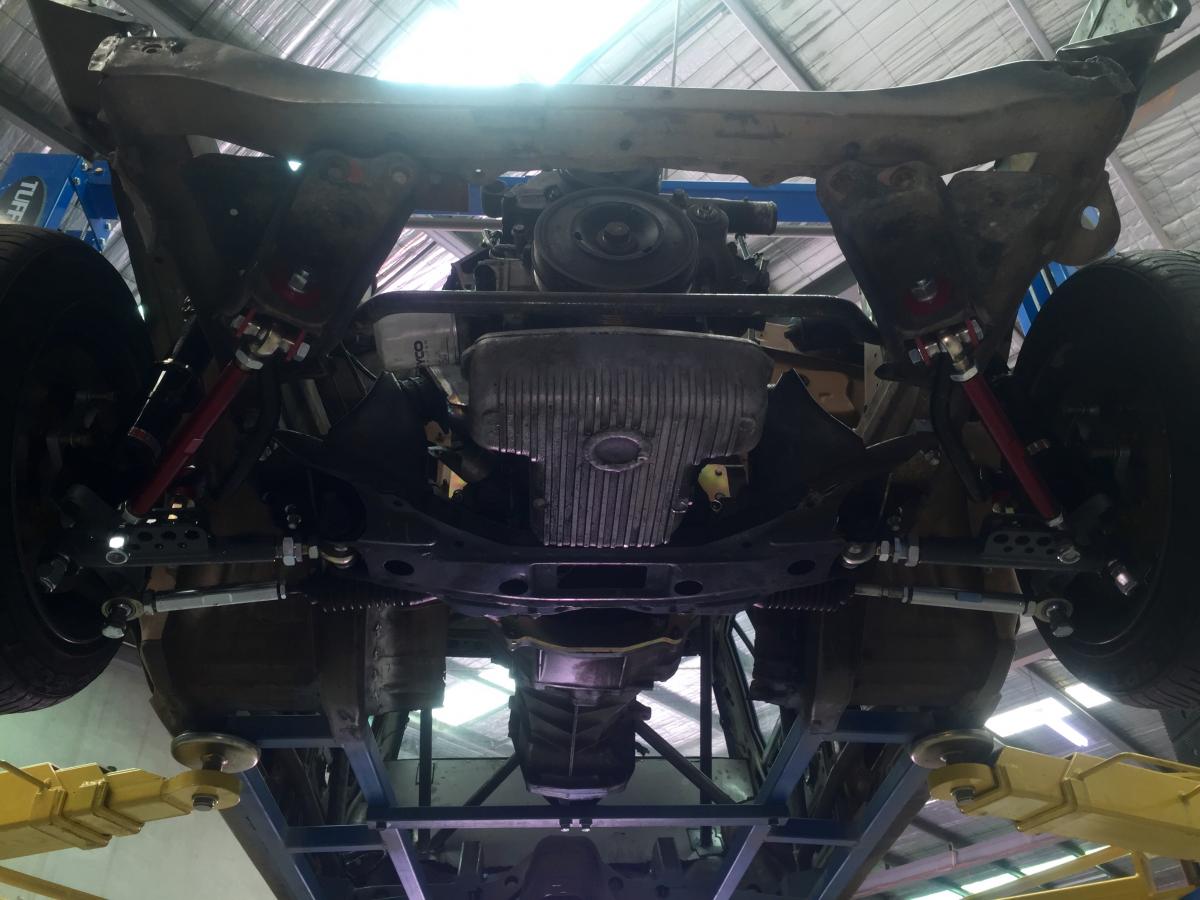

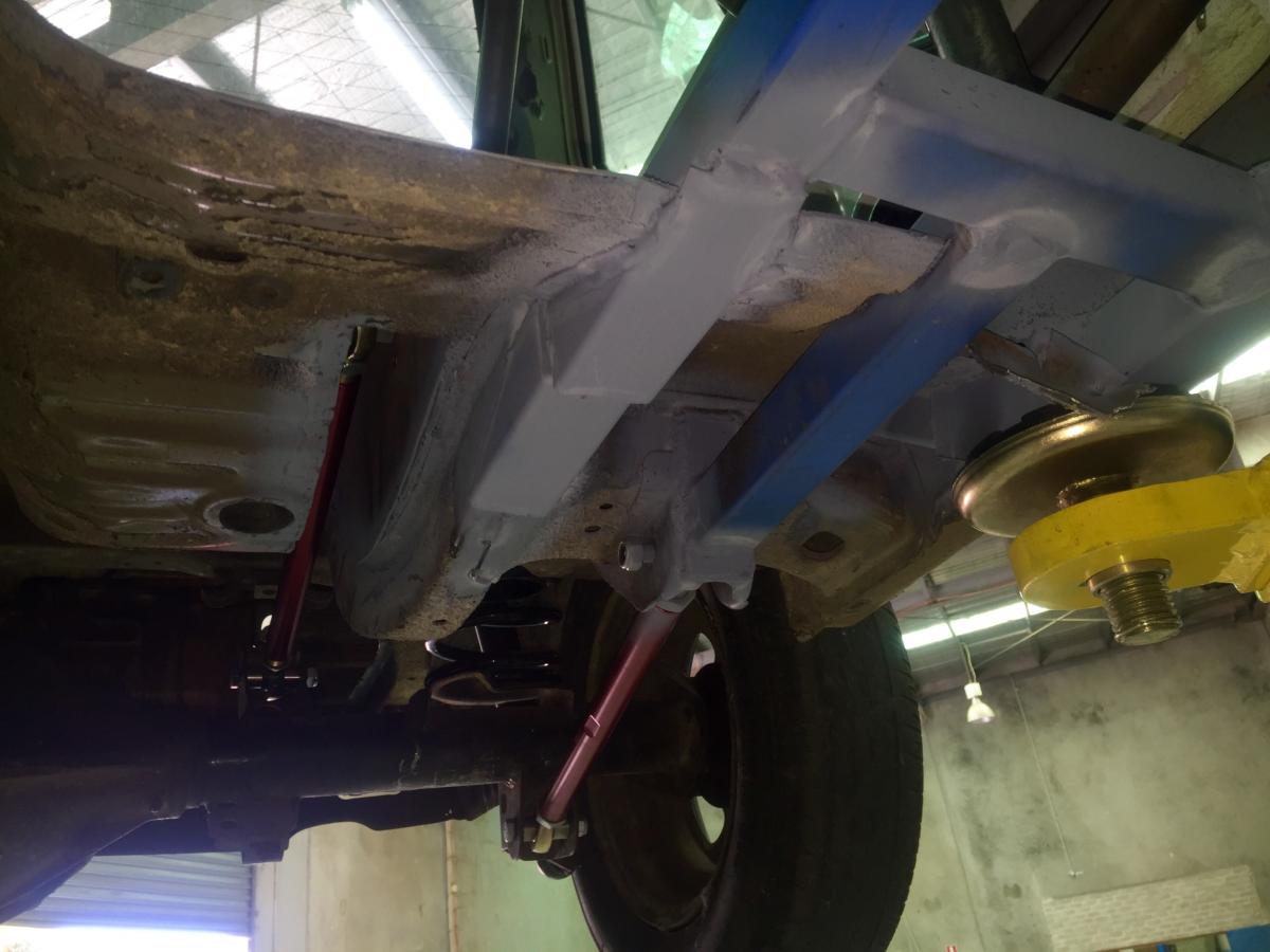

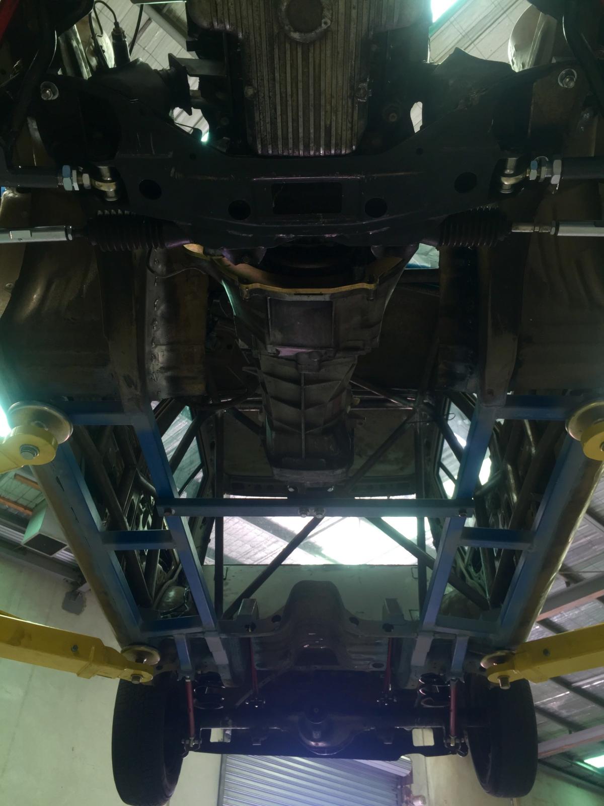

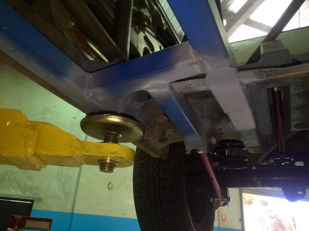

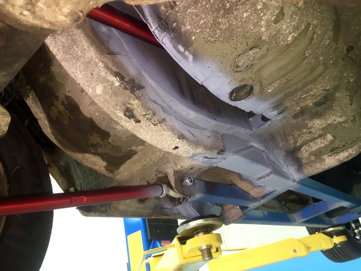

  3. Finally got some time to make progress after ages of part collecting. A mate has fabbed the chassis mods together with some really good simple ideas implemented. The main goal was to bring the chassis and cage together as well as implement the longer upper control arms to match lower arm length for good pinion angle under full tilt which there will be a lot of. All nuts and bolts are roughed in and half of them will be replaced to go with a bit more plating for strength on arm pick up points too. We are aiming for Vic time attack in April to have a red hot go and establish a personal best time for Phillip Island to further improve on over time.

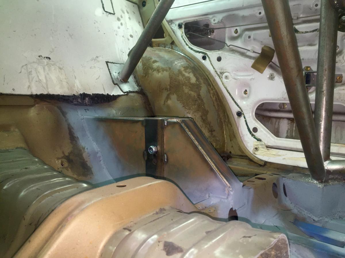

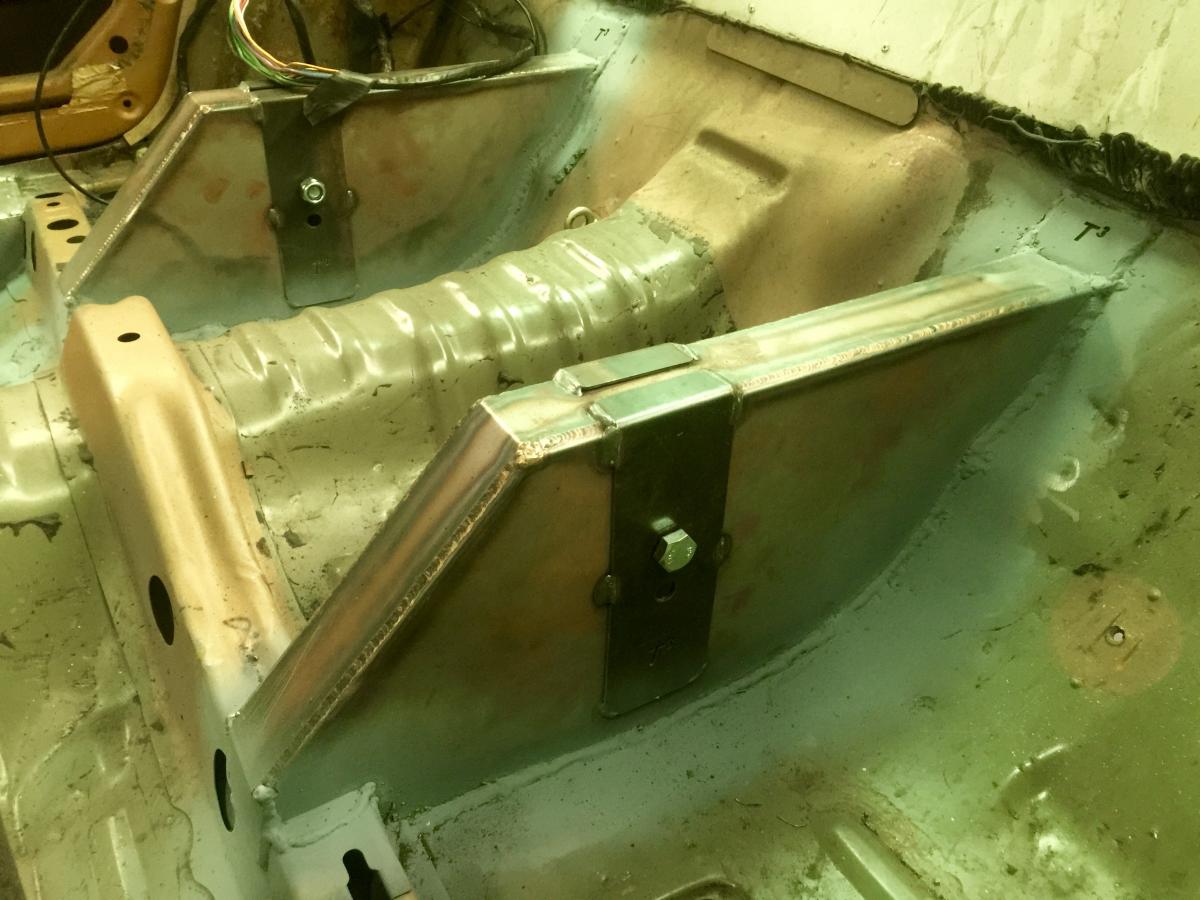

  9. Great advice! I'll look into riveting more as well as different welding methods. I have a tig and looking to get a mig so just seems easier but could be wrong The previous owner stitch welded the whole car but I'll be looking at making the rear better where there seems to be much less strength in the body there. My main concern is the actual mounts for the suspension arms to body. Can just see something giving there

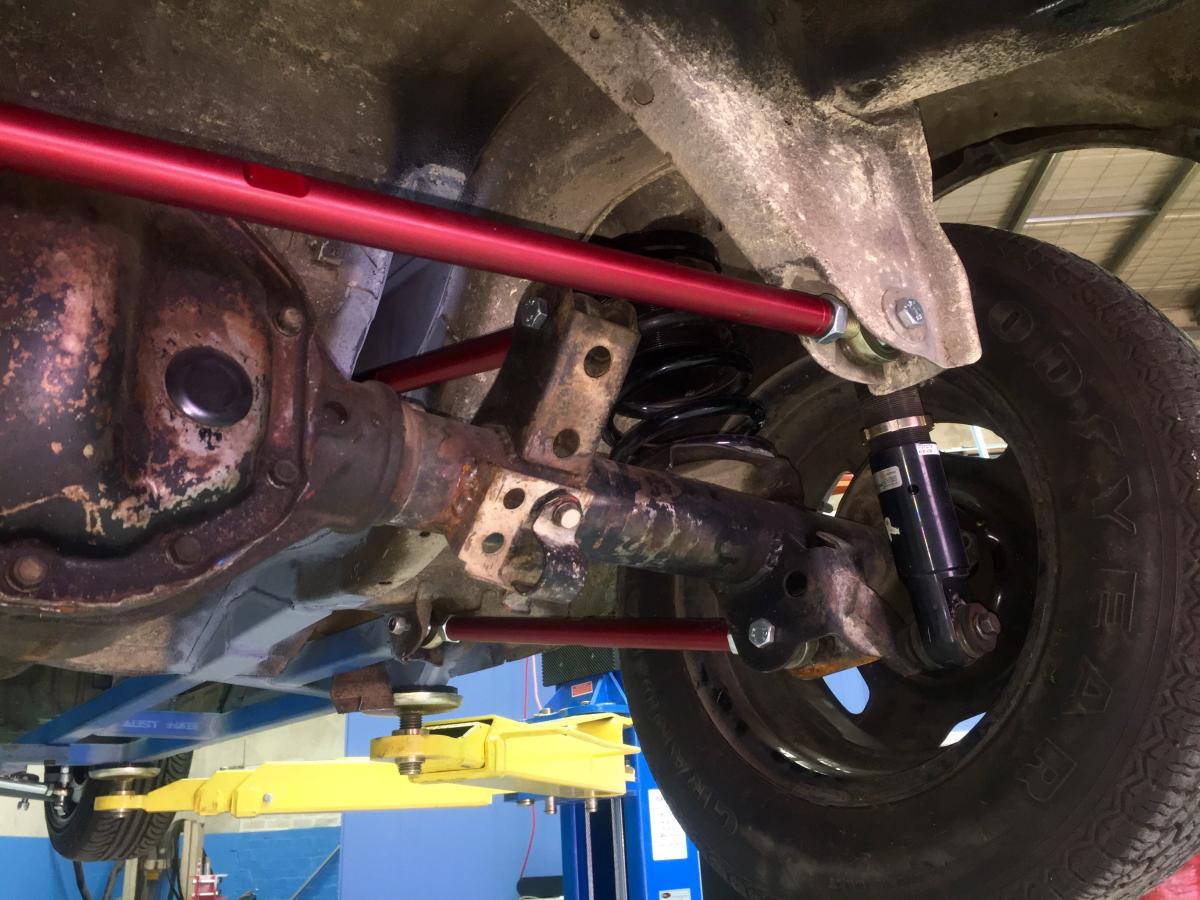

  10. Finally got some time to get the solid mount suspension on. Worked well considering I've never turned a spanner on a Corolla but bloody great car to work on There's a few areas that strength looks like it could be an issue now that there are no bushes in any of the suspension except sway bar links and will most likely either crack or hopefully not tear sheet metal. Next on the to do list is to get some spare 2mm or 3mm sheet steel and begin looking at what may be weak and benefit from some strengthening welds.

  14. A well matched turbo will make up for slight lag with a good torque curve. Depending on the use of the car a gearing change may be needed to keep the turbo in it's efficiency range and minimise off boost time. Under boost/ spool can still be strong torque and drivability too

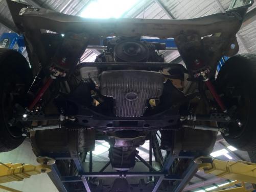

  16. Final piece of the puzzle has arrived. Shouldn't be bending the tie rods any time soon! Turbo pipes have been dropped off to HPC and still needing to sort something out for engine fitment regarding the oil sump fouling the cross member. Leaning more and more towards doing a tube cross member

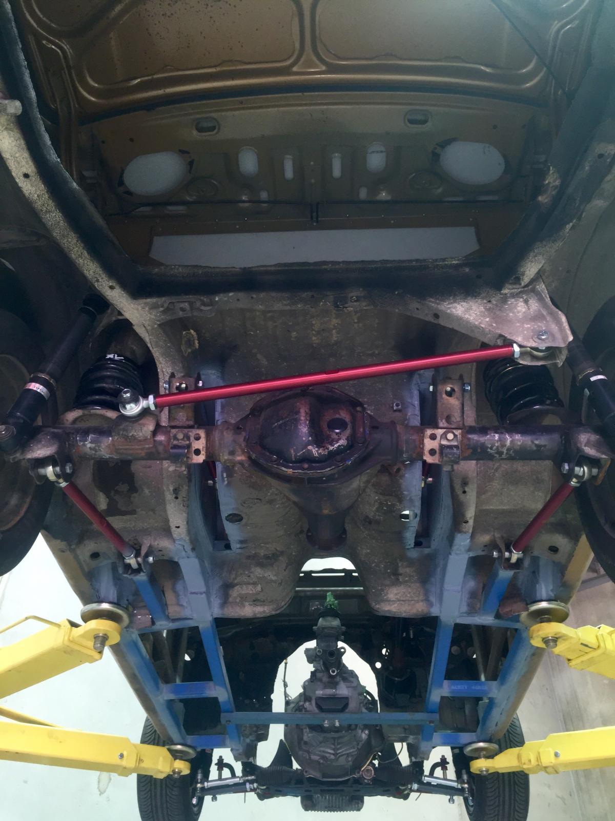

  17. The boxes are part of an equal 4 link kit where you cut the floor pan to replace the shorter top link bars. This is to correct pinion angle and aid traction. Big learning curves ahead but the kit is well though out so should go together ok with a bit of planning on my part https://technotoytuning.com/toyota/ae86/equal-length-4-link-kit-ae86 This some one elses set up if that helps
