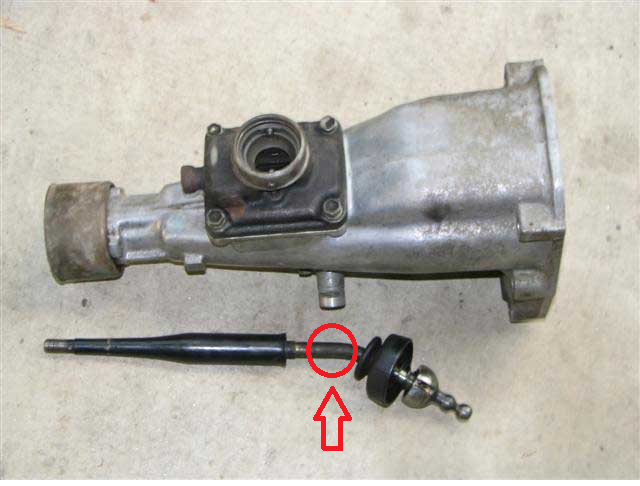

  18. Can someone do me a quick solid and measure the OD (outside diameter) of the shaft (ha) thats circled very poorly in the attached image? I may have forgotten to do so before I drove 6 hours away from my kesev. preferably from a k50 box, dunno if k40/50/t50 are all the same Thanks
