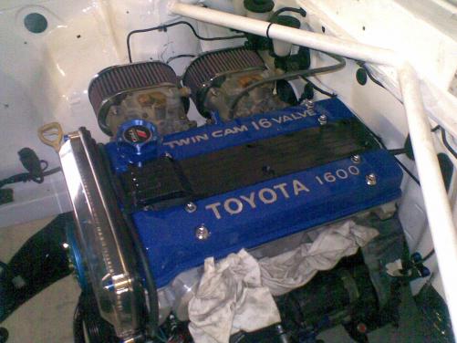

  2. thanks guys, we are getting there slowly. Tony managed to get the front of the engine all buttoned up, so we are getting closer to starting the little thing. sorry about the photos, were taken with a phone.
  3. Today was pretty good, seamed to get lots done. Tony finished the oil cooler lines and degreeing the cams, so the front is almost ready to go together. I made the accelerator bracket up,modified the rocker covers and painted them, then finished off making the thermostat housing blanking plate and a couple of gaskets for the water outlets. Also installed the oil return hose from the head and modified it to take the breather pipes. Carby's were bolted up for the last time hopefully, and then new air cleaners fitted. I'm thinking it'll be ready in a couple of weeks to start!!! :yes: Oh, and we should have a new chrome rear bumper by then too!!! 1KG battery
