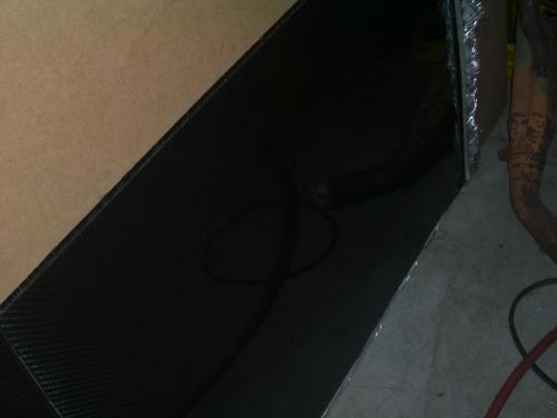

  1. Both front door panels are now done and just need to be fixed to the doors. Have started on the rear door panels, hopefully they'll be ready to cut out tomorrow(Sunday). Then we'll mould the rear panel, have something special planned for that!!

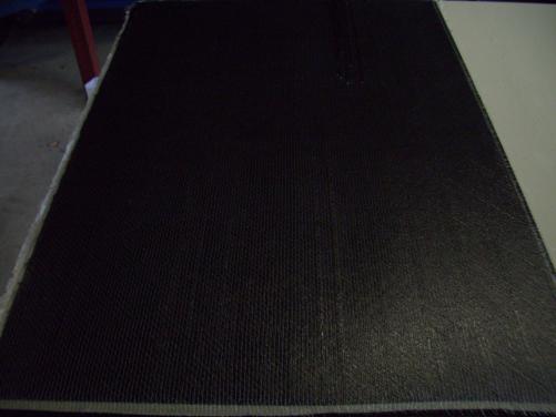

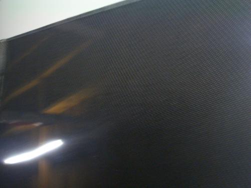

  3. We have them already, left over from the old car. Just got back from Tony's with Teddy, we were checking out how the CF came out. Doesn't look bad at all, better than i expected.

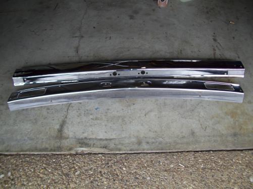

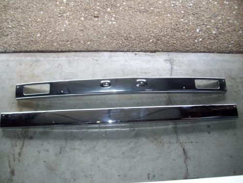

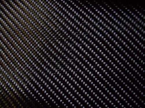

  5. Started the carbon fiber door panels today. We'll see tomorrow if we got everything right. Also have pulled the new chrome bumpers out and have started looking at making the moulds for them as well. They'll be fiberglass cause i can see them getting f@$ked very quickly and often. :lolcry: Carbon fiber is pretty!! :yes:

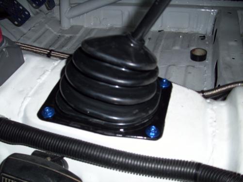

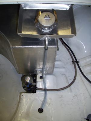

  7. Teddy and I done a 7k and W into his Ke70. Had to mod the sump, but i think it was only a small mod to the area behind the main bowl. The engine mounting bracket also had to be cut,i think it was the left one for the engine to sit nicely on the x member. Had to make up a gearbox x member for the W box and take a little out where the gear stick come through, but there wasn't any tunnel mod's done. Oh and you'll need a AE71 pedal box for the hydro clutch that the W series has. It's a very had reving 7k, has dellorto's, cam, head work and extractor's, rev's happily to 8000. But the torque is huge. We also replaced the rear end at the time with a T series too. Hope this helps, Teddy maybe able to shed some more light it.

  12. Na, Even, had a Ke70 with the same problem!!

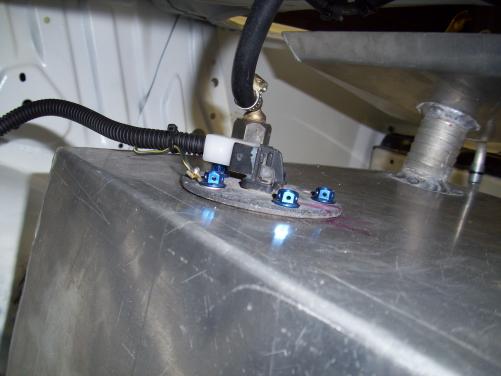

  13. Got a few more jobs done today. Tony finished re-torquing the head. Myself, i spent the day doing some little jobs around the car. Like fitting the gear stick (after cleaning and repainting it), cleaning up the inner guard protection and replacing the door hinge bolts with alloy ones. The diff breather has been cleaned and fitted and the fuel tank piping and wiring has finally been finished, everything works great.(thanks Des)

  16. Yeah, i still have my A/C vac pump, that's what i was going to use. We're hoping to get our stuff next weekend, i can get a price on the4 kevlar for you then. Good luck with the light pod, I know Marius had some fun with his, but the mould looks great now. Our door panels won't be flat, they need recesses for the door handles, so glass is out. Thanks all the same Rob.

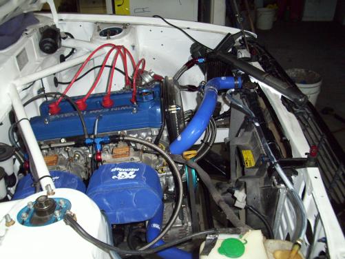

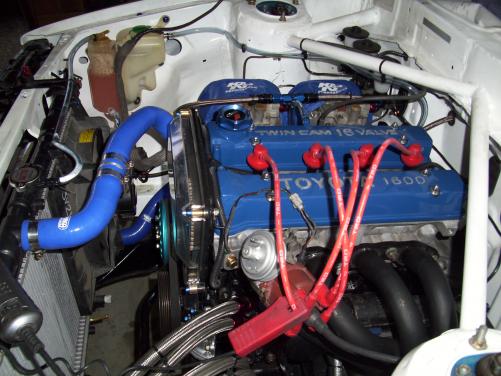

  19. Was covered here as well. Gears

  22. Thanks guys and thanks Des for the tank unit, it's all fitted and works great. I also hear there maybe some uprite stuff coming up for sale soon!!!! :yes: Stay tuned.
