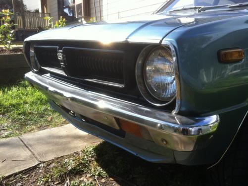

  17. Ok so i had today off work cause i'm sick with the flu, however i couldn't sit still knowing my rolla could be being worked on so i sucked it up and got to doing some more cleaning work mainly the outside Firstly i set up some temporary accomodation until i clear space in the garage Then i looked at the paint and relising that it was i pretty reasonable condition i decided to give her a polish Then decided that no polish is complete without a wax job so out came the wax to make her real shiny shiny :wink: After that i was stillfeeling like shit but thought oh well i'm already out here so i went up the road and picked up some of my favourite cleaning ingredients AutoSol FTW and got to work on the bumpers They came up pretty good so i moved onto the wheels. Much bigger job than i anticipated so i gave them a quick once over, theycame up pretty reasonable but will pull them off the car down the track and get right into them I used a toothbrush to get to those hard to reach places LOL but i reckon it would have been much easier if i had a 'flip top head' :laff: Anyway, let me know what you think
