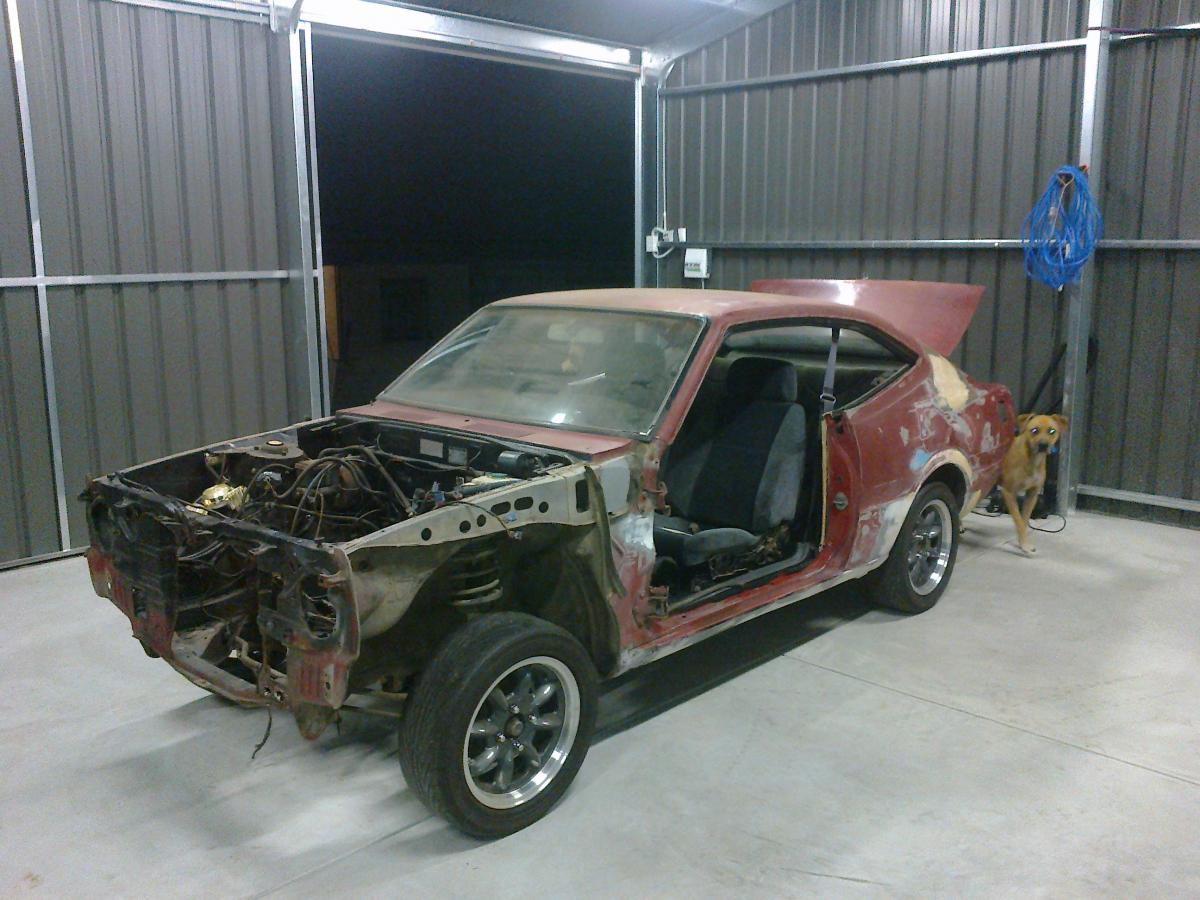

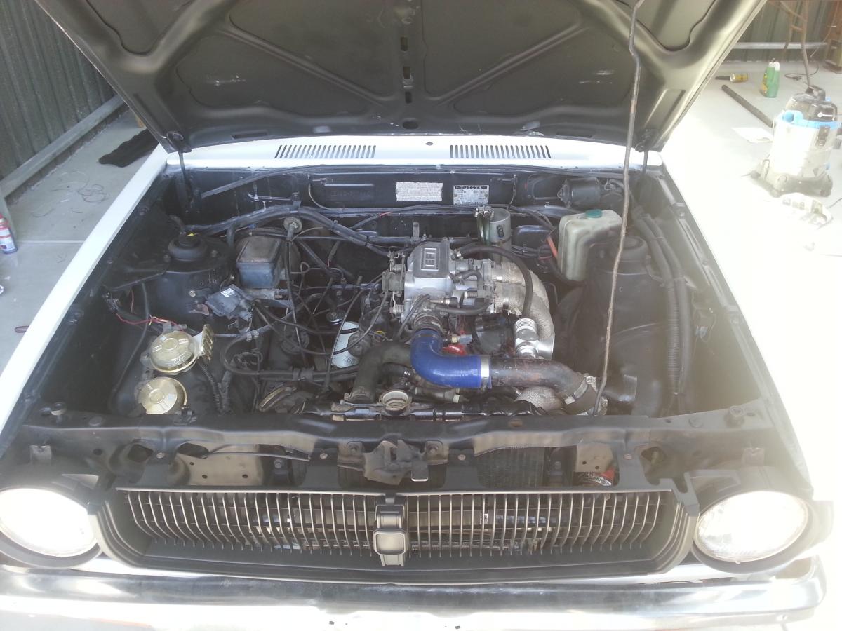

  8. Well over the weekend i kept busy, I added the oil to gear box and motor, connected all the components of the engine. added coolant and new oil filter and fuel lines and filter. put a battery in the car with some fresh fuel.. and after a little tweaking of the dizzy the beast came alive!!!! although it has really loud tapping noise...I'm guessing ive got too thin oil in the motor.. I'm very excited that I'm 95% complete.. just need to get a tune, tires and rego and she is good to go! ive added a pic, sorry its blurry it was a bright day. I am hoping to have the car complete by the end of the year but with Christmas sneaking up so quickly the funds are not in my favor.

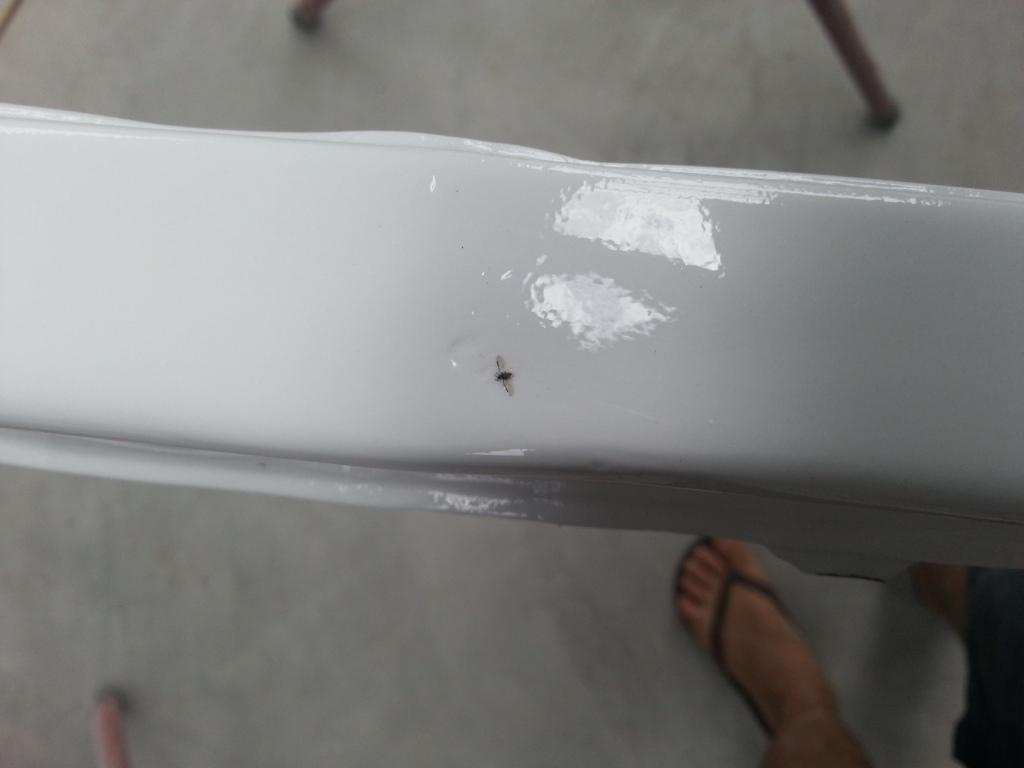

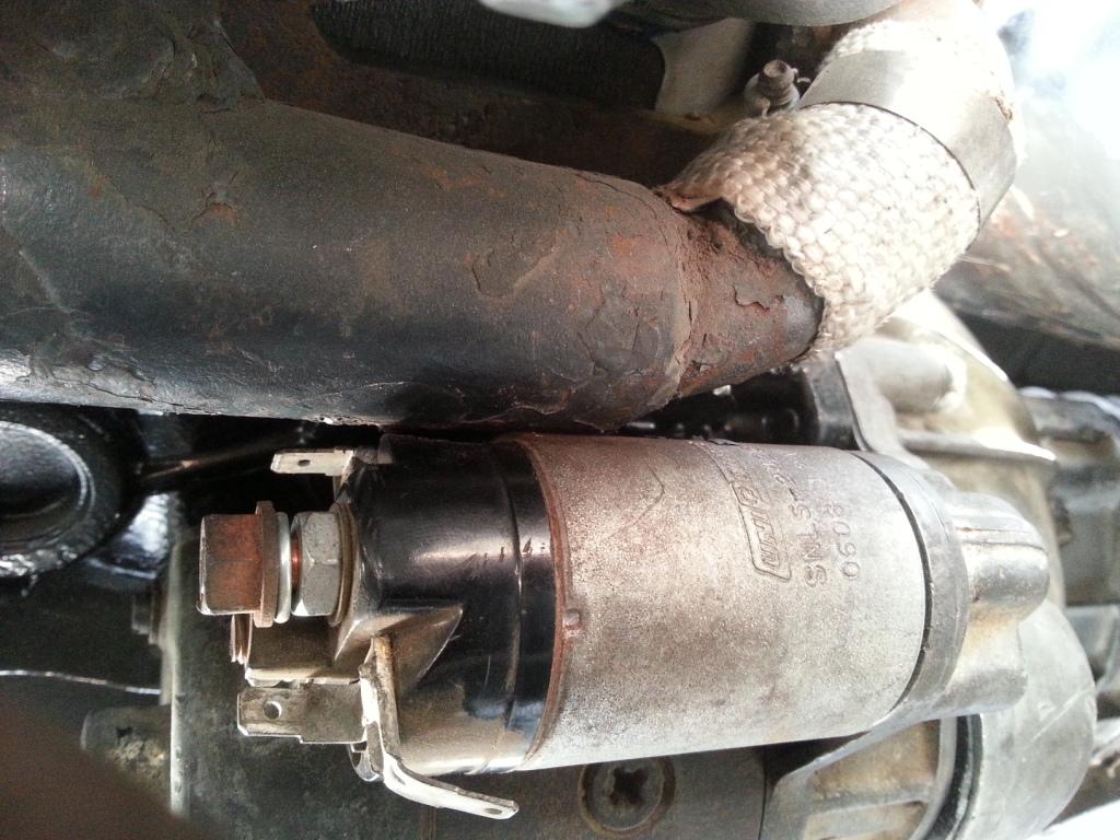

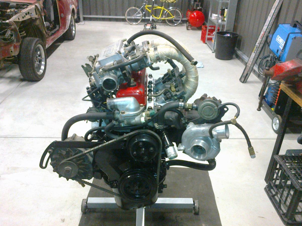

  9. Well since the good weather i have been getting down and dirty.. the pics will show you... So the pic with the bug.. he was being sneaky! the pick of the starter motor is quite close to the manifold.. it'll most likely burn out so ill need to modify the manifold. Thanks - Gerard

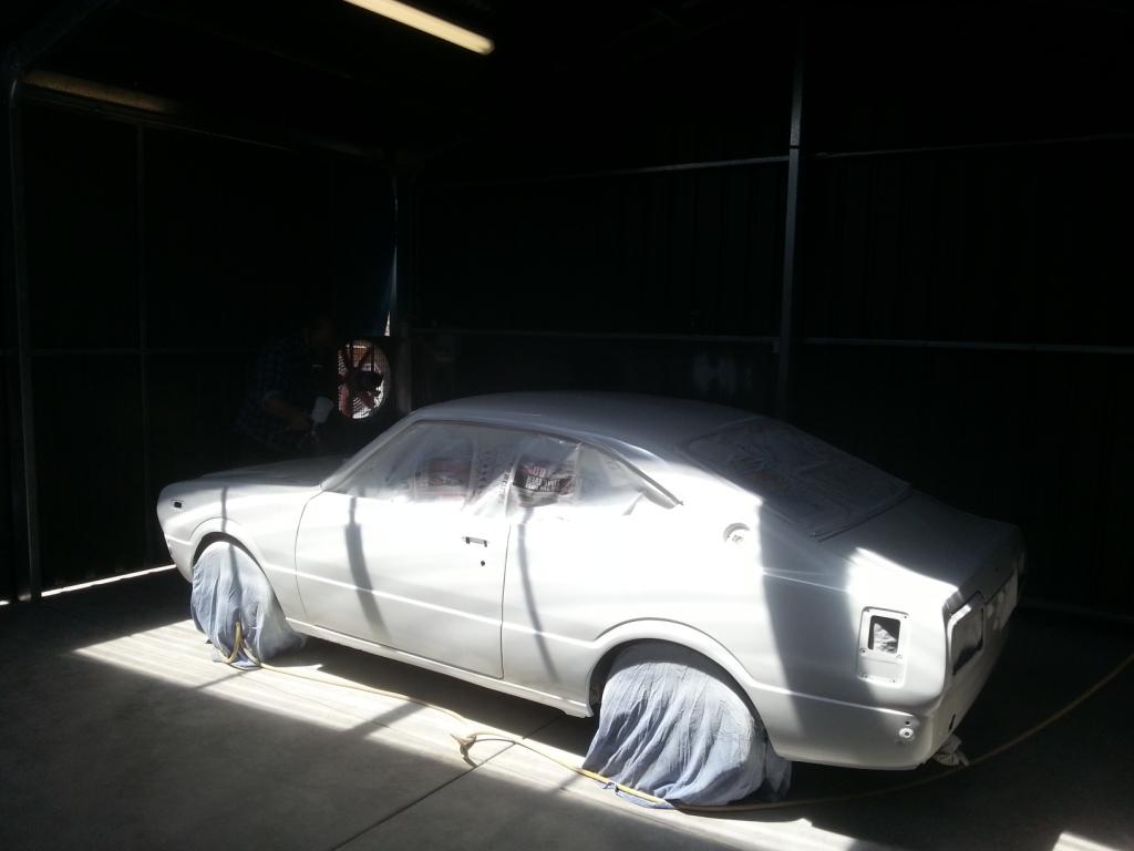

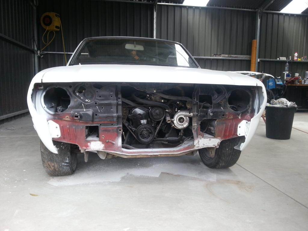

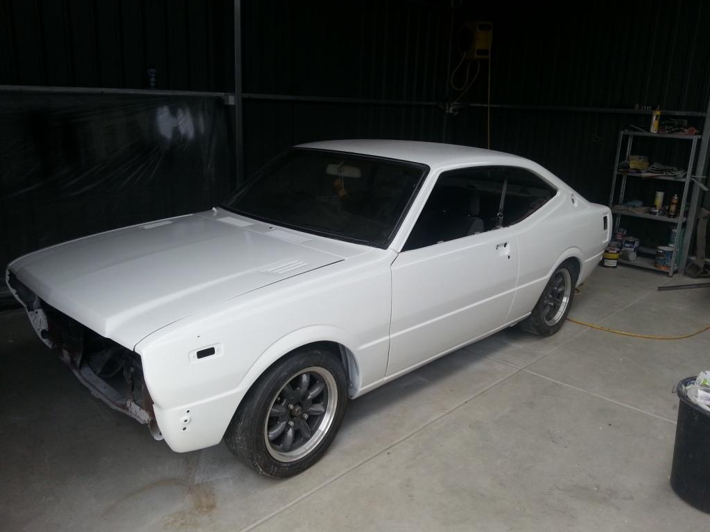

  10. Just a quick little update.. Ive been sneakily working away on the car... guards, 1 door and bonnet are ready for topcoat. Other door, boot and body are almost ready for primer. and then ill be painting it the next nice weathered day.. well inside all the doors so then i can put everything back on the car and do a spray. I can't WAIT!! ill try and upload some piccies if my computer lives... and also have a surprise for the rolla club members but that will come later! ;)

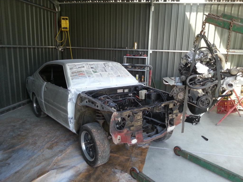

  14. Well its been over a year since ive posted on here, and no the car isnt done! ive since moved house and buit a shed to work on the car! i am now getting stuck into it. the motor has be built with the standard cam and the new turbo. Time to start getting into the body work! i want the car painted and running but need some patience!

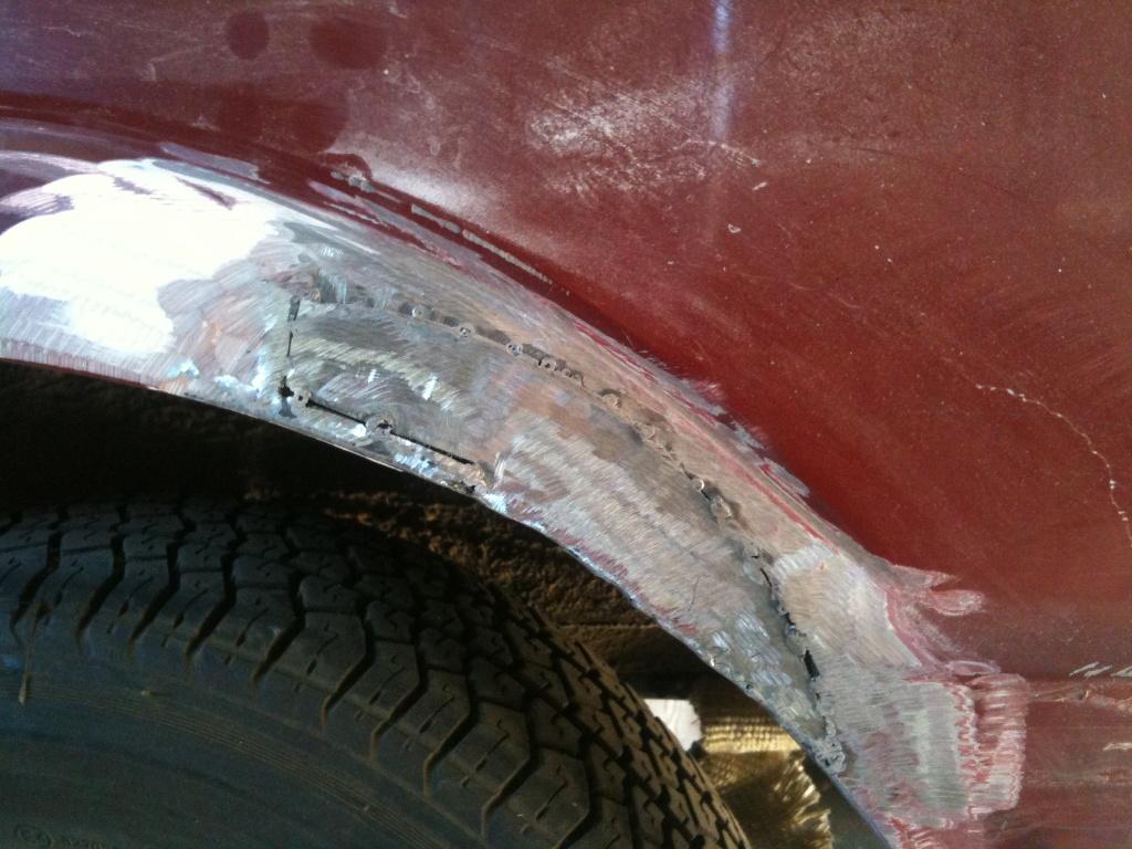

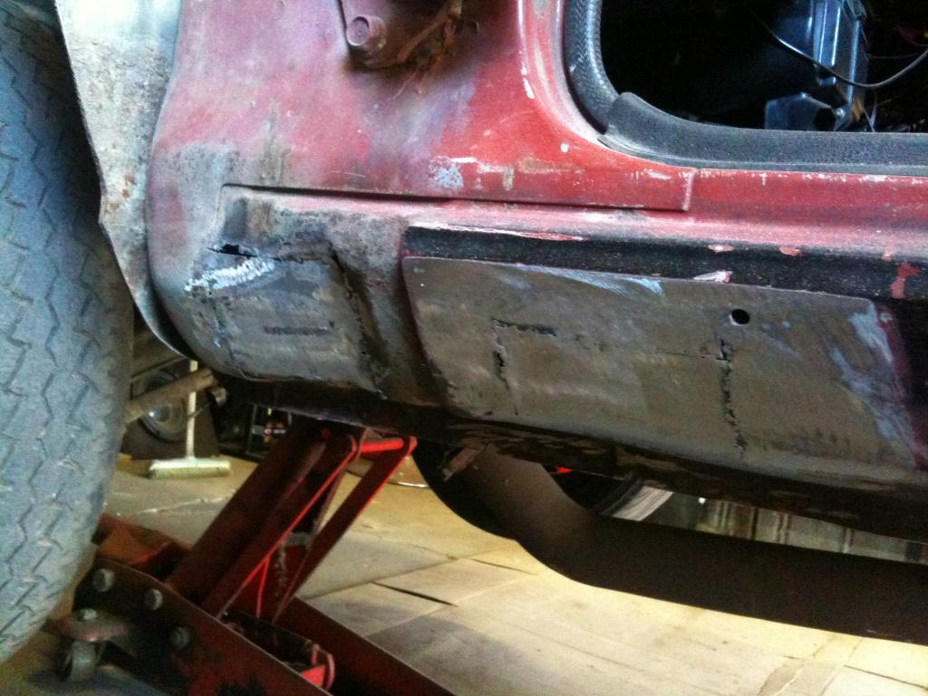

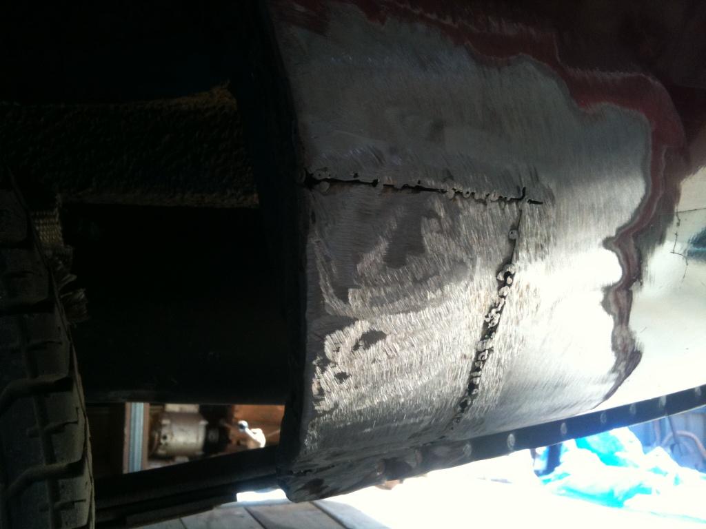

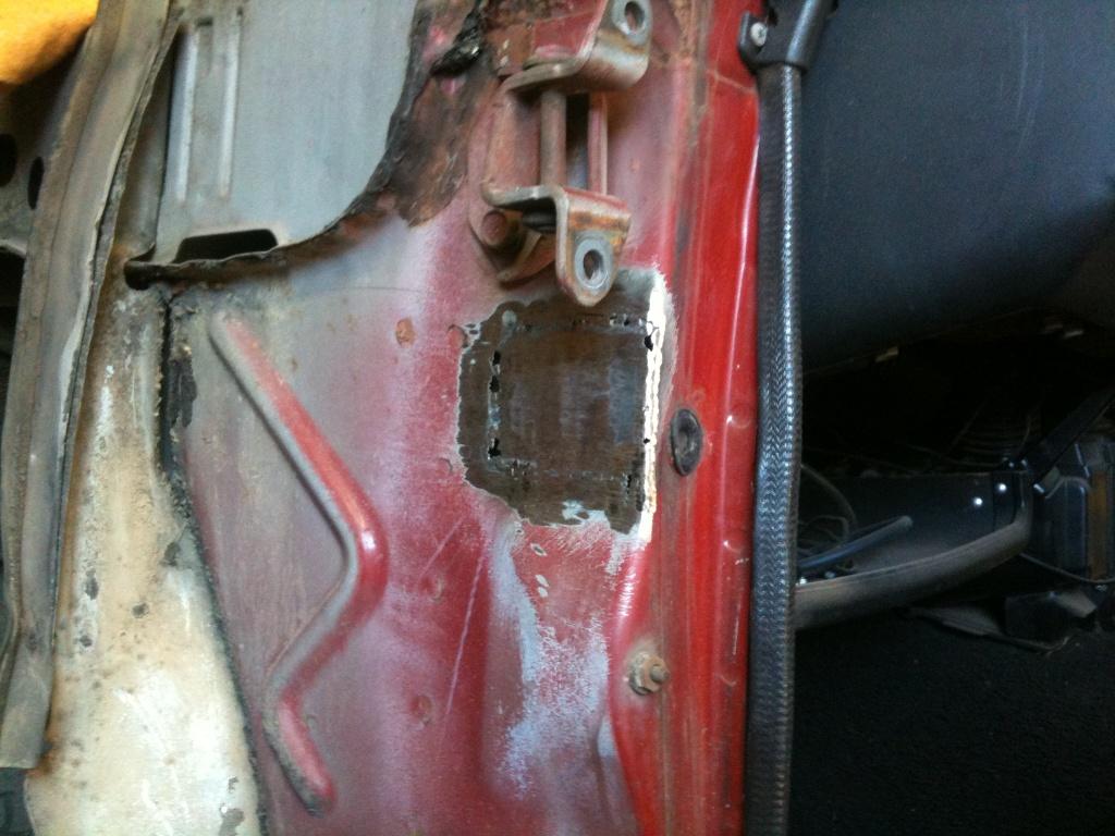

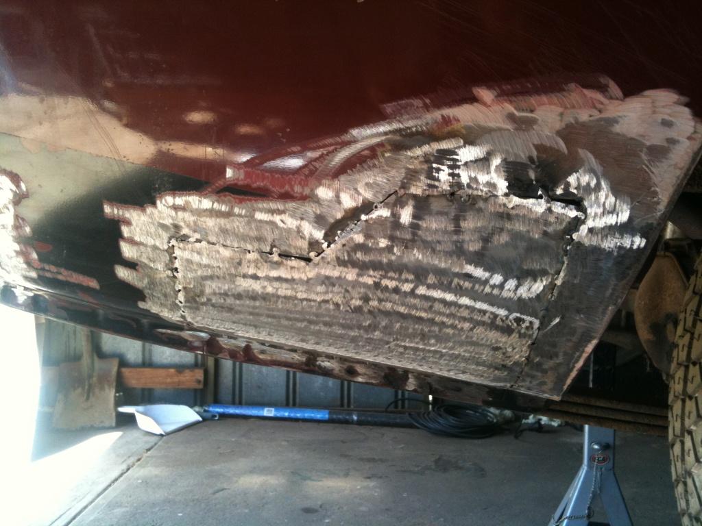

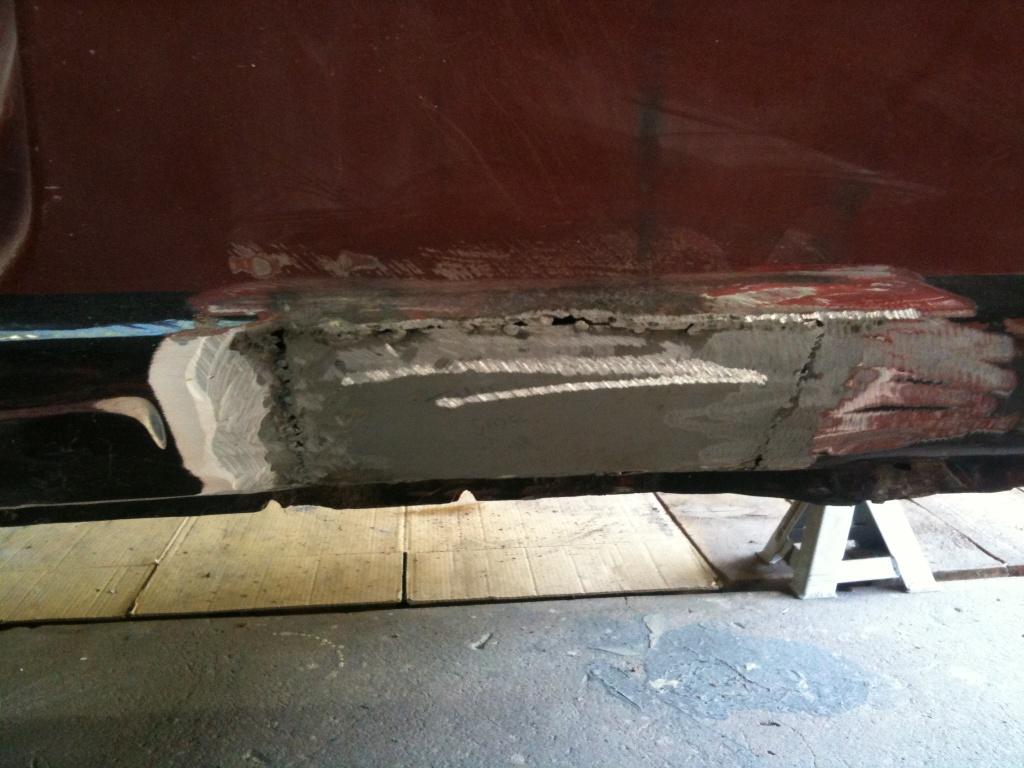

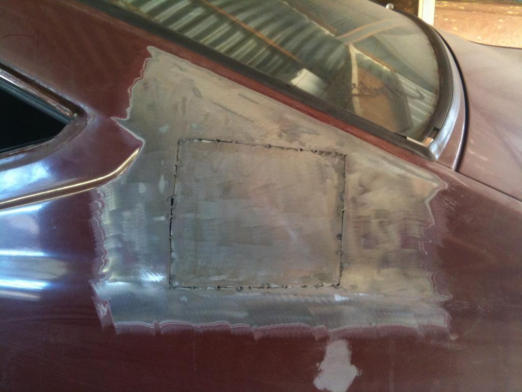

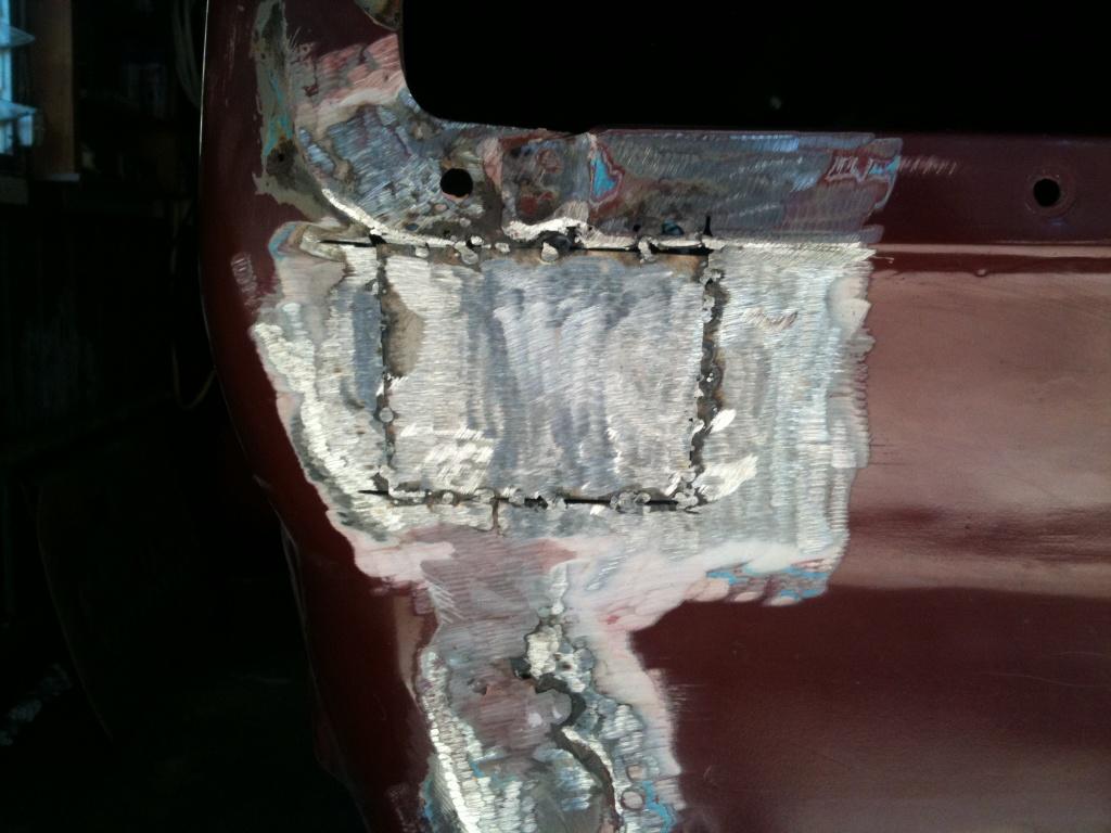

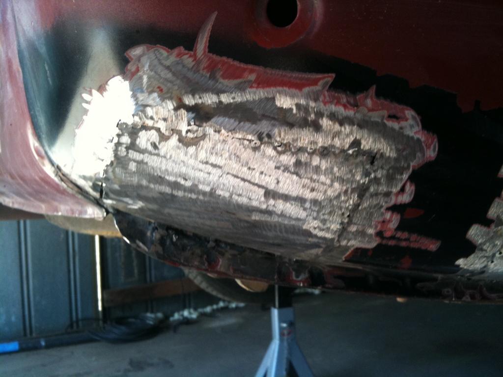

  19. Well all the welding is done on the panels now, next step is to fiberglass them all for the added strength and fill in the holes. all the steel had to be tacked in couldn't do full welds, would blow through too easy. but all panels are strong. Here are some pictures, everyone likes pictures.
  20. i've seen them pop up on Ebay. I got mine from ebay for $250 and i saw one on there not that long ago i recon.. just an option i guess.

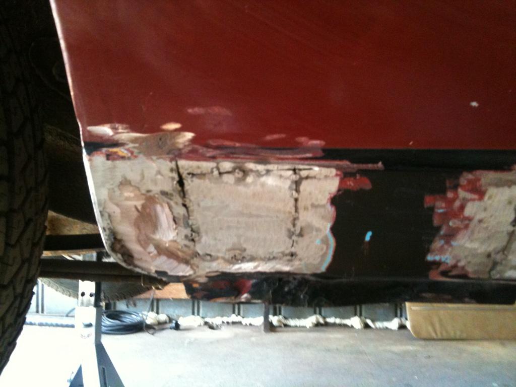

  21. Well got some process done on the car this weekend, Dad came over and gave me a hand doing some welding. managed to get one side of the car done! i'm quite happy with the process. we couldn't get full welds on the panels just alot of tacks. but enough to make it solid. once ive finished welding the rest of the car ill fiberglass the panes and then bog it all up and fish oil it.. which wasn't done when it was fixed the first time.
  22. Yeah good point, just the trouble tho as soon as the weld sparks it blows the hole! ill just have to find a good setting! Thanks everyone for the useful tips! -Gerard
  23. Yeah gasless is messy with all the splatter, the weld its self isnt too bad! but like you said nothing really beats gas shielded. i might have a suss and buy those little bottles from the tool shops and give that a go. But at the end of the day practice makes perfect.
  24. its a cigweld 150. i think it ranges from 41A to 130A
  25. well ive got 0.8 wire going through. i must be doing something wrong i mean don't get me wrong ive welded plenty before. just need to practice on the really thin metals. maybe i should get a small roll of 0.6 wire? so you recon gasless is ok, or is my welder too big for car panels and thin metal?
