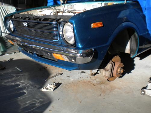

  7. Bit more progress, the front is nearly finished. I pressed up two pieces of 3mm the same profile as the corolla control arm 40mm long and welded them in. Then i just had to re drill a couple of holes to suit the new length. Then fitted the rings to take the commodore ball joints and painted em up. I couldn't get a very good pic of the strut in there because the sun was setting i stuck the wheels on and the camber is spot on, i have a way bigger choice of rim now which will be good. The only thing i need to do now is make longer steering arms up then clean up and paint the struts with lowered springs. Gettin there...
