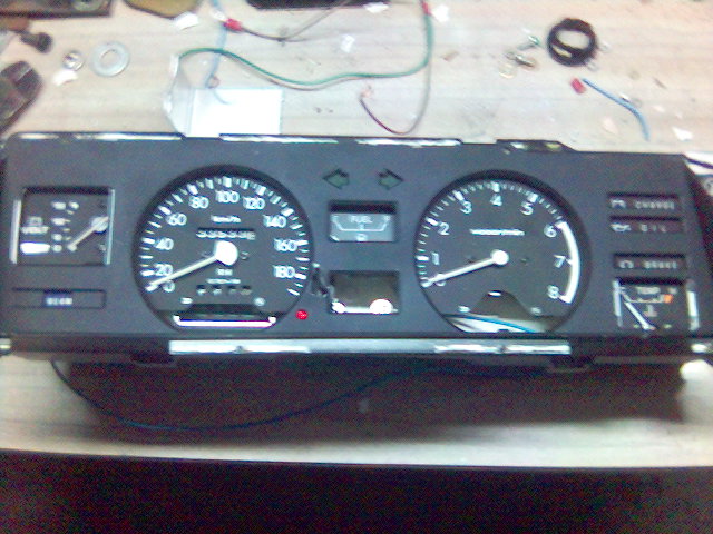

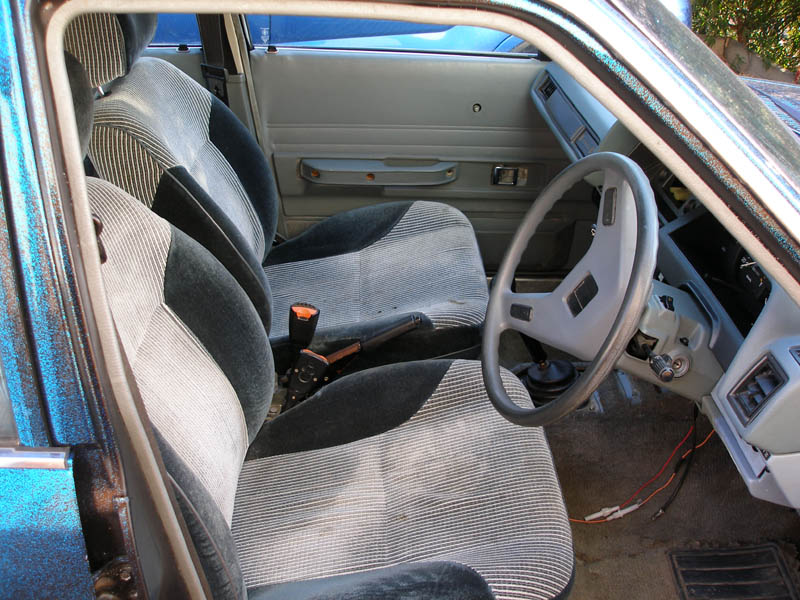

November 9, 200620 yr Author comment_150279 i havent updated on here lately. i should have rego next week once i get my blueslip. not much has changed, but i update more regularly on tc.org anyways. heres the seats i got last week and heres what i did last night thanks to the info on this forum ;). who needs an ae71/ke70 tacho cluster when you have a spare t18 one, looks heaps better Report
November 10, 200619 yr Author comment_150351 well thats only the guages from the t18 cluster. they pretty much bolt right in, but the temp gauge doesnt fit with the speedo and tacho. maybe i could have trimmed them, but i wanted to move the temp guage anyways. Report

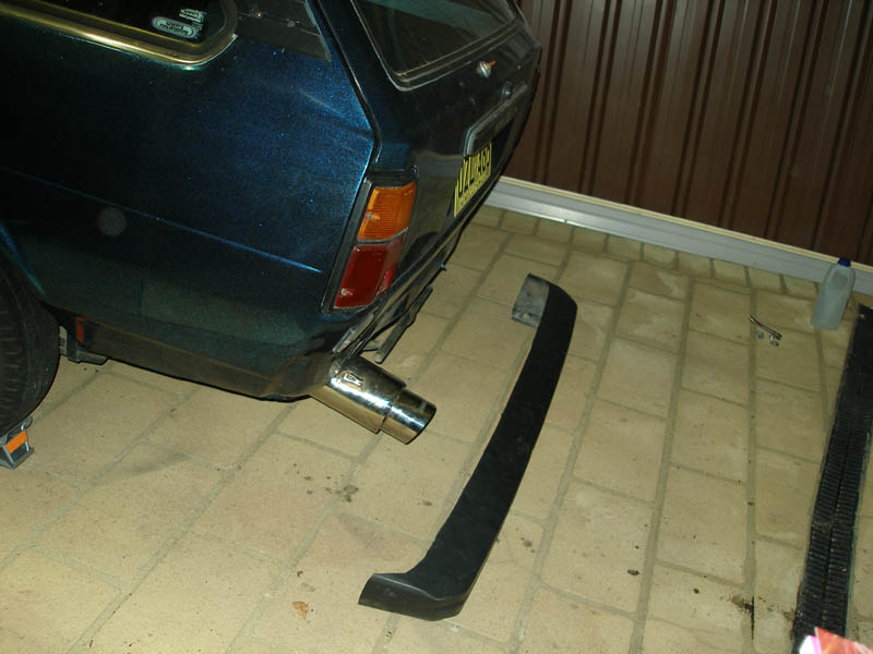

November 29, 200619 yr Author comment_152891 now I'm about to get ready for a blueslip finally. the rust holes are fixed, and almost everything is perfect. except i don't think theyll like the air cleaner, nor the exhaust. but heres some extra info about the seats for slapper. the seats were from an ae82 csx. i used one ae71 rail, and one ae82 rail on each seat, i think the inside ones are the ae82 rails. this was because the floor is too narrow to fit both side mount rails in. to get the seats sitting correctly i had to cut the outside rails off, and screw the support brackets back onto the seat base, the ae71 rails bolt straight into the seat base, so it wasnt too difficult. they pretty much go straight in with a bit of thinking, except i couldnt get the adjustable base to work, so its not adjustable now. if you want to know anymore just ask :y: heres the exhaust... Report
