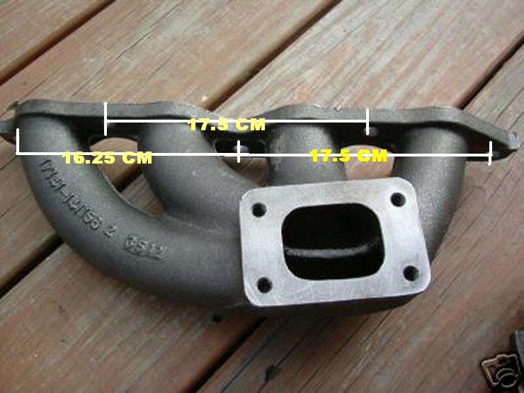

can you take a picture of the manifold with measurements photoshoped in?

So you have a 20v and i take it you bought a 16v manifold, You have to drill out the hole to make it fit a 20v.

I just did a few measurements on my turbo manifold which i have had bolted to my bigport with no probs, All measurements are centre to centre.
Pic:

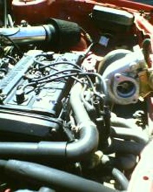

Its a HKS manifold, I got it from a guy in the states brand new with a T25/28 (still havnt been identified) also brand new, I got it as i thought it might of worked in a FWD Format but the turbo hits the motor and then the radiator if you turn it around, I will try to get a pic of it mounted on the car tomorrow.

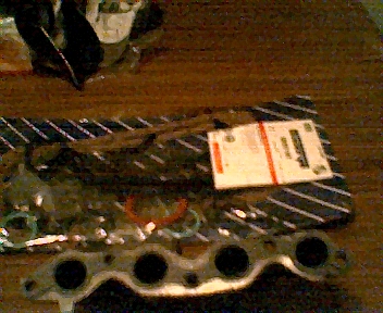

Is this what your after, Its of a 87-91 4AGE/ZE exhaust gasket sitting on the manifold, The pic is really shitty as i took it with a mini digital camera which a mobile phone takes a better pic.
