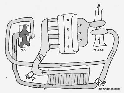

onto my own wee project. was originally considering a non intercooled SC setup so that the sc was a simple bypass in the pipe between intercooler and engine. i was hoping that a low 8.0:1 compression ratio and water injection at higher temps would be sufficient to stop any chance of detonation on a lowly 10psi from the SC.
my current 3tgte ct20 in the ke70 coupe creeps up to 13psi non intercooled.. and i know how damn hot the intake pipe gets just from heat soak alone.. thankyou toyota for 7.8:1 compression and 10:1 a/f haha. hmm wander how quick the intake air temperature sensor is to read the constantly changing air temps! this could be an issue so a fully intercooled system always going to be better
original planned like this:
after having a good look at the piping of that twincharged evo9 in Colorado with a friend luke (also looking into twincharging, but with an sr20ve 160J SSS coupe) we figured a way to intercool both chargers without too much complication or clutter in the engine bay. by entering the intercooler from two ends, and all piping can be kept low for appearance sake :P pipe from turbo to supercharger tucked away behind bottom of radiator. This system has longish pipes before the supercharger but shortest possible piping after which should help with supercharger response, and who cares about turbo lag as we're already on boost woot!
on the water cooling side of things.. the 20v water pump could be used on a supercharged 20v, but with modified water intake pipe of course. I'm wanting to get rid of any rubber hoses if i can just for reliability sake. especially ones hidden behind supercharger! so the 16v 4age water pump and steel intake pipe suits my wants, BUT the intake pipe hits the supercharger if from an n/a 4age, whereas the supercharger one obviously doesn't. (pipe is bent differently). that in mind, rather than source gze parts which could be a bit more expensive to replace later on.. have opted to make stainless intake pipe and just a redtop 16v water pump.. something common woohoo
Edited by AE25

Another idea relating to induction design (if you have the room): operate the supercharger and turbo completely independently of each other. Run a blow-off valve on the supercharger side. On the intake plenum, mount a throttle body on each end, with two stroke style reed valve after the throttle bodies on both ends. On the turbo end have a blow off valve set up to work in reverse. How it could work is at low rpm, the supercharger will make more boost than the turbo, so on the supercharger side the blow off valve is closed, and the air is blowing into the plenum on the supercharger side. The turbo side has the blow off valve open, allowing it to build boost. The boost pressure is trapped in the plenum by the reed valve on the turbo end.
At high rpm (or whenever turbo boost > supercharger boost) the supercharger blow off valve opens venting boost, the turbo blow off closes, pressurising the turbo induction side allowing boost to enter on turbo side of plenum, the reed valve on supercharger side closes trapping boost.
The problems would be having to rig up cables for two throttle bodies, room and flow restrictions caused by the reed valves.
You could do the same thing with a "2 into 1" pipe with an electronically controlled vane valve, and single throttle body. Actually, maybe a vane valve, lightly sprung to be in the middle (half open half closed on both sides) would do the trick.
