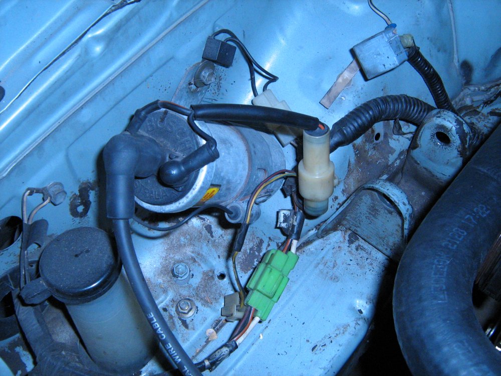

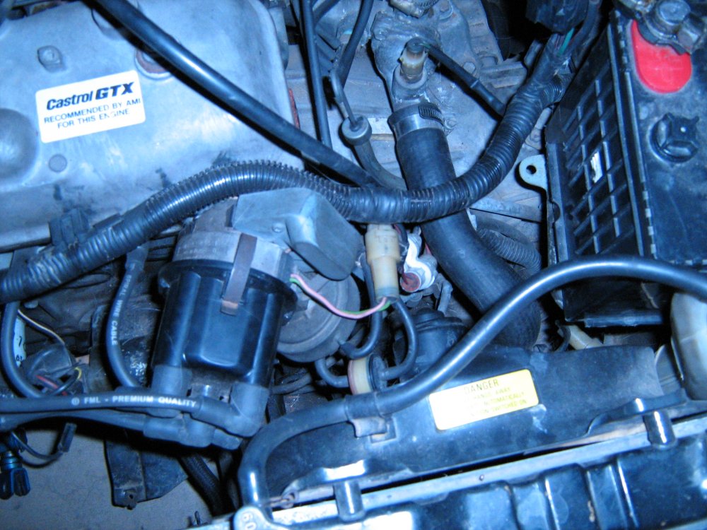

Its just a 2 wire system:
The coil is the same:

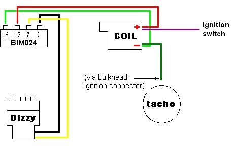

it may be a weaker spark than the point system. best off to use a high output 12 volt coil found on any 82-88 wrecked sigma, vh vk commodore, falcon or a ae82 here is the wiring diagram.
