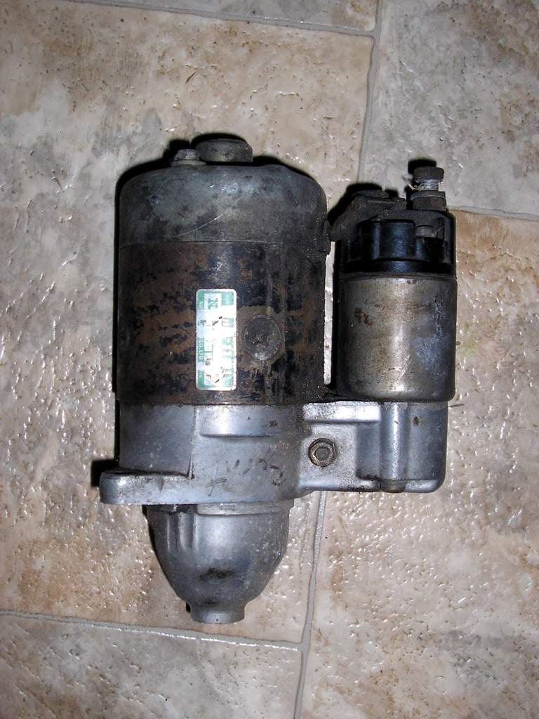

LOL the ND ke10 starter is shorter than the bosch one you posted Raven. The motor part is just a touch longer than the solenoid.
I have no doubt a reduction starter would spin the motor over a lot faster. I just haven't had any issues with the type I run now. If I ever run out of the smaller starters, I may change to the reduction type at a later stage.
