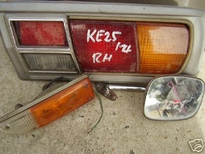

Just bought a new taillight off ebay today
