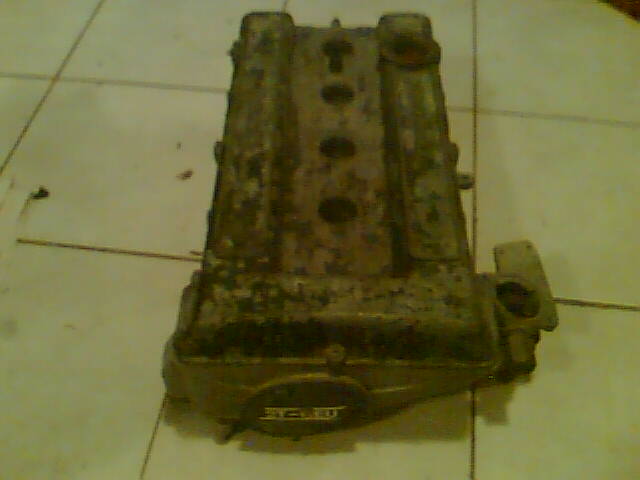

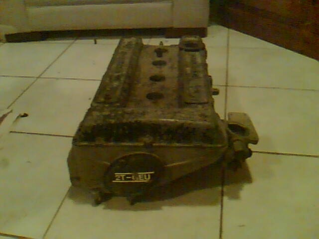

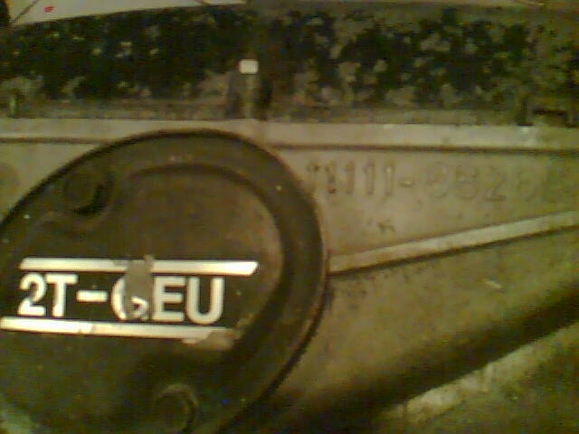

It's a 2T-GEU head (if you couldn't tell from the sticker on the front). This will be bolted onto the 13T bottom, with higher compression, bigger bore pistons (about 88mm instead of 85mm), giving me a twincam engine with 1897cc. With bigger cams & valves, extractors and exhaust I'm hoping to get it close to 200hp at the engine, or roughly 110kW at the wheels. It would be plenty of grunt for this car, as it's not intended to be super quick, but just a nicely modified street classic.

A 3T-GTEU? I considered going turbo, but ruled it out pretty quick. There's a 3T-GTEU head for sale on TradeMe.co.nz, but I don't think the twin-spark plugs will offer any real advantage, and I don't like the more modern cam covers. The 2T-GEU head I've got has a far more classic twin-cam look, plus a 1.9L revving to around 8,000rpm with twin carbs will be sweet and old school. :jamie:
nah twin spark does a bit for performance but not much, (higher power ignition does the job better eg. msd), the head looks like but its the 2 valves per cly that makes it shit. having said that, its been along time since I've seen that car, blue Celica with a sports seat, and i have never once seen it out on the road since it was all fixed up. can't remember if it was a 3T-GTE or 4T-GTE
they came from TA63 Celica, TA63 carina, TT142 Corona GT-T & GT-TR, 120kw 160hp @ 6000rpm, Double-row Chain, but limited sized injectors at 295cc's, turbo being a CT20 and produced between 1982-1985, there is still better engines out that are easier to find parts for and cheaper bang for buck that'll fit in a TA22 so i couldn't see any difference with a 2T like your doing
