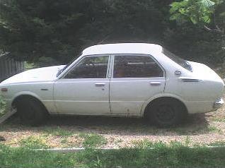

:y: hey guys, i know for all you ke30 lovers, rust is a big problem, at least, it is for me, what is the best way i can get the rust out?
