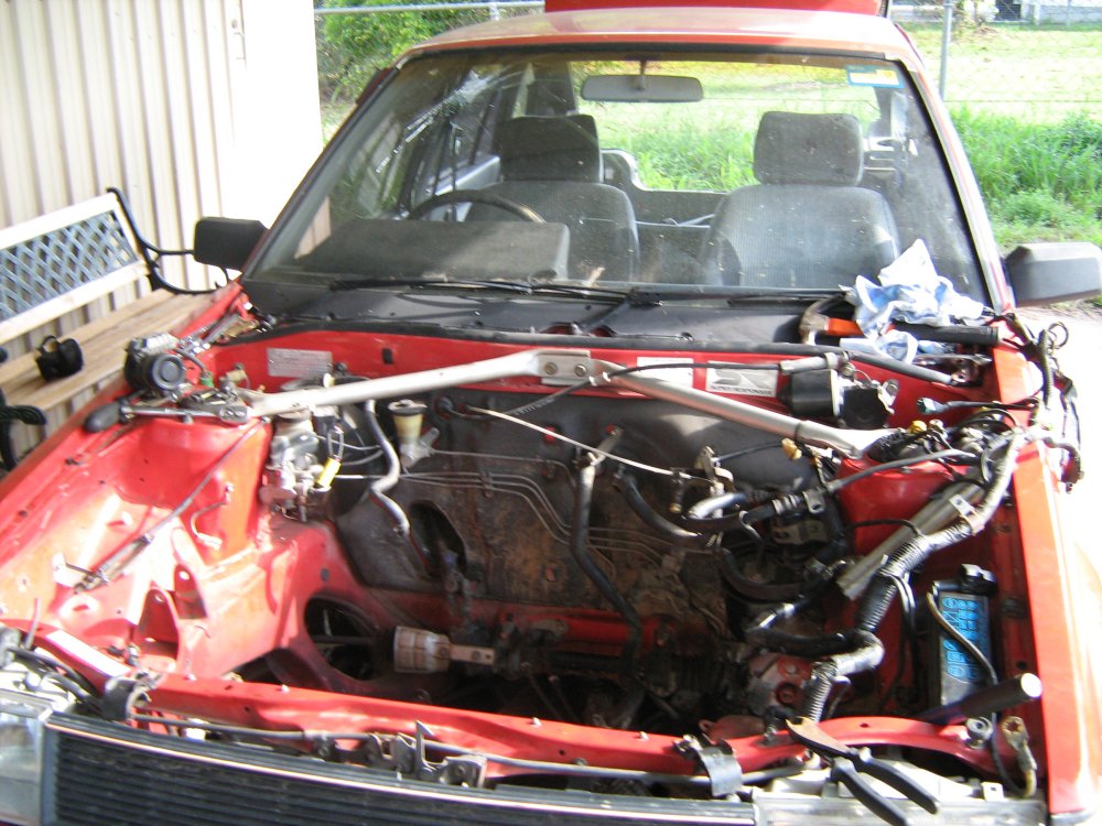

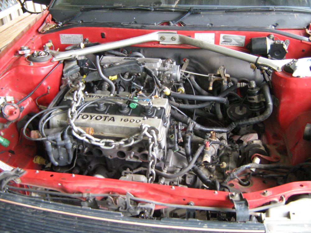

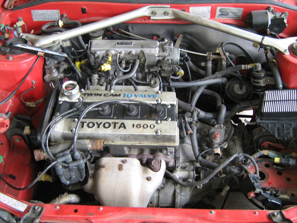

Few pics from today with the engine bay getting pulled apart:

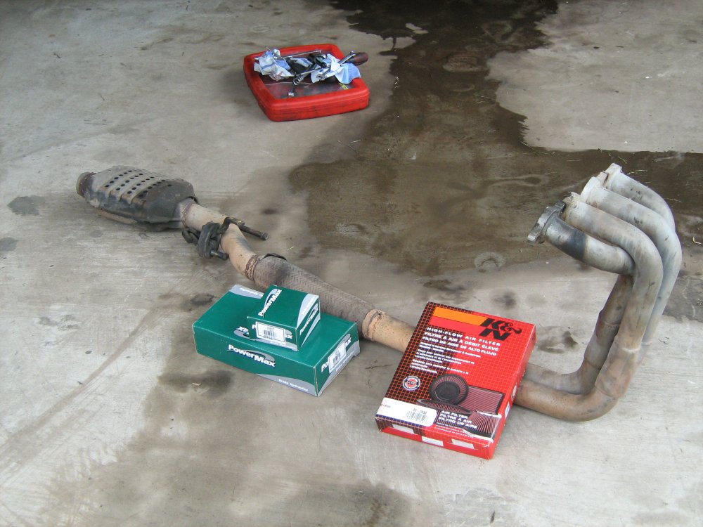

A few goodies:

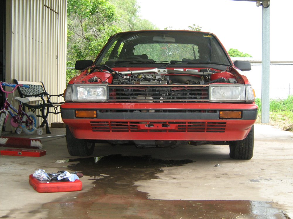

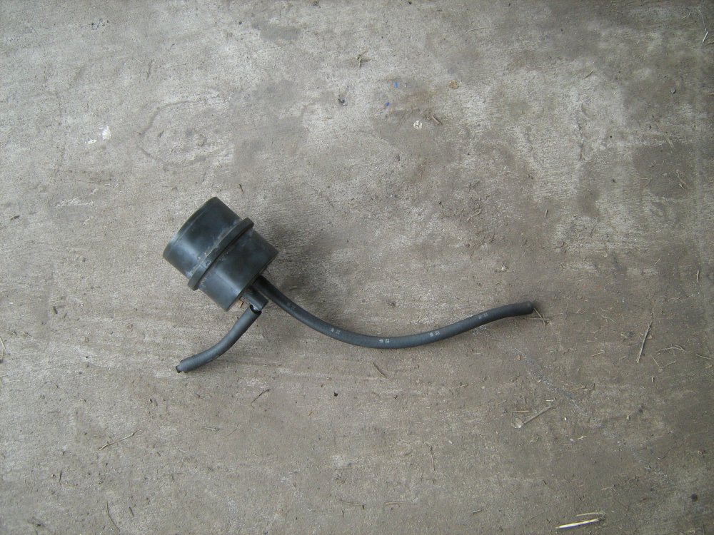

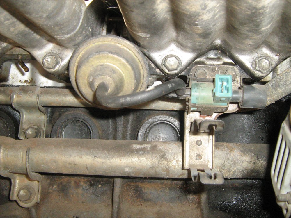

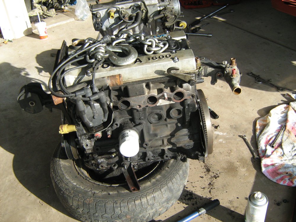

Did alot more this arvo, All that's left is the drivers side cv shaft and then undo the engine mounts and it will be out, I also noticed that my TVIS controller was broken off so all this time i havent had it and the car has hammered from take off and they reckon they are shit without it so I'm looking forward to that been connected, There is also a small hole in the bellhousing so hopefully i don't find too much wrong with it (now i wish i would of kept my C56), I will post some more pics up tomorrow.

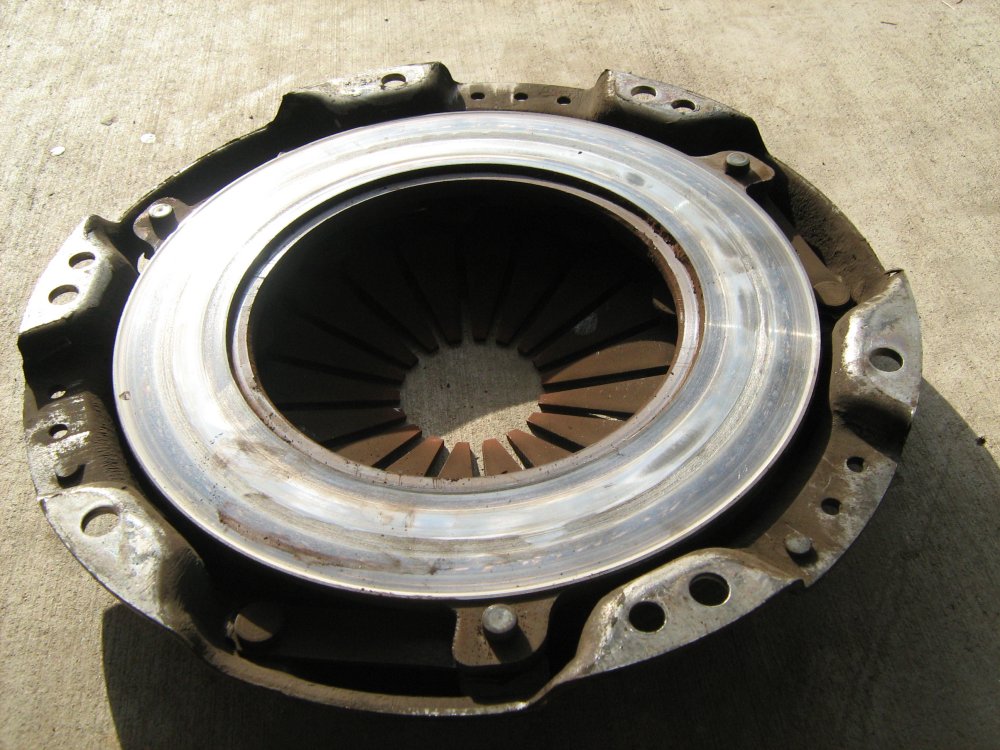

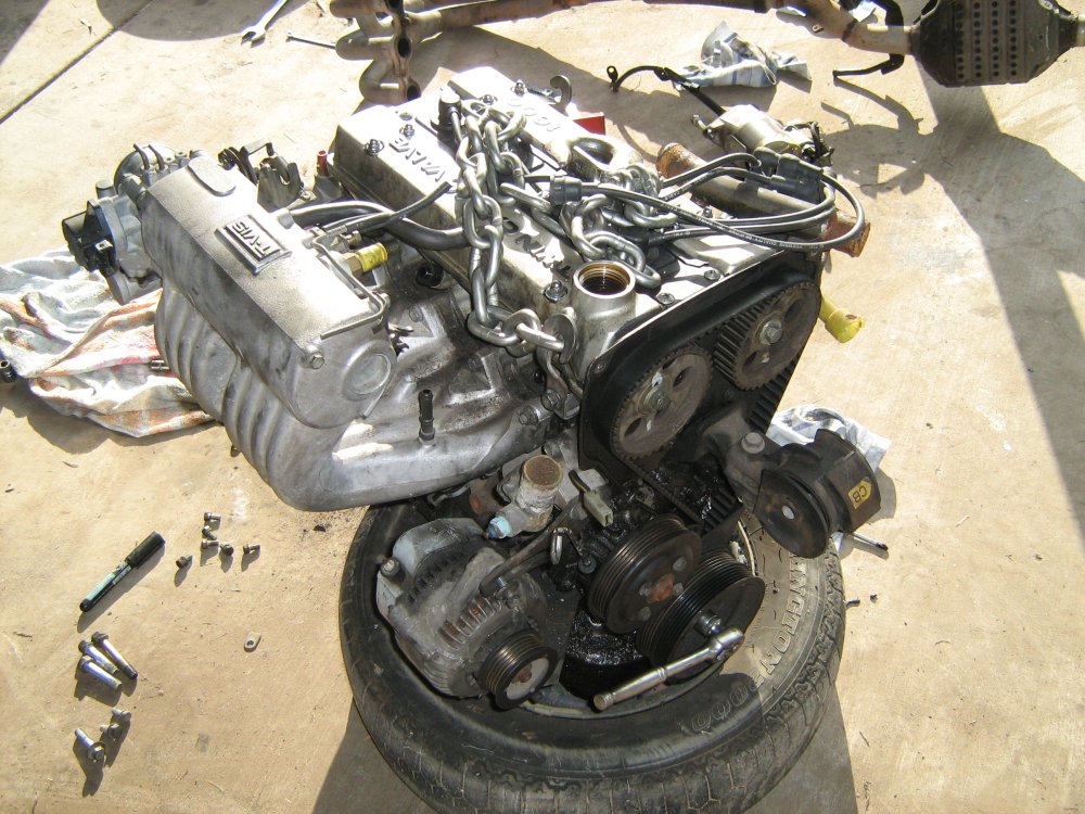

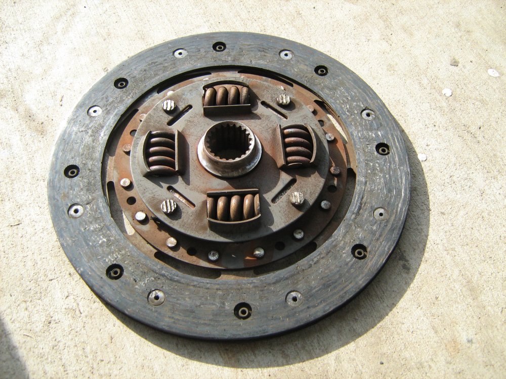

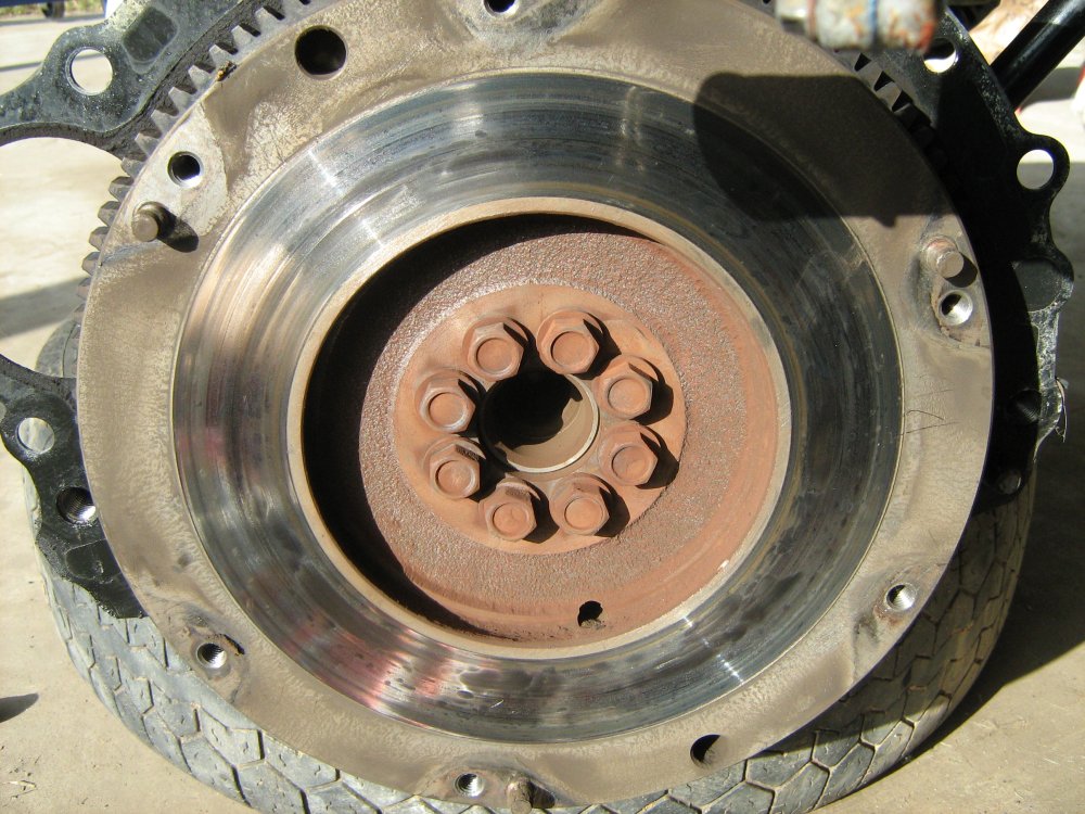

Engine is out and i found out why i never had a good clutch, I included a pic of the broken tvis section:
It never worked:
Reason Why:
High Spots
Badly Gouged:
Down To The Rivets:

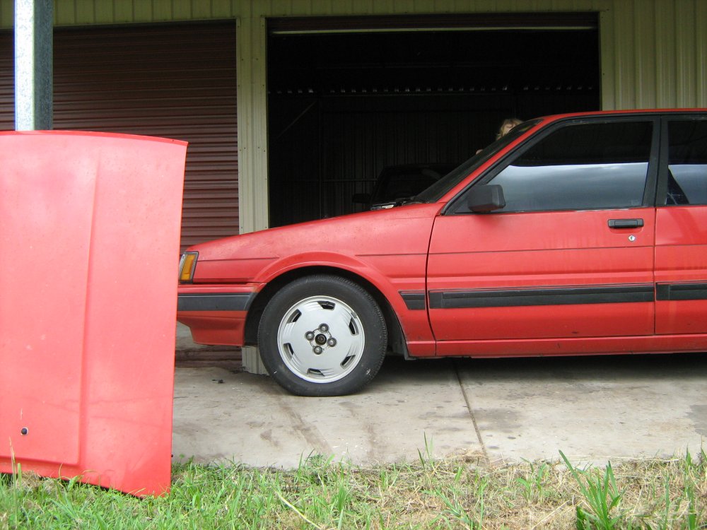

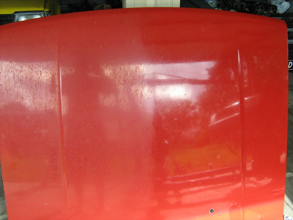

Did a bit of cleaning today including a polish comparison on the bonnet.
It was just washed and dried, I then did the right hand side with polyglaze diamond finish but it needs a good cut:

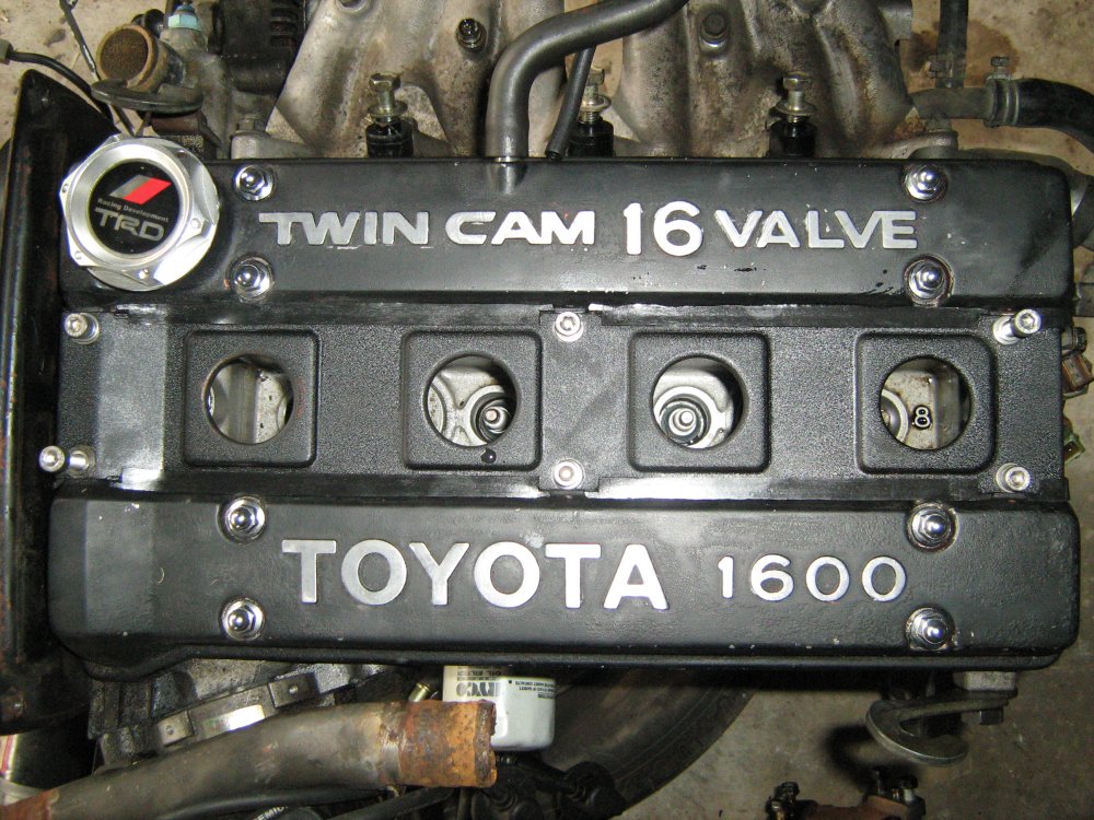

I Took my plain black cam covers from another engine and rubbed the lettering back to bare metal, Its just a quick look at what it will look like but once the cam covers have been cleaned back to bare and repainted with the lettering redone:

May I recommend 'Deox' for your bonnet... brilliant stuff. Cheap too.
Whats that stuff as i need to do the whole car?
Its just a polish... but its fantastic at restoring slightly 'abused' paint. Its a very mild cut and it works best with a rotary buff if you can get your hands on one. I use it for professional details on everything from Hiluxes to Beemers.
Ok i will see if i can find some, My brother is a qualified panel beater and even works in a body shop, Do you think i ever get any body work done from him or do you think after asking him for the lsat 2 years to borrow a proper buff that i have got one yet, NO, I brought one of those orbital polishers a while back but they arent the best so i just use the good old faithful hand.

Down To The Rivets:
ha, still life in that clutch. in my 4ac the 1st clutch after buying the car, the rivets were actually making grooves in the plate. lol, got my moneys worth
