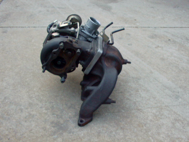

November 25, 200422 yr comment_24719 mines 2.25" using 4 into 1 extractors. Unfortunatly the rear muffler is only a 1.75" so It feels somewhat restrictive. Manifolds, hrmm. Maybe use a 3T-GTEU turbo manifold. should allow for a bit more freedom. Report
November 25, 200422 yr Author comment_24722 that's impossible to get here in norway.. is it possible for you to source one and send it to me? can you give me a hint for the price for the exhaust manifold? but does not the turbo manifold point up? or what? Report
