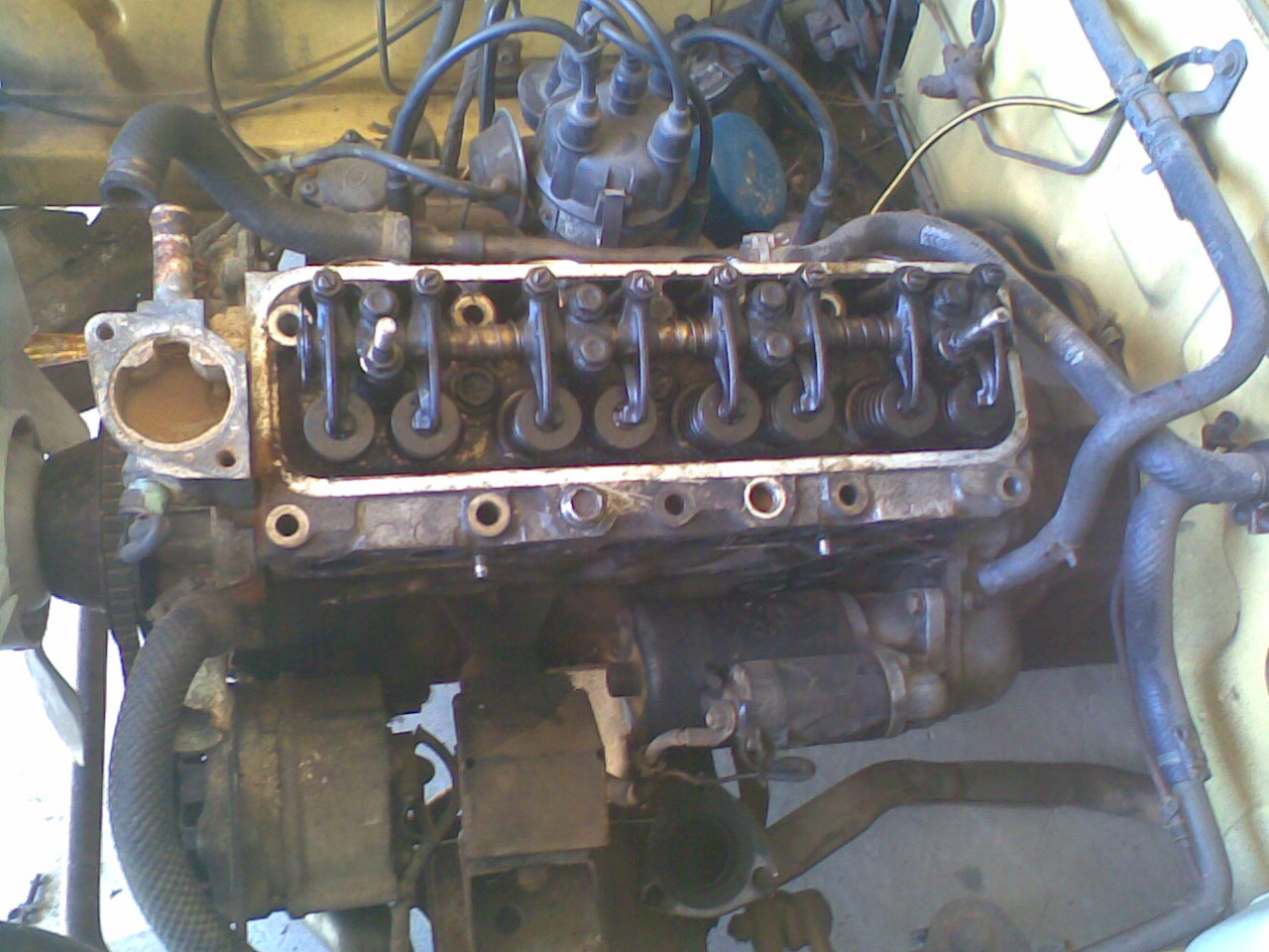

ok well manifolds off finally needed longer extension. but i can lift the the head of now i have tried screw drivers and thing it wont lift of any other ideas.ive put a picture up just to help yas see if i havent undone anthing I'm pretty sure i have.
cheers bayden
cause its just a drift beast only for track and burnouts as its defected but I'm reapairing everything and going to spray it and shit.
also does anyone in sa have a set of extractors they don't need ? and want to get rid or really cheap ?

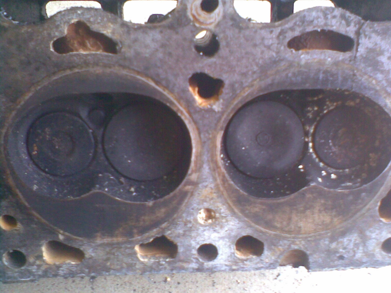

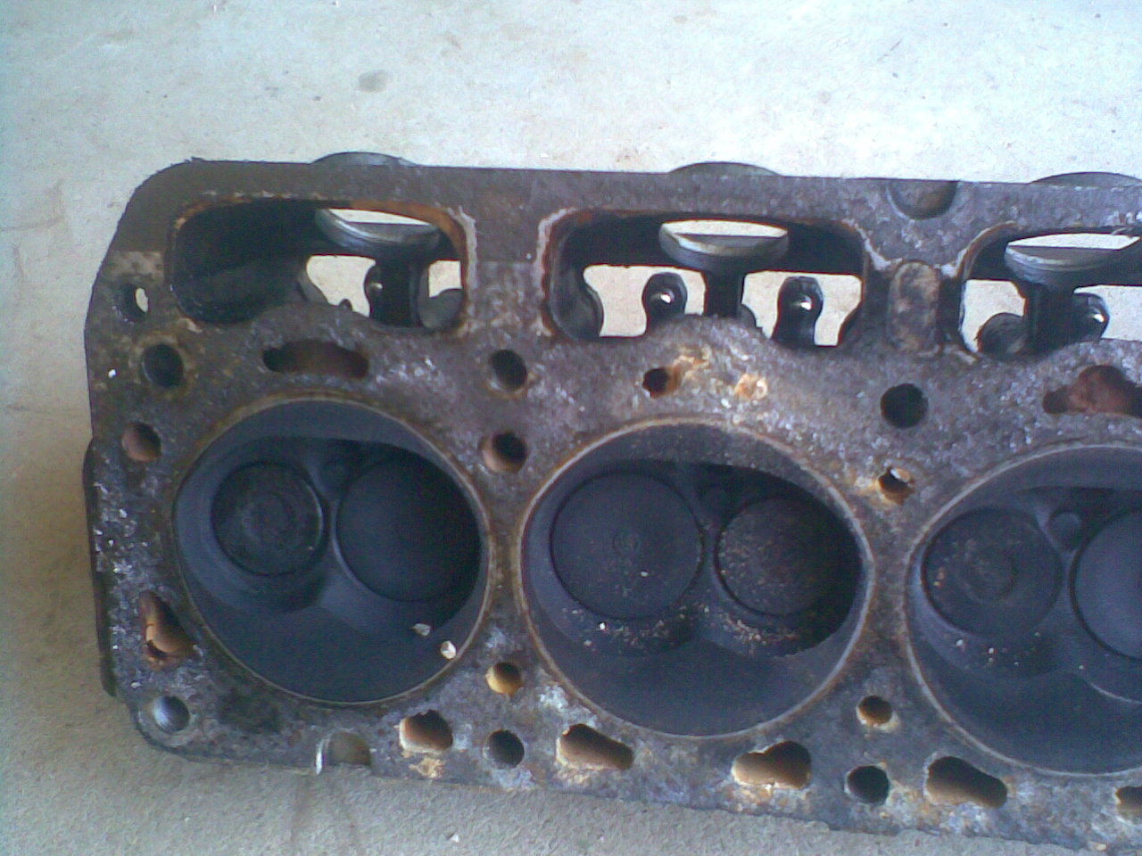

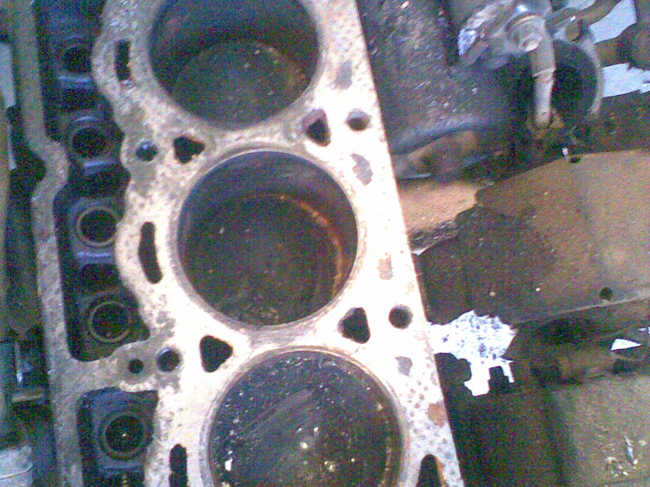

redwarf thatnkyou thankyou thankyou lol completly didnt c it at all ll !!!!!!! its of now i scraped the head and the block off the head is a little bummpy not 100% smotth and a little coroded.
Now a question can i know soak the head in grease and oil remover spray ???????????/
