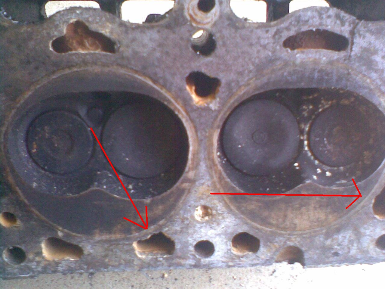

Take note of water Galleries pointed out in red they look to be getting close to where the head gasket is sealing.

Did you know That if corrosion inhibitor is mixed to weak it will cause more corrosion than using just water.
ok well yes now i look at it like that it is fer bad
certainly did!
