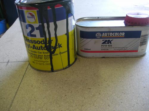

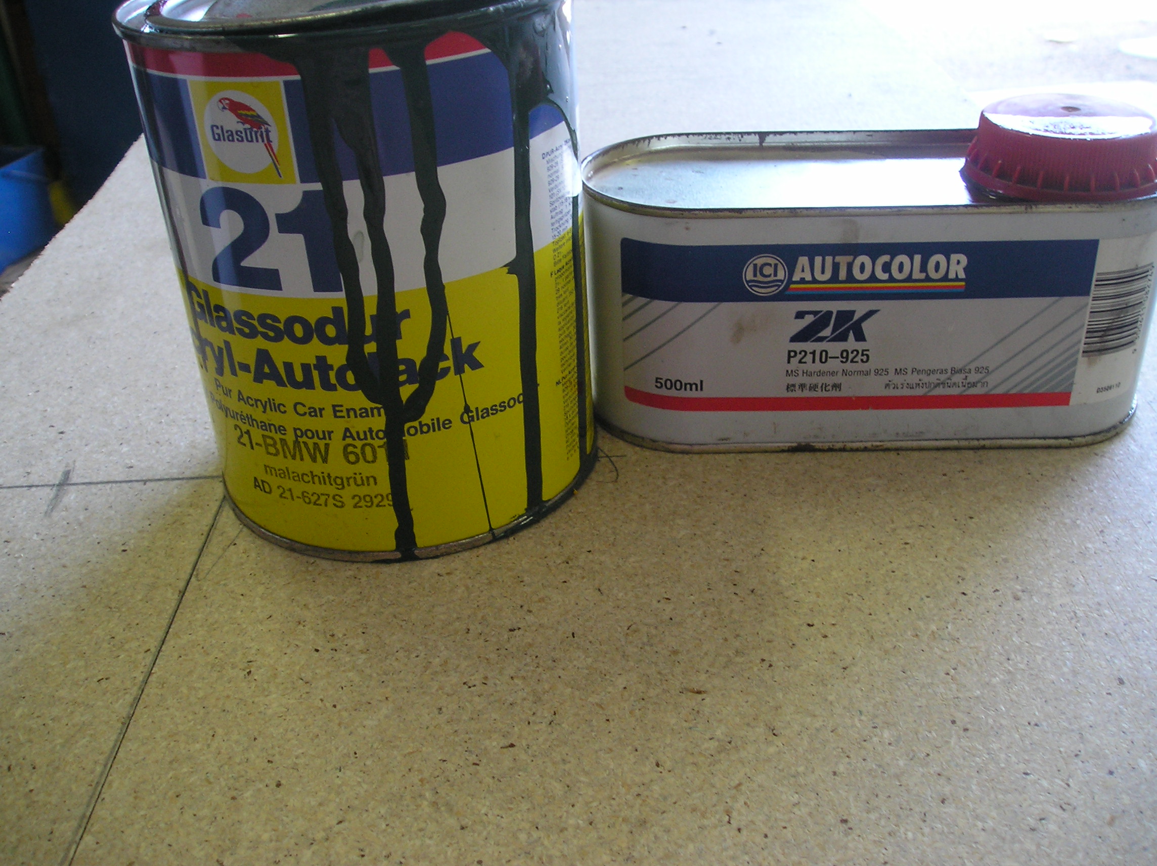

December 31, 200718 yr Author comment_217446 Its definately fish eyes which is mostly caused by silicone, oil & water, It can also be caused from leaving wax and grease remover on too long, I don't know why its coming out a few hours later but i did a paint job where it came out when we finished the car (paint place was selling thinned paint and we werent aware so my mate mixed it up with thinners, It still had a good consistency), Do you have a water seperator on the compressor? Thats all i can say as its not my field, Good luck. I have a water separator at the compressor then another at the airline with a regulator on that one. then a drip leg on the compressor its self. Report

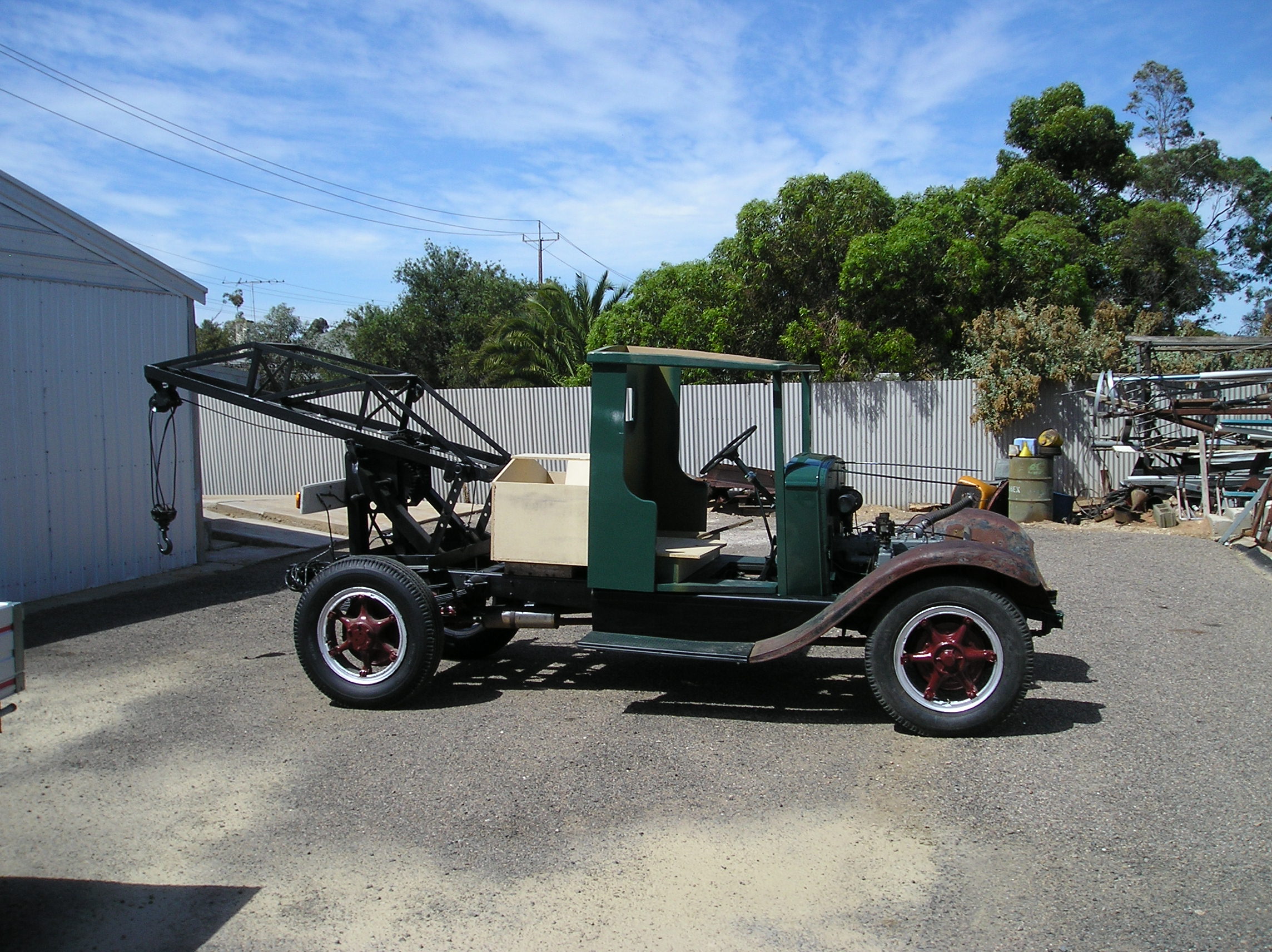

December 31, 200718 yr Author comment_217447 The old man had a look and recons its silicone contamination. Could possibly be from the car being polished with a silicone based product before, A rag you used to clean it had silicone on it or someone that was in contact with silicone touched it. He recons to Rub out as much of the defects as possible use some 800 grit sandpaper, then 2000 grit & prepsol (Wax and grease remover) to clean it up with a fresh rag. He said it would be OK to paint straight back over the top as it is fresh paint.. (No need to re-prime it).. Thanks For that, I have seen silicon contamination with Acrylic paint it happens straight away, it also seems to pool at the edges with acrylic, Does two pack happen later? the vehicle is a 1933 international tow truck I don't think they had silicon polish back then. it must be my prepsol rag. or the products here is the products i used, Report

March 28, 200917 yr Author comment_332021 at work had a bar with pin holes all through it, i had prepared it previous to paint and it felt fine. ended up the pin holes were in the bog, now i had primed it and rubbed it all and it seriously felt like every other bar i had done. so if it is occuring over where there is maybe bog or something alike that could be the answer. to solve it i sanded it all back with 800 and then ran bog over where the pin holes were and you can tell if it pin holes if any of the bog goes into the holes, if not then it probs something else. id go with sillicon or wax or something alike. I found out the paint was just rubbish I ended up spraying my car trailer with it to use it up. This Car I am rebuilding now a 1927 Hudson. I will Probably go back to using Acrylic, I will buy all new products from crash supplies to rule out contamination. Congratulations On the Apprenticeship!! Report
