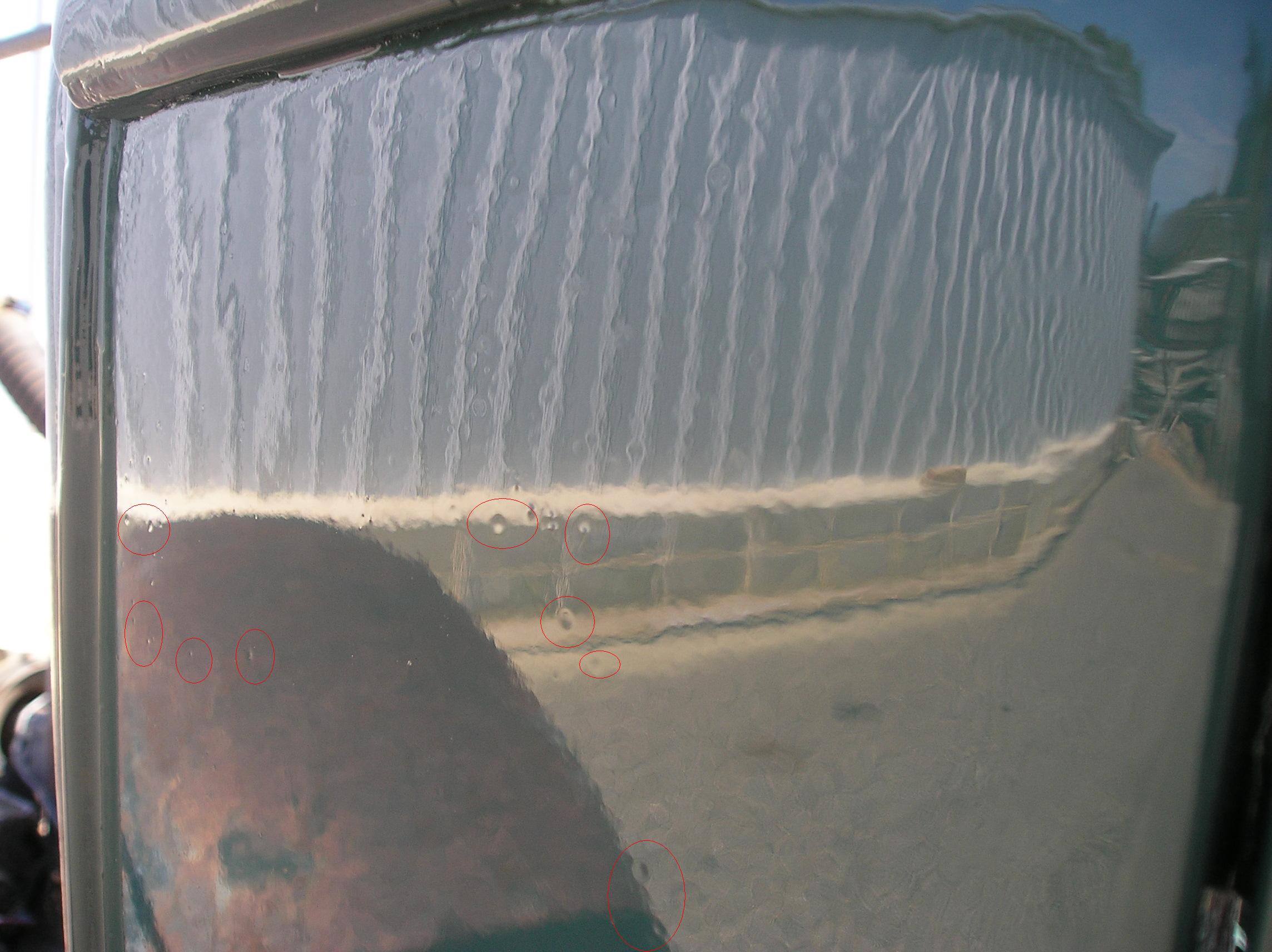

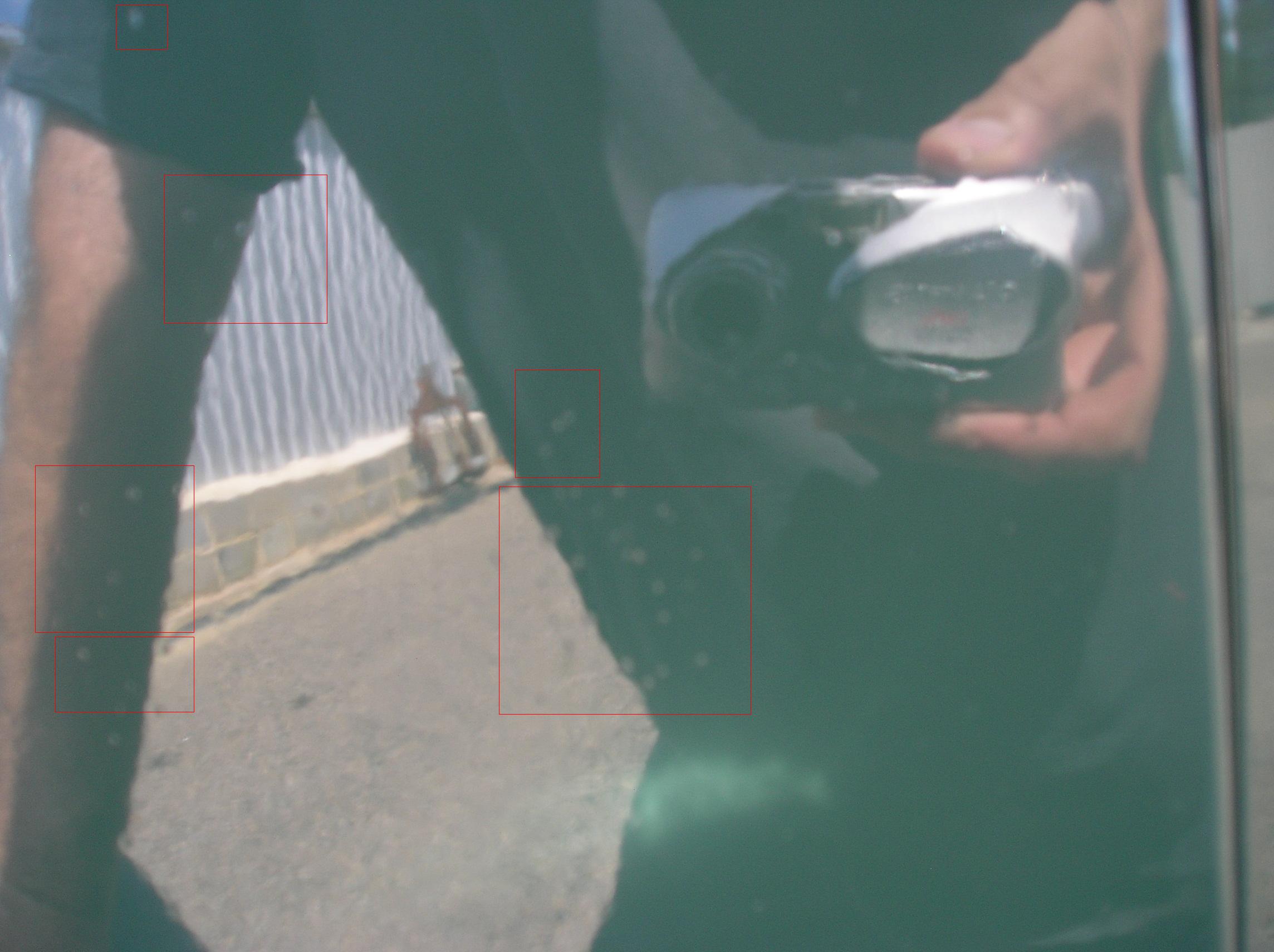

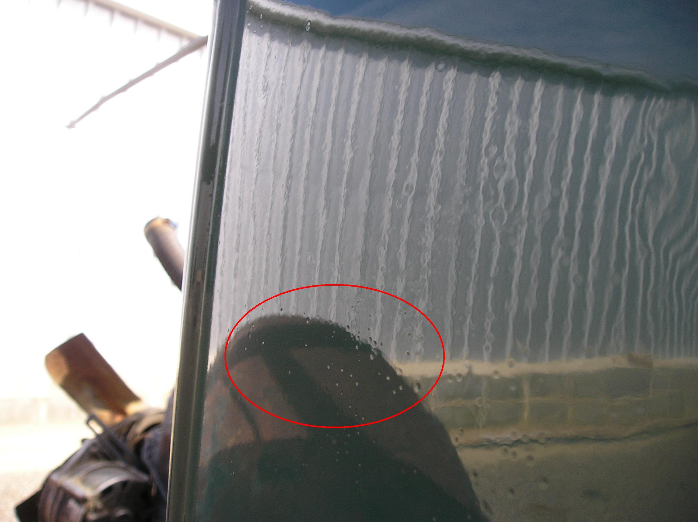

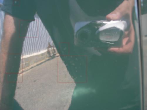

here are some pics mostly of the reflection I found it near imposable to get good pics.
Its definately fish eyes which is mostly caused by silicone, oil & water, It can also be caused from leaving wax and grease remover on too long, I don't know why its coming out a few hours later but i did a paint job where it came out when we finished the car (paint place was selling thinned paint and we werent aware so my mate mixed it up with thinners, It still had a good consistency), Do you have a water seperator on the compressor?
Thats all i can say as its not my field, Good luck.
The old man had a look and recons its silicone contamination. Could possibly be from the car being polished with a silicone based product before, A rag you used to clean it had silicone on it or someone that was in contact with silicone touched it.
He recons to Rub out as much of the defects as possible
use some 800 grit sandpaper, then 2000 grit & prepsol (Wax and grease remover) to clean it up with a fresh rag.
He said it would be OK to paint straight back over the top as it is fresh paint.. (No need to re-prime it)..
