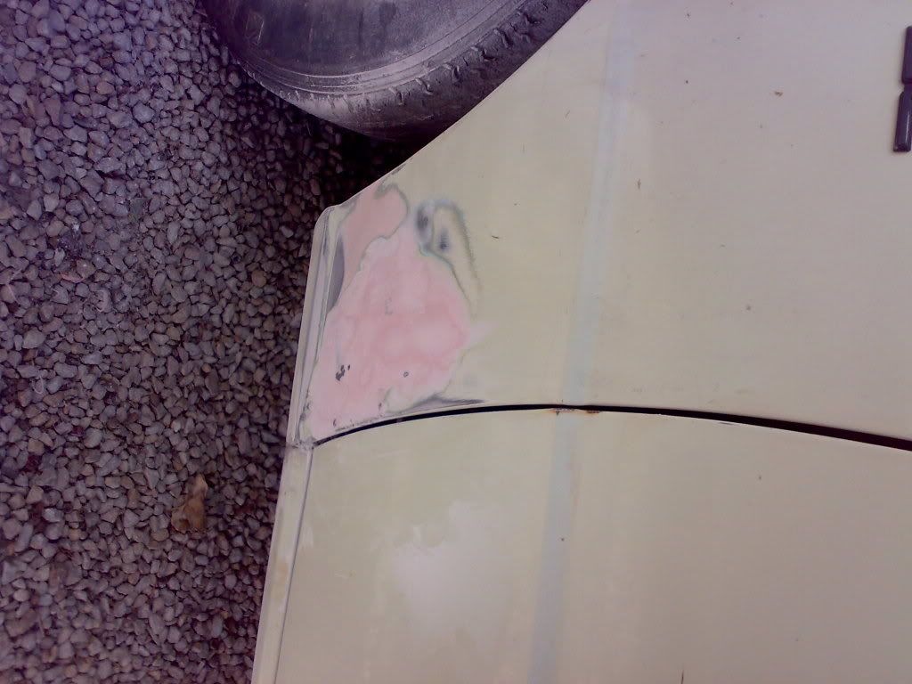

Any pics of the rust repairs fella? :hmm:
cheers phatke30!
Lol, yea. Keep in mind this is the first time I've ever done this so, my jobs not %100. I rubbed back a little bit too much in places, but meh.
Cheers
http://i269.photobucket.com/albums/jj48/ja...27012008271.jpg
http://i269.photobucket.com/albums/jj48/ja...26012008268.jpg
Edit: And the guard I showed you needs a bit more rubbing. So yeh. The other sides the same. All the same places minus the fuel cap.

wow. good job hey.
I'm impressed =]
keep us posted!
are you adding metal,welding or just bogging over it?
Rust converter, cutting out old rust (like big bits) Sanding back, using wire + bog. On the bigger holes,
like this, http://i269.photobucket.com/albums/jj48/ja...24012008246.jpg
Same as above, but fibre-glassed from the inside, then the outside, and then bogged over the top and sanded back.
Would have cut out the metal and welded in, but the cars only a temp.
Cheers
