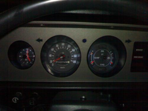

I did have pictures up but i dunno where they went.....I found the blue ones i bought not bright enough, now i have white ones in the dash and its nice and easy to read.

The needles will just pull off, just remember to have them facing 0 when you pull them off.
As for how i did them, its all in the thread.....Paint everything white, then use cigarette filters to dab the black paint on the raised numbers.

and to xany, excuse my ignorance they are on your page haha, and one last question, if you had blue leds and white gauge faces why was it green?? was it because of those little bulb covers??, can i take them off if so??
