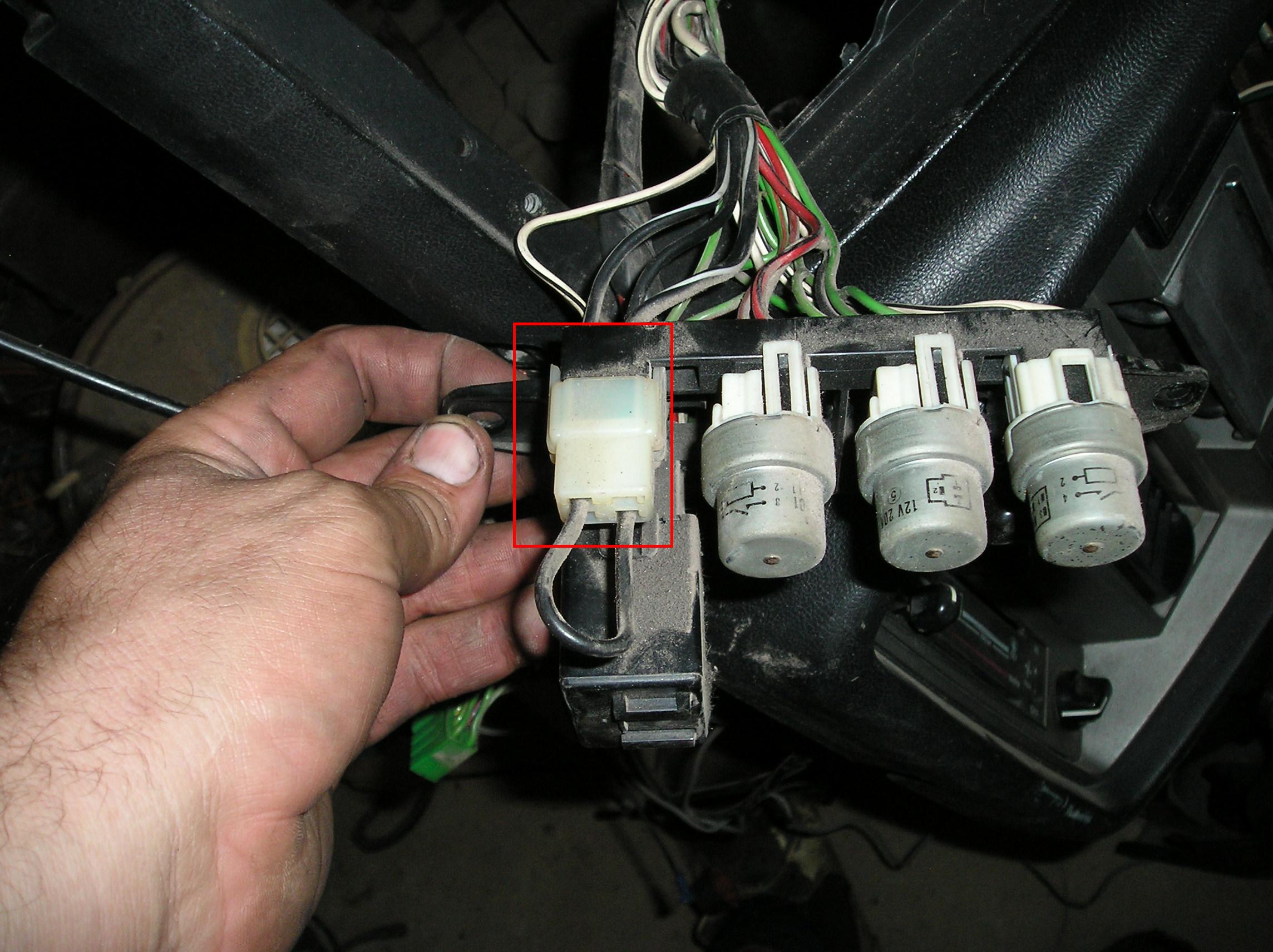

KE30_KE35_KE55 Posted April 24, 2008 Report Share Posted April 24, 2008 On a ke30 You will find a relay board behind the drivers side kick board take the 4 pin auto loom plug out and replace with a manual link as shown, I would suggest ke70 would be similar, Hope it helps, Darren Quote Link to comment Share on other sites More sharing options...
