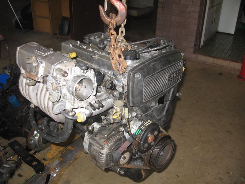

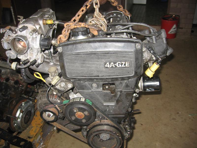

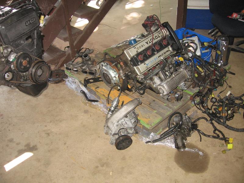

so heres my 4agze going to be turbo

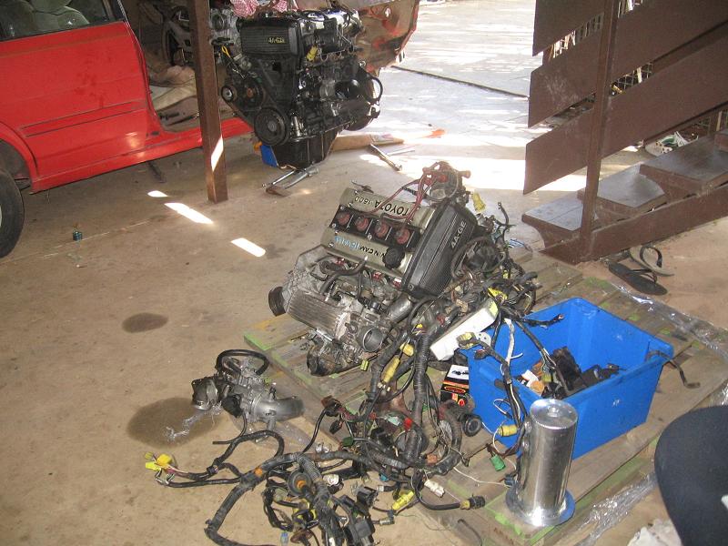

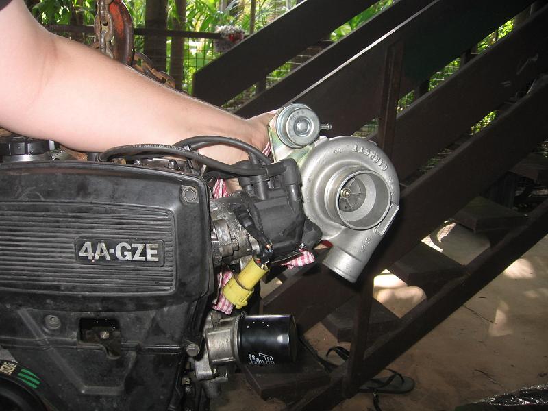

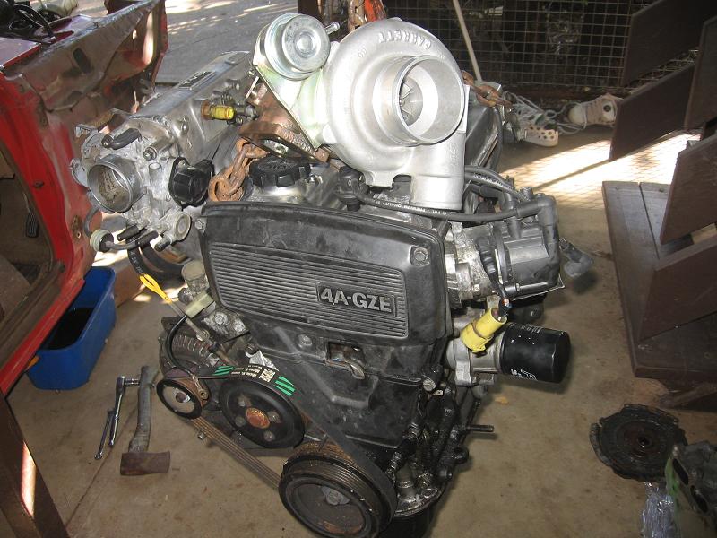

this is the baby i'll be throwing on it

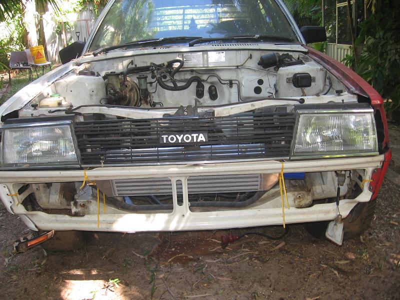

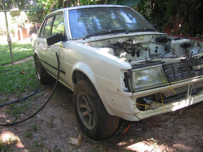

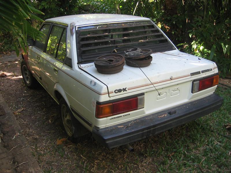

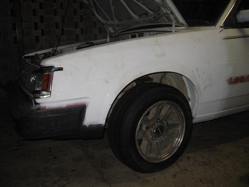

the car out the back ATM because I’m striping a ae71 that had small front end damage parts will be for sale soon
also i got a set of t18 drums to put on the t18 diff thats in the shed

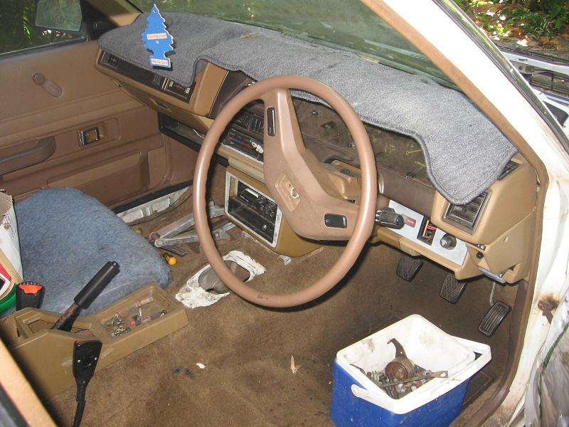

the insides are fairly tidy although my car is also my shed for inside car parts ahahah
not the best insides but I don’t really care what it looks like just how it goes

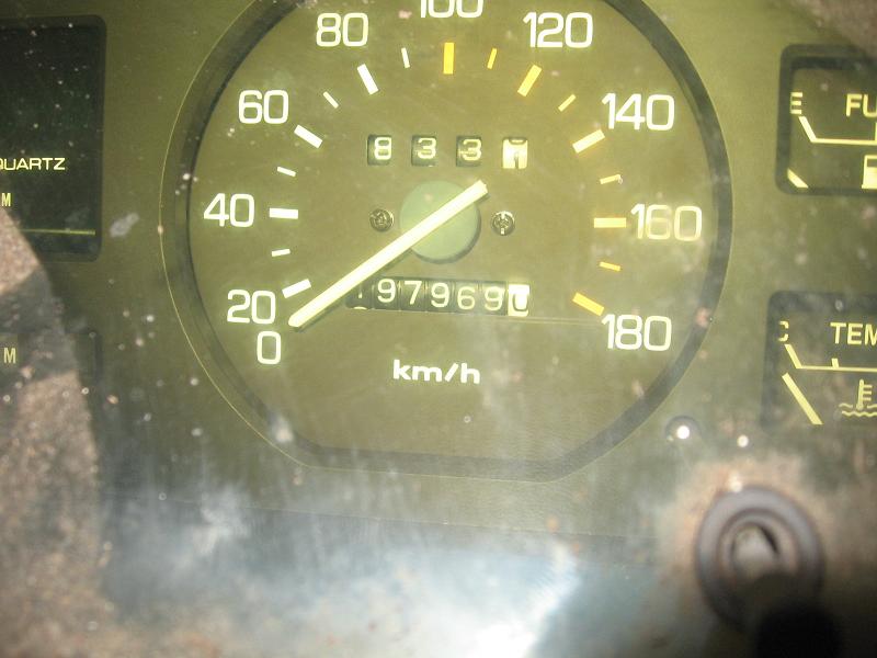

got a few ks on it but its the lowest one i've ever seen in darwin

Is that a T2 off an ET/EXA? If so it gunna be too small for a 4age!!! It'l be responsive as hell with no lag and heaps of torque, but you'll stuggle to make decent top end power. ;)
Get atleast a t25 or t28 for it. They have the same T2 inlet flanges, but a different dump flange. But once you have these flnages, there is HEAPS of bolt in future upgrades in the Garret GT25 and GT28 families. :lolcry:
nah mate its a disco potato or GT28rs 350hp moddle
.70 ar on the front
.64 rear
Edited by ae174agze

yeah i know i took a look at that pic and, hrmmm that does look small but when its real life that turbo looks huge

the engine that’s in the pics is pretty much smegged
i did a comp test on the engine
and got
about 140, 90, 49 and 130
a wet test produced about 5-10 psi rise on all cyl's
and i'd say the valve stem seals are rooted as well when i look up the exhaust side of the engine, i can see the stem of the valve all dark like its covered in oil
generally that makes a big white puff of oil smoke when you start your car,
so looks like its smegged and in need for a turbo rebuild
waited so long for this engine and it arrives smegged ahahahah
not a good start
:bash: :y:

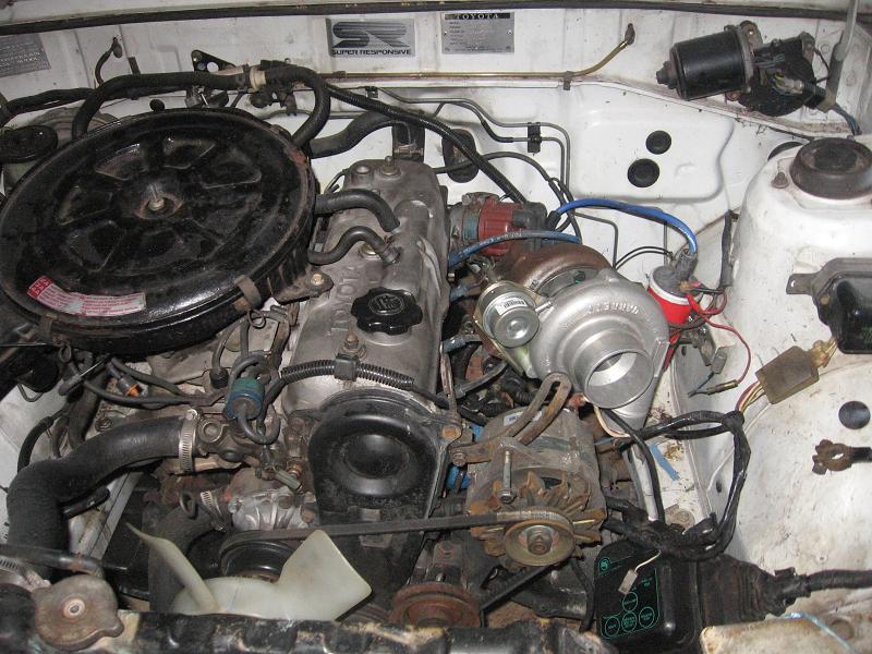

turbo 4ac HA HAAA I wish
