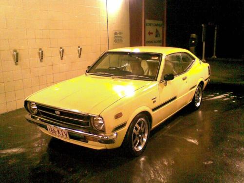

dude those wheels look exceptional :P
just keep washing it and it will look shiney at all times

are those wheels the ones off millers old ke35?
looks good man, hope you go through with your plans
i got sick of my 35, and decieded to get something different
they are the wheels off miller's ke35... bought them off ChrisGT when he upgraded his wheels
i'm personally a massive fan - they look mad on this car

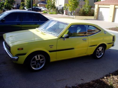

this will make a tidy little project most 35's that i have looked at are full of rust, this one looks quiet tidy. I look forward to watching the progress.
the body is a bit rougher than i'd like, but cleaning it up is next on the list after getting the drivetrain upgraded
alternately, if anyone has a clean ke35 or ke55 hardtop shell that the want to part with, let me know :yak:

Nice ride
should go hard when your done. be good to see & hear it finished.
alternately, if anyone has a clean ke35 or ke55 hardtop shell that the want to part with, let me know :y:

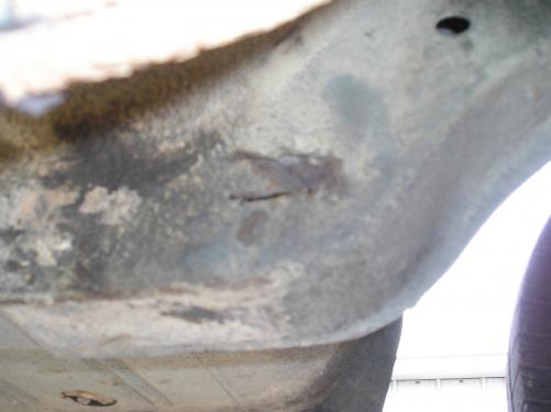

I have been looking for a immaculate hardtop / hardtop shell for 2 years, they seem to rust unless dry stored, look at the front chassis rails if they are OK you are normally on a winner.
