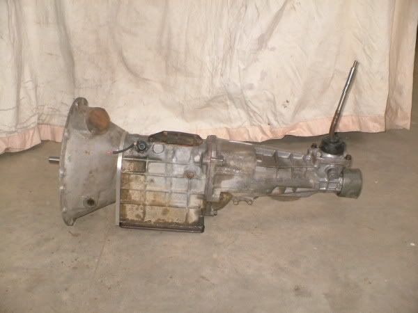

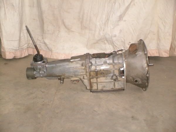

Toyota T50 Trans Id ?
Hi from Ireland..
Any idea what this t50 ? is from ...year/model/engine-size
(disregard bellhsg/adaptor ! )
Celica ta22 looks different..
Thanks for any info.
doesnt look like a t50 to me
Hi
Only got pics..
Some k50 have integral bellhsg ?
Its a t series MG bellhsg in the pic..!
The t50 ratios are quite close to MG just with overdrive 5th
whereas k50 seems lower ,or where they all the same ?
Edited by airnwater
Eww!!
That is most definately a K50 from a ke70 as Irokin said. Identifiable by the shifter position, and also they way the cross member bolts on.
BUT ITS HAD THE INTERGRATED BH CUT OFF!!! Can see where they've cut through the clutch fork hole. Used an adapter plate of some sort (shiny strip), which I would hope is mounted a little bit better than just the 4 bolts that hold the guide for the TOB retainer! :dance:
Wtf, the bellhousing is wafer thin too, look at the edges on the side view. Does it def bolt up to a 4A? Must be some freaks idea to get an engine conversion in easy.

Thanks for ID info.
Have compared with uncut k50 pic ...can see what you mean..
Its a standard T series MG bellhsg
Are gear ratios same in all ke70 k50s ?
