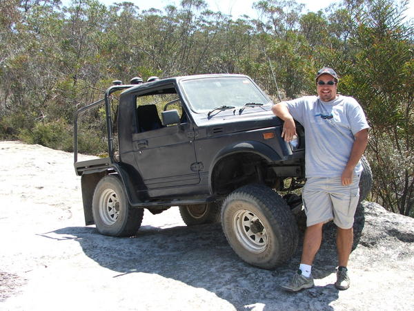

Here is some pics of my zze122 rolla thats gone and my 4k-c sierra, enjoy

I bought the zook with the engine conversion already done and engineered.
From my experience within the suzuki 4wd club a 4k conversion was the gun thing to do with early 1 litre sierras and the earlier suzuki LJ's untill the 1.3 sierras and the vitara 1.6 engine came along.
The 4kc I have was out of a ke70 with the t-50 5 speed box. Obviously new chasis mounting points need to be made up for the engine and gearbox, because I have the later gearbox the gear shifter hole was moved back a little (although I think the earlier boxes with a more forward mounted shifter may not need this) and the slip yoke out of the box remains but goes to a single uni and the standard transferr case input flange (its a tight fitt cause the box is a bit longer) and my transferr case was moved forward about 1 inch. The clutch cable i replaced recently came from a 1 litre sierra and fitts well as a 1.3 sierra cable is 2 inches too long.
Oh and to make the car run on angles offroad throw the corolla carby out the window and get yourself a sierra 1.3 carby. its an aisin carby like the rolla one, the throttle cable goes straight onto it and it is a straight bolt in onto the corolla manifold. I reckon this is necessary as any little step offroad makes the rolla carby cough and splutter, Once I tore 2 transferr case mounts trying to keep it from stalling by keeping the revs up and bouncing it a bit much. the next week went back with the sierra carb and idled straight up easily.
Everything else on my car is all suzuki sierra, it did start life as a 1 litre narrow track hardtop but has been chopped into a ute with a spring over diff conversion, 31 inch tires (standard is 26) and wide track (4 inches wider) diffs and transferr case off a later model 1.3, oh and the later plastic 1.3 grille :S :D
