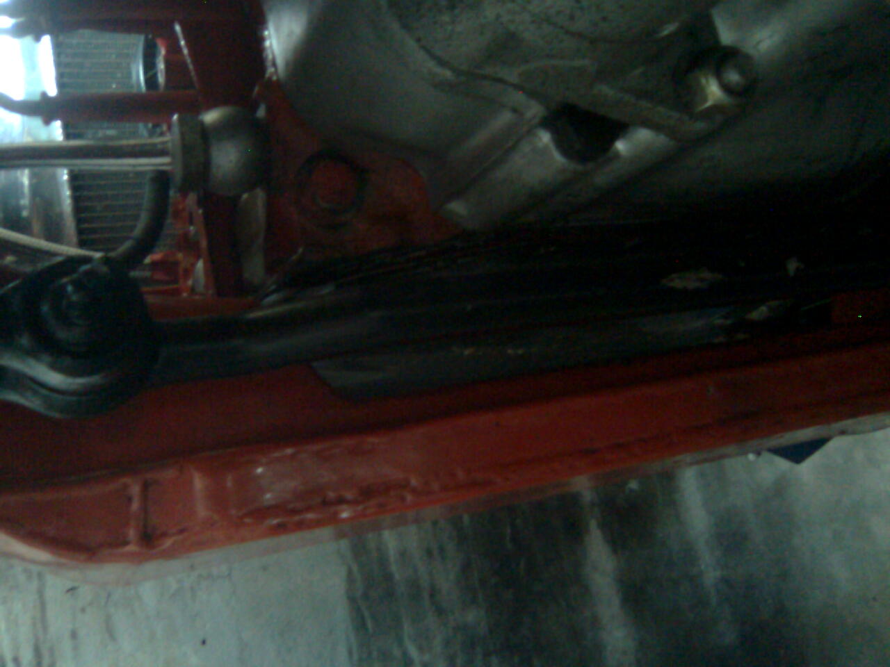

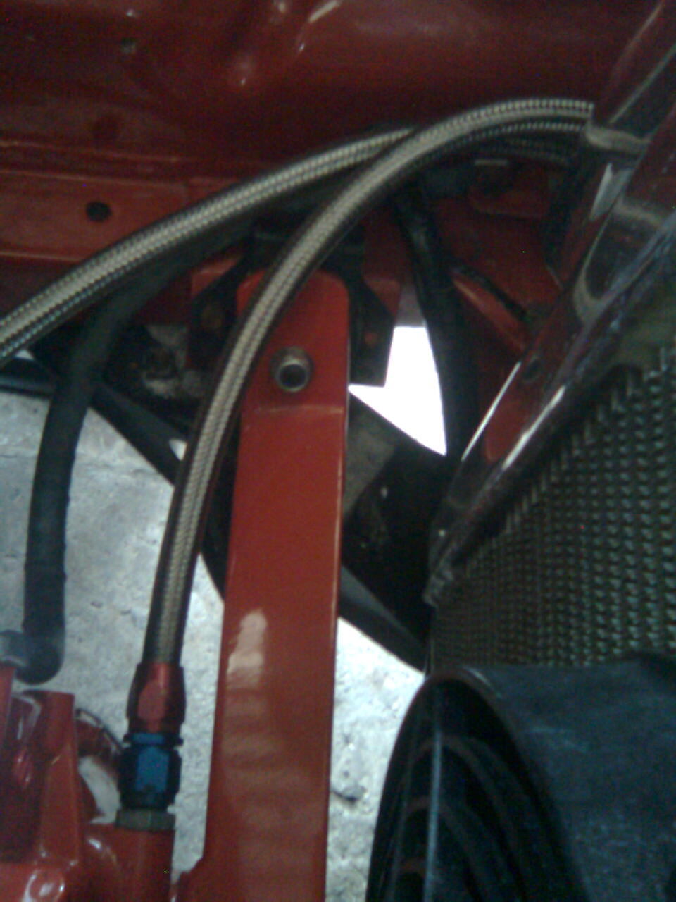

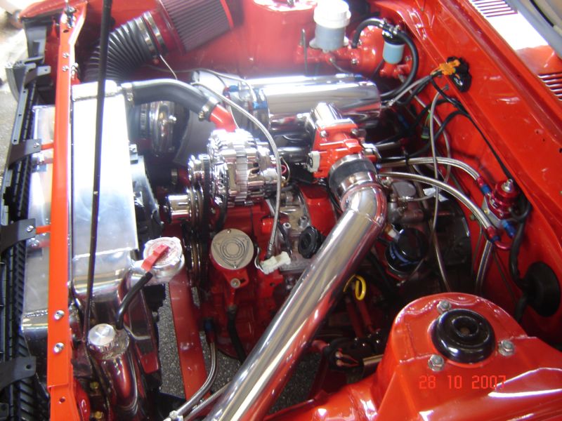

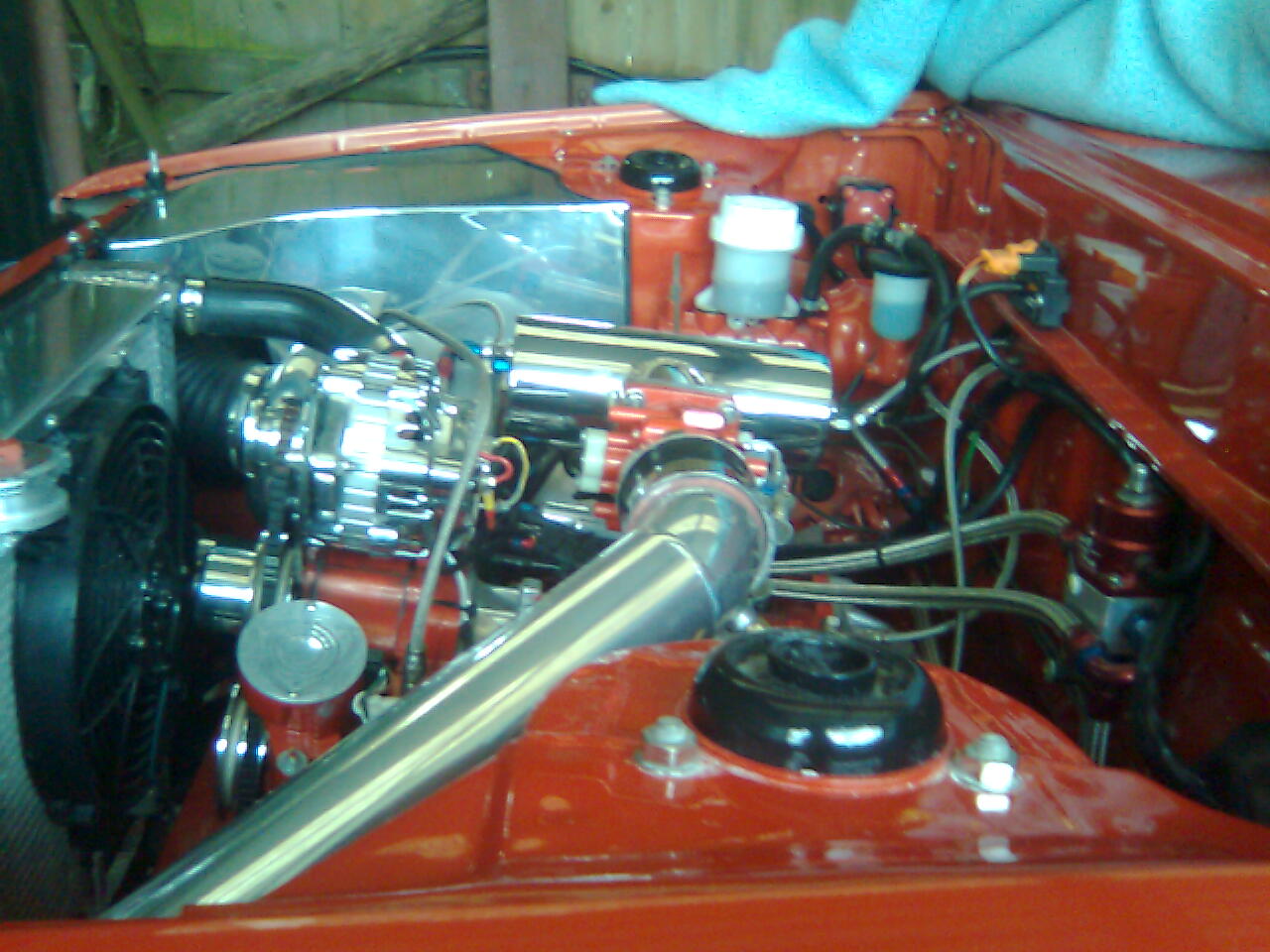

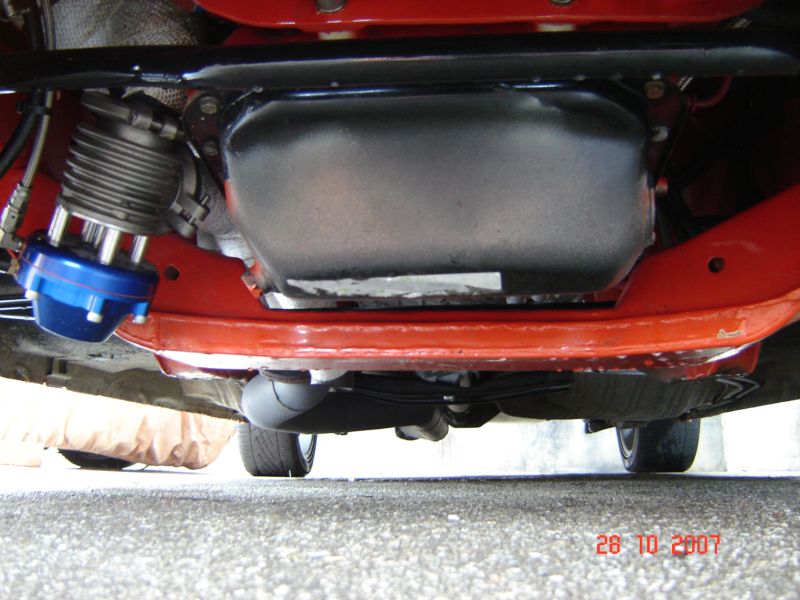

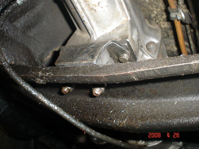

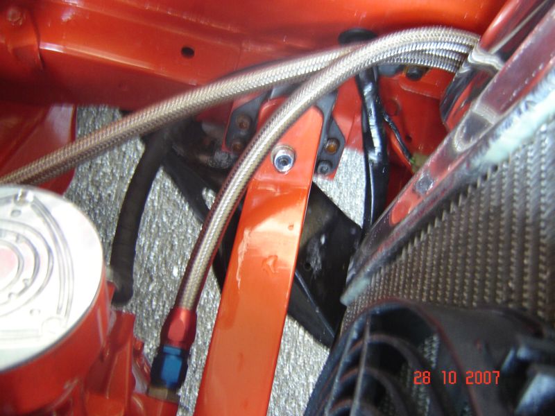

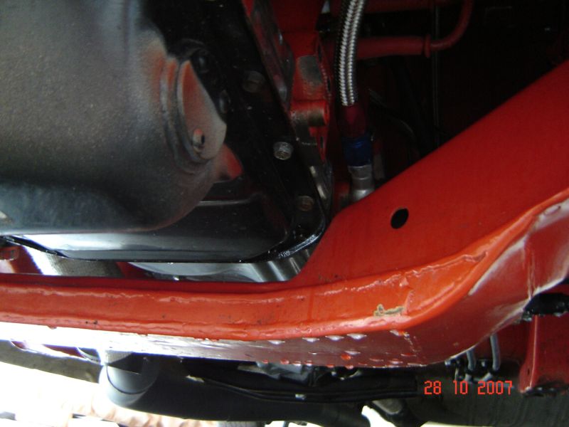

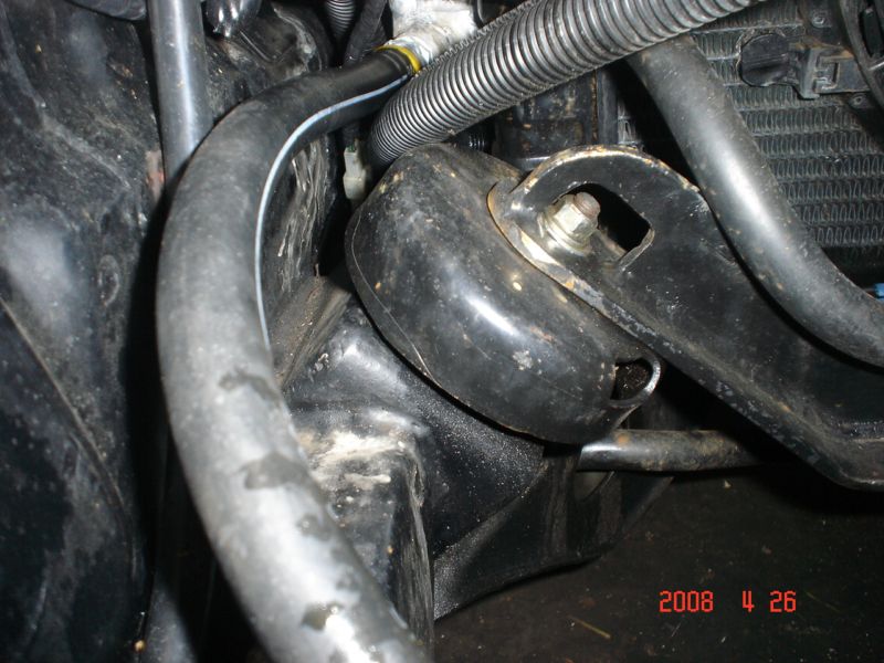

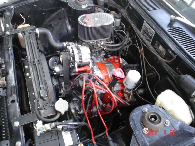

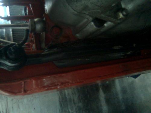

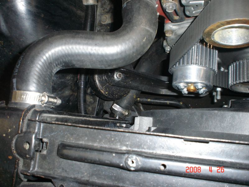

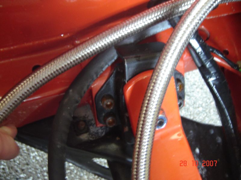

September 10, 200818 yr comment_273945 hey guys/girlsI'm new to the corolla forum so i don't no if there is already a thread up here about this and if there is could some one point me in the rite spot to find it I'm sure someone or many people have done it. i have a 12a with 5speed seires 4/5 box that I'm about to slot in my ke30 can any one tell me if it will fit or do i have to mod my gearbox tunnel? and also any hidden extras i might of forgotten about i have built a few custom cars before so I'm not scared to chop stuff out i would just like to no first any help would be great thanks Steve I have mine in the shop at the moment for this conversion. 12a N/A - Series 5 Turbo Box Definately will need the tunnel raised. Custom engine mounting blocks on the front chassis rails Custom front mount plate on the engine Custom Gearbox Cross Member Custom Extractors and exhaust Relocate the heater / go aftermarket Upgraded diff would be a very good idea (I have a shortened R31 Skyline LSD) The list goes on, but you get the idea. The pics are from a NZ blokes setup, and are similar to what my engineer approved. Report

September 11, 200818 yr comment_274116 Allow me to share some of your pics that I found somewhere..... Edited September 11, 200818 yr by kangaroosa Report
