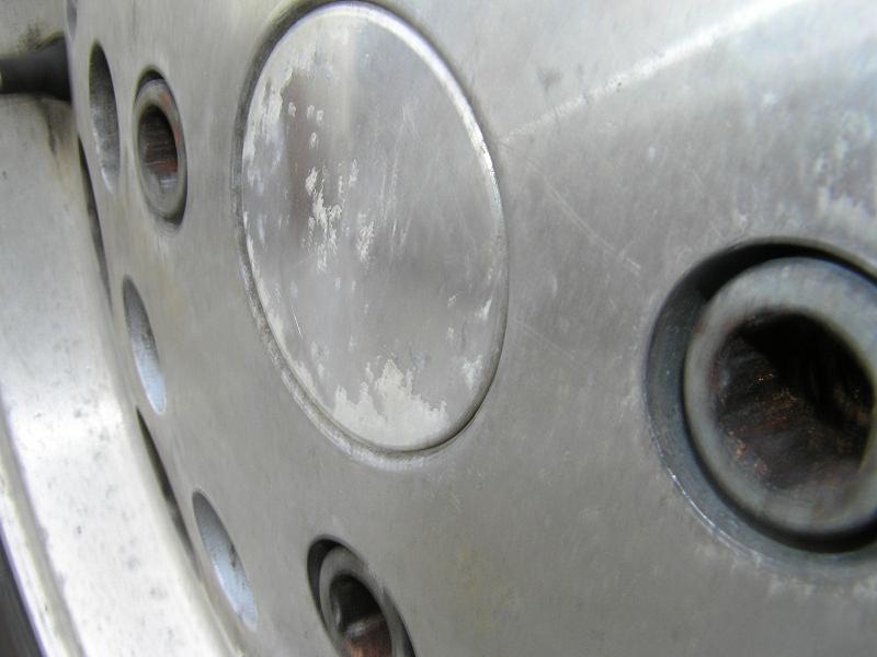

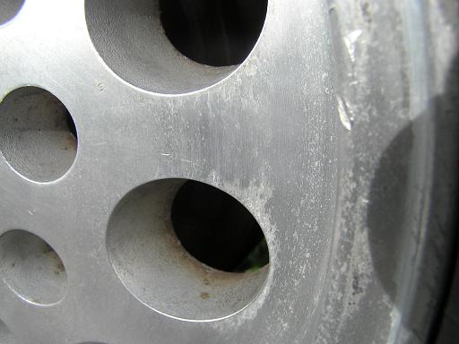

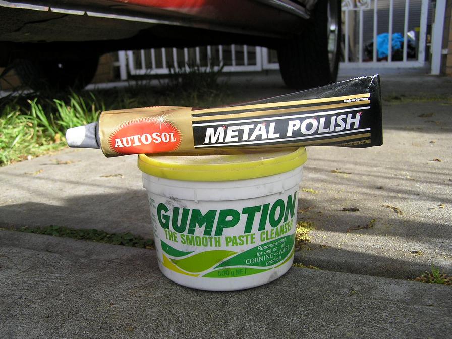

September 30, 200818 yr comment_278261 I have some Sigma GSR rims on my rolla. They are not so shiney anymore. I got told by a couple of people to use "Autosol" I have used this, it works well, but it is not agresive enough, as my wheels are too dirty. It has this "Crud" on it and it is a #@!^ to get off! I tried using steel wool and "gumption" and still going to take years to make shiney. Long story short..... What should i use to get this stuff off and make my wheels SHINEY!mmm shiney stuff I will obviously still use autosol at the end to get the shine. Thanks Doug Report

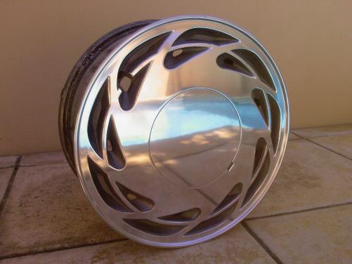

September 30, 200818 yr comment_278275 once youve got the clear coat off, id recomend PURPLE metal polish. its made in the US by California Gold. its available from HY-Way truck accesories on the cnr of South Rd and Grand Junction Road. I'll bring the bottle down friday night and show ya:) Heres a pic of my wheels just after being polished with PURPLE. Ryan LOVES THE SHINEY Edited September 30, 200818 yr by KE25 KID Report

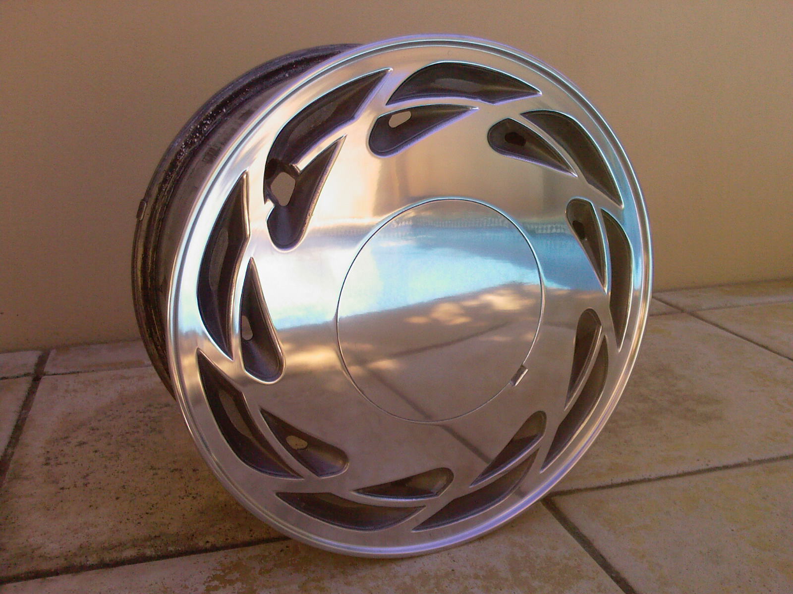

October 8, 200818 yr comment_279971 Head down to your local paint shop they should have metal polishing kits with cloth attachments for your drill, and 2 or 3 different polishing compounds. Then finish with autosol. The drill bit attachments really take a lot of the hard work out of it. Still time consuming though. Here's my before and afters :cool: Report
