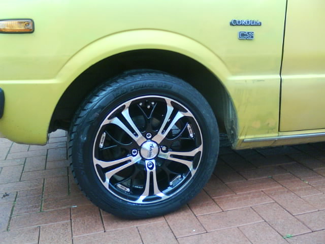

hey mate
i have got bolt on spacers on my rolla
there huge
there really safe ONLY if u use super lock when u put the bolts on and use a torque rench
the only place i could get mine from is wheel works on south rd
280$ for all 4
here is a pic of my rims wid spacers but can't really see them
ps good tip is to paint them black and get black rims

hey mate
there huge
280$ for all 4
hey mate, can u post up a pic showin the side of ur vehicle (from the front looking to the back)
