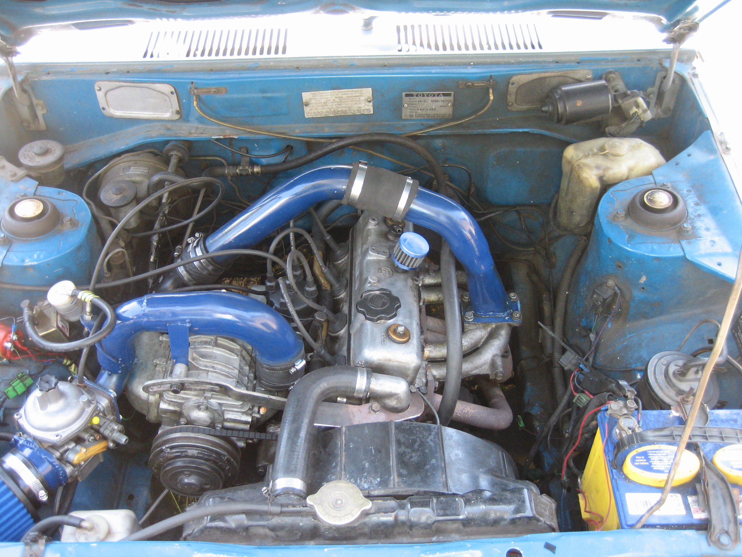

setup was not done by me it was done by local carby place in melb and I'm not to sure on size of su ill try find out for you
ps engine is very dirty lmao
The carby is a Stromberg knockoff of an SU, it was common on the Rovers, Range Rovers and Jags etc. Bit more modern than the SU's .
Probably a 2 Inch, I have one at home off that I would be happy to sell. It was actually on a drawthrough mazda setup.
