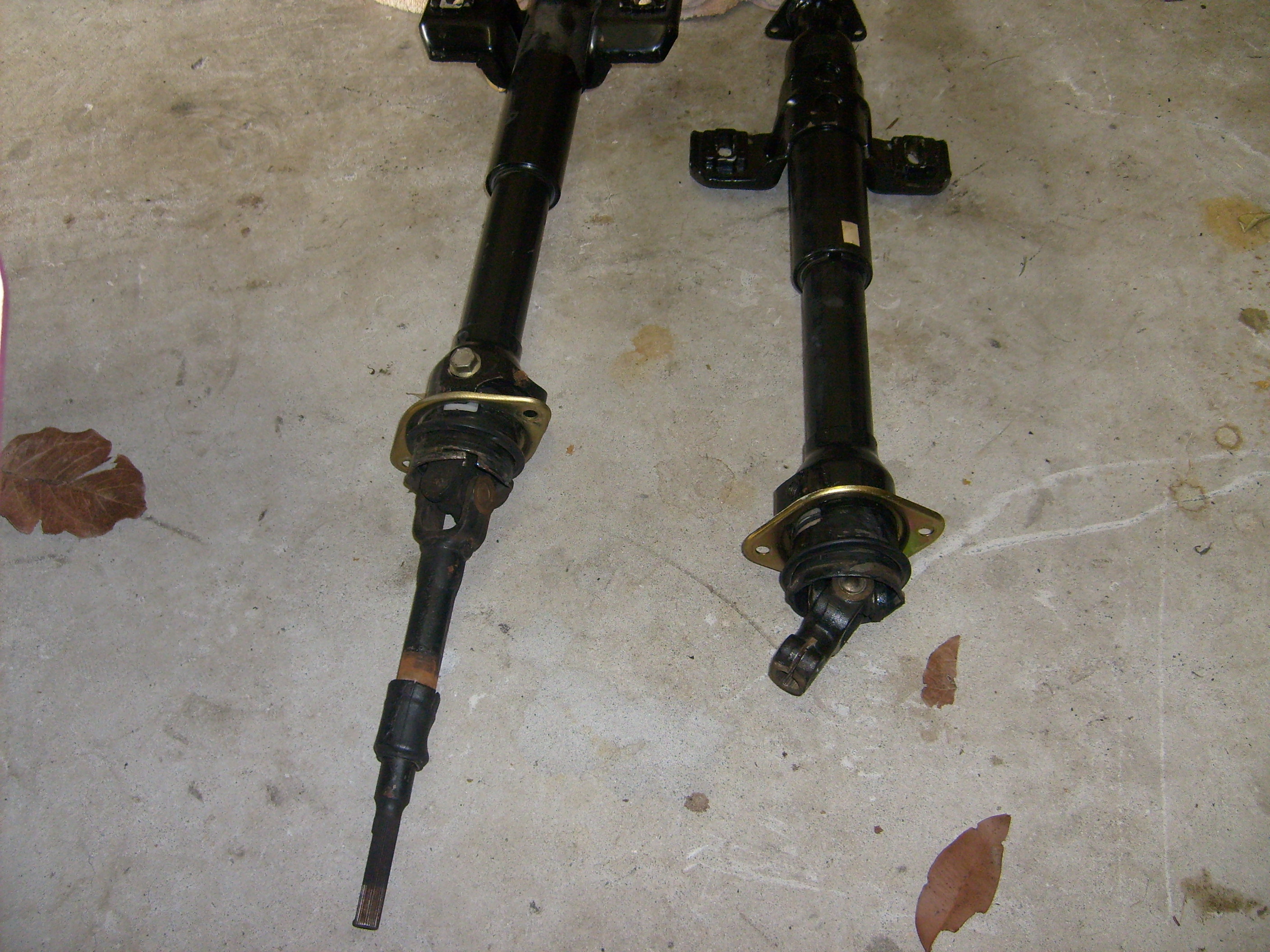

December 4, 200817 yr Author comment_295067 Ok i found out that the ae71 and ke70 steering columns aren't the same (therefore not interchangeable) as i found out after wasting a few hours of my time. At first i was only going to swap the engine bay side of the column over but have found out the ae71 parts are a complete 180 degrees around than the ke70 column (the ae71 unbolt from the top end and ke70 unbolt from both top and bottom end). So i decided to just go and swap the entire column over but the ae71 is about an inch to short. After all the swapping around, i had to go back to what i originally had in there and is still no good for me. So all the people out there wanting to know if it works or not, the answer is No. You've just got to find one thats already made for a 70 instead of trying a 71 one. Edited December 4, 200817 yr by Rola Drifter Report
December 4, 200817 yr Author comment_295070 Here's the different shot of the 2 columns together. Ke70 on the right & Ae71 on the left. But anyway if someone happens to have a flat front ke70 that they are wrecking or what not could you please let me know if you have the part that might help me out. Here's the link to my wtb thread with a picture of what i'm chasing. http://www.rollaclub.com/board/?showtopic=25762 Cheers tom Report
