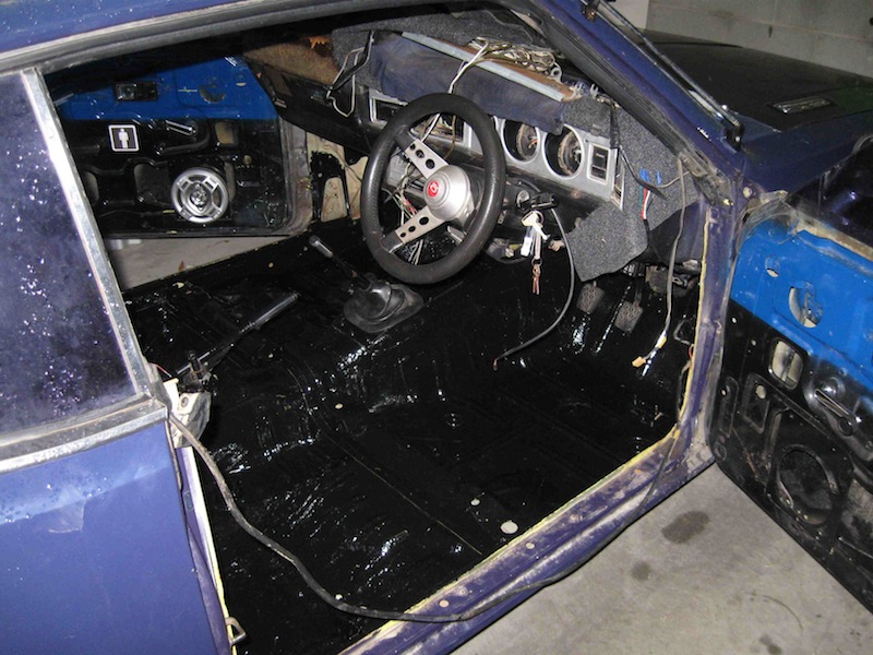

I have completely stripped the interior and removed the sound deadner and old carpets, plus a couple other bits. all up removed bit over 15kg.
Then i went about painting the floors black with killrust topcoat.
